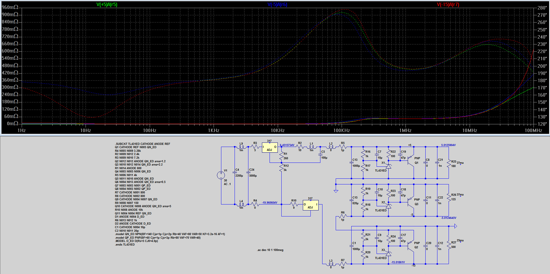

100 meg phase plot
Hi Andrea,
Attached is the phase plot up to 100Meg, but i've changed a few things since the last plot.
C13, C15, C1 - changed to 40 mohm ESR. (10 mohm before)
C21, C22, C12 - reduced to 1nF and set to 6 mohm ESR, and the ESL is at 400pH.
C8, C11, C20 - removed/set to 0 for now.
After 100Meg things get a little pear shaped again. I couldn't find an exact value for the ESL of a C0G/NP0 in a 0603, but if we take into consideration the track inductance as well as the cap inductance we *should* be in the ballpark.
I guess at the end of the day the cap types and values will have to be physically tested to know for sure how it will perform.
Ryan

Hi Ryan,
thanks for the plot.
The extended plot seems fine enough, BTW I would take a look at the final board with a 100 MHz bandwidth scope. Sometimes I got the TL431 ringing above 50 MHz.
I would decrease the current flowing through the TL431 down to 5 mA or less, for lower noise.
Andrea
Hi Andrea,
Thanks for your advice. Reducing the current to ~5mA (from 10mA - max transconductance) through the 431 in the simulation gives about -1.3dBv less noise and lowers output impedance at 100k by 15mΩ - something to play with in practice.
Ill look out for any oscillations.
Thanks 🙂
