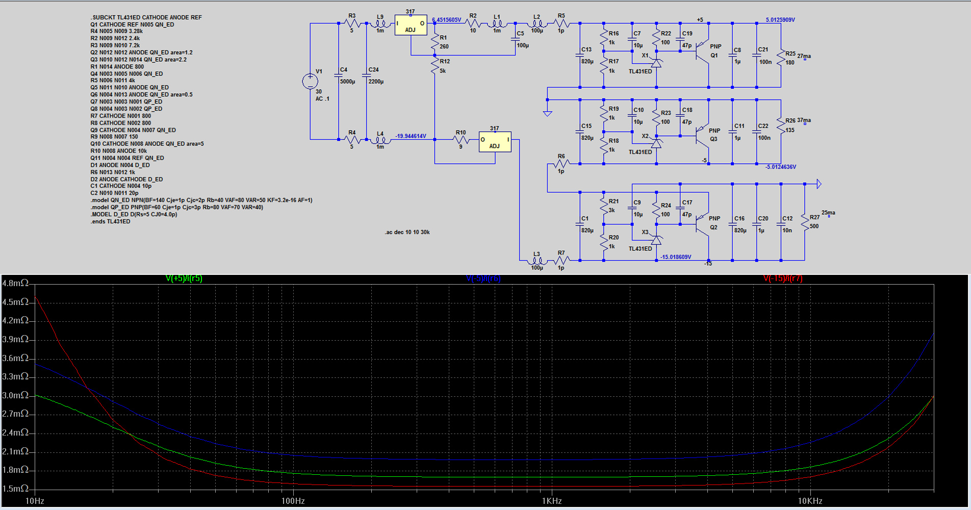

PSU schematics correction.
Thanks for all the comments and input, it's all appreciated and ill take it all in my stride.
Just a small correction in the schematics I posted earlier. The load for -15V represented as R27 in the below schematics should of course be referenced to GND, as should all the caps for this supply.
Image attached - Updated schematics and output impedance graph.
Seems -15V is the best performer in this configuration. All supplies simulate under 3mΩ in the audible frequency range.
I must mention that I have every intention to test everything before it is stamped for approval. I'll base this decision on a comparison against V1 using my current Salas shunt regs, Iancanada FIFO 1 with I2S to PCM converter.

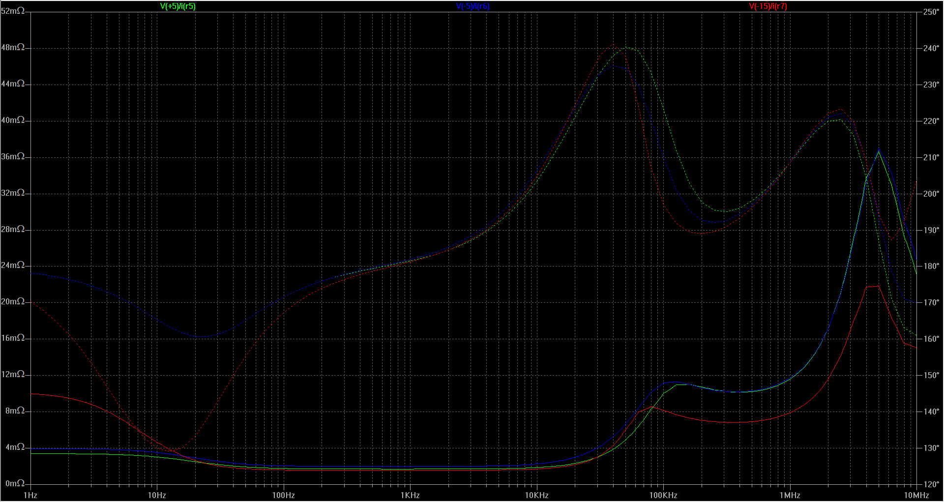

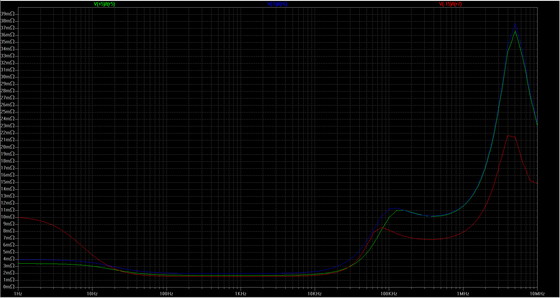

1Hz - 10M Simulation Plot.
Attached is a plot of the z-out for all three supplies from 1hz - 10meg from the most recent schematics update. The simulation includes 100nF MLCC C0G/NP0 and a 1uF Panasonic stacked film. Adjusting these caps has a rather big impact on the performance past 100k. Note that C0G/NP0 are comparable to polystyrene for distortion, temperature stability etc., ESR is single number milliohm.

Ryan,
check the phase slope around 5 MHz, it could ring.

Ryan, R5 and R7 are 1p??? 1 Ohm I guess?:confused:
