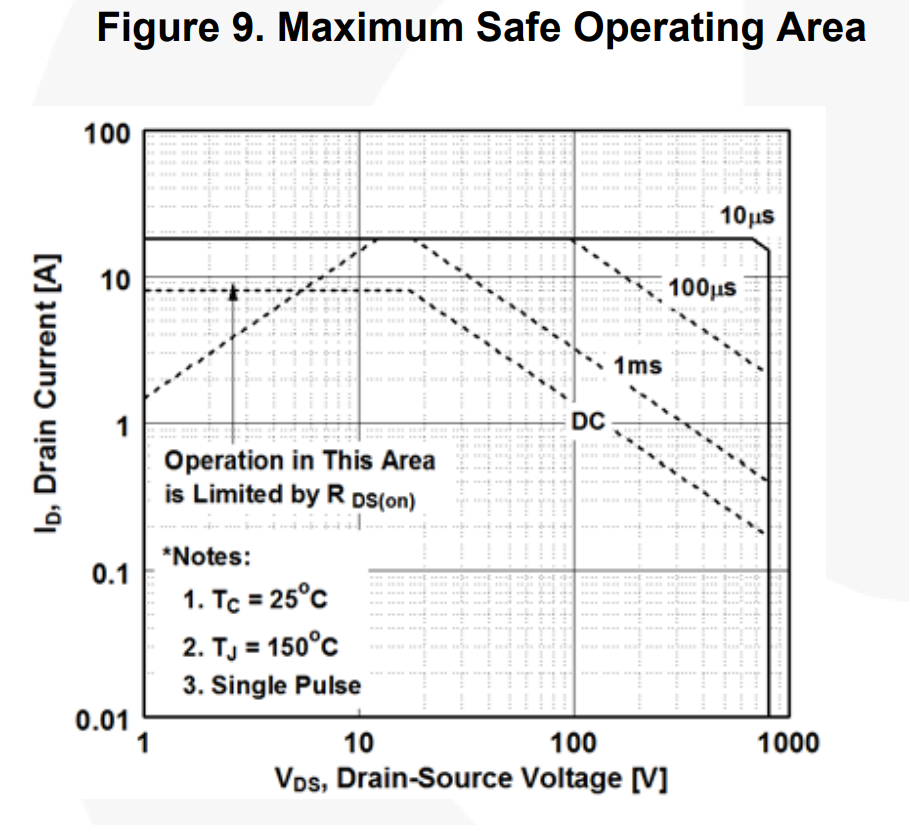

To add to the above, here is the safe operating area for that 800V FCP850N80Z MOSFET. Remember that at short circuited output, all the input voltage is across the MOSFET, and to be safe we want to make sure that it can withstand that dissipation indefinitely* .
So if your input voltage is 800V (max allowed), you see that the max current limit is about 200mA.
You also see that if you want to set the limit to 300mA, the max input voltage is about 400V. IF you work at 400V, it is better to use the original 600V FDP12N60, which can handle 400mA at up to 600V (see its data sheet SOA graph).
* In my circuit, the regulator will be shut off in a few 100ms but unless you have an infinite heatsink, it should be treated as DC.
Jan

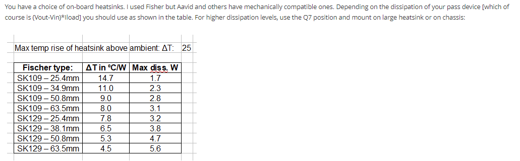

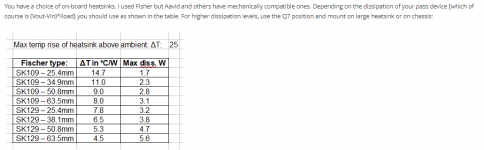

Heat sinks
Hi Jan,
one question:
Q1+ Q8 are on the same heatsink. Right?
What about Q7 does it need a second heatsink? If so is a small one sufficient?
My current f.e. is about 40 mA, the voltage drop between raw input and Vout is less than 50 V.
All the best for the new year by the way
Q8 is the current source and should be on the 'inside' of the heatsink.
For the pass device you use either Q1 or Q7.
For pass device dissipations up to say 5 or 6W you can use the Q1 position on the outside of the heatsink.
For higher dissipations, use the Q7 position on an external heasink or bracket.
In either case, Q1/Q7 is only one device, the same device. All documented online here:
T-reg HV regulator | Linear Audio NL
Jan
