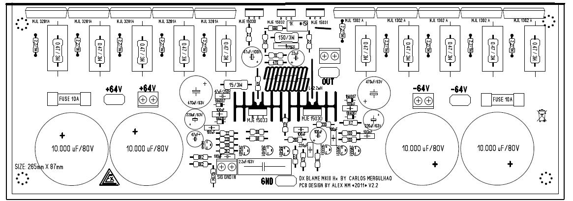

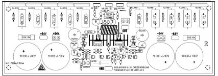

images from GERBERS
These images are from the manufacturer, Advanced Circuits, made from the gerbers I sent them.
The board will be about 10.5" by 4.5". Copper and soldermask on one side. Silkscreen on the other. Green board with white silkscreen. Copper will be 1oz (0.35mm) thick. Copper tracks are left exposed along high current-carrying tracks for the builder to tin. That's what those long lines are in the soldermask. There are holes for terminal blocks, and for soldering directly to the board - your choice.

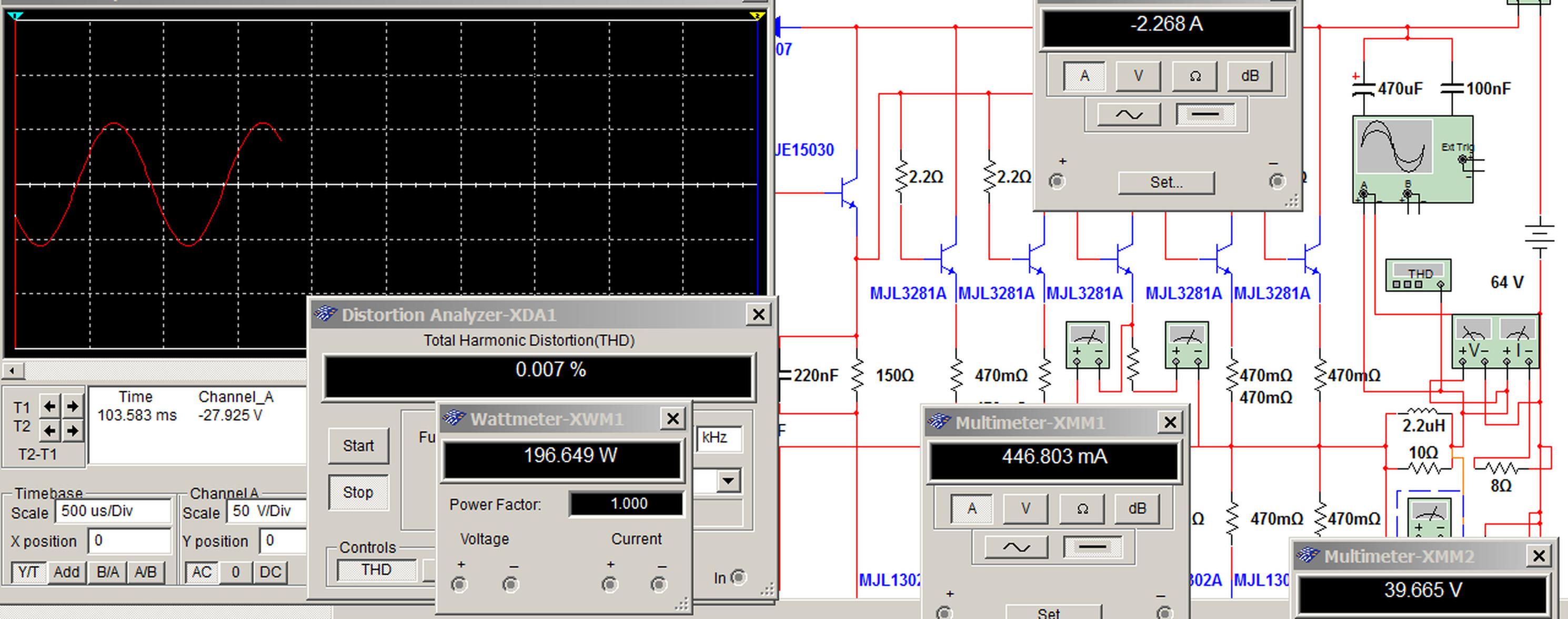

Here you have the schematic
It is not pretty...if someone wants to colaborate/cooperate and draw a better schematic (more pretty), then please, go ahead.

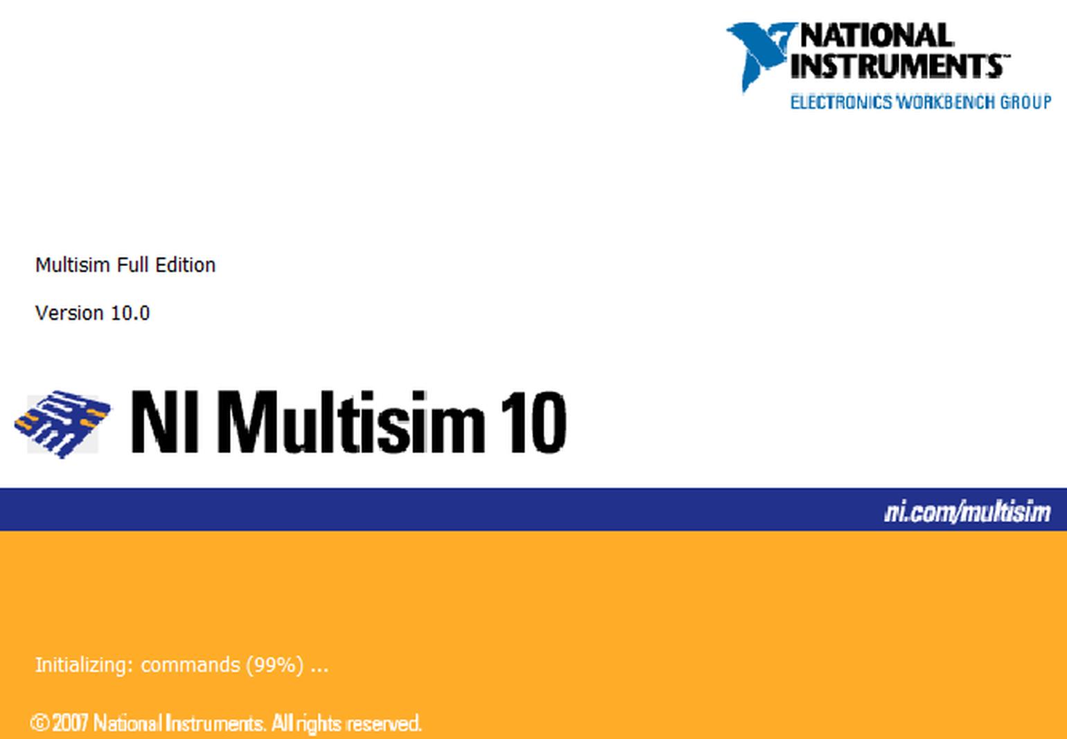

This was made using a simulator software.... NI Multisim 10 ... do not looks good.
This amplifier was not created using simulator...it was assembled and ideas tested and sonics tuned to each subcircuit... then finally was simulated.
I have assembled two prototypes and both prototypes played 300 hours for testing purposes.
regards,
Carlos

Yes.... a mistake i think...i have asked Byron to fix that
I had problems because of "L" shape adaptor.... and board offering this option is dangerous...to this level of power we cannot have adaptors.
This may create a lot of troubles..we may have to use thermal protector and it switches the amplifier off when over heated...so...one more board...not a good idea.
See this video attached below..... i found that even using thermal grease, and also using thermal grease into "L" shape adaptor...even using Mica insulators together thermal grease i had troubles, and this amplifier shown is only 240 watts...imagine this monster we have here in this group buy?...that can put out 1 kilowatt (distorting)...will be a hell on earth.
Also i have used more screws to fix the adaptor.... no good result...when playing loud for long time i had the temperature going to around 65 degrées celsius..and this is dangerous... transistor junction will be very hot... several important specifications will change because of temperature.
‪Supercharged L adaptor heat transference issues‬‏ - YouTube
I do think Byron is trying to offer this as option..as people can use it or saw the excess of board off... what i do not know is if people want to use their saw.... say... paying for boards that will need some work to be done on them.

Carlos, it is an awful work to saw off the excess of a 1.6mm (over even 2.0mm) thick fiberglass PCB. I tried it once and and failed. Maybe because I do not own the required tool.
I would not offer a choice how to mount the trasistors. Supply it for vertical mount only.
