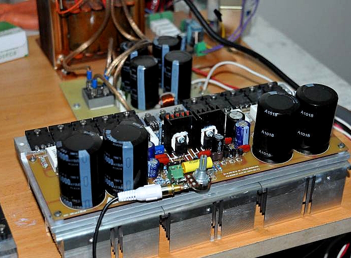

A friend from other forum told me these heatsinks
are presenting 52 degrées Celsius (Centigrades)... this is too much hot.... better if you can keep these ones at 45 to 47 degrées.
A taller, or bigger heatsink will be needed for him to cool down these two transistors mounted in separated heatsinks.... they are lovely but small, not that tall as i was dreaming for.
The guys is using 68 volts supplies...... and the higher the supply voltage the bigger will be the problem related these heatsinks.
In my construction, home prototypes using standard supply voltage, i have not noticed heat there because these transistors where mounted into the main heatsink...but seems you may face some trouble because heat there.
Be aware you may have to replace these heatsinks for larger ones.
regards,
Carlos

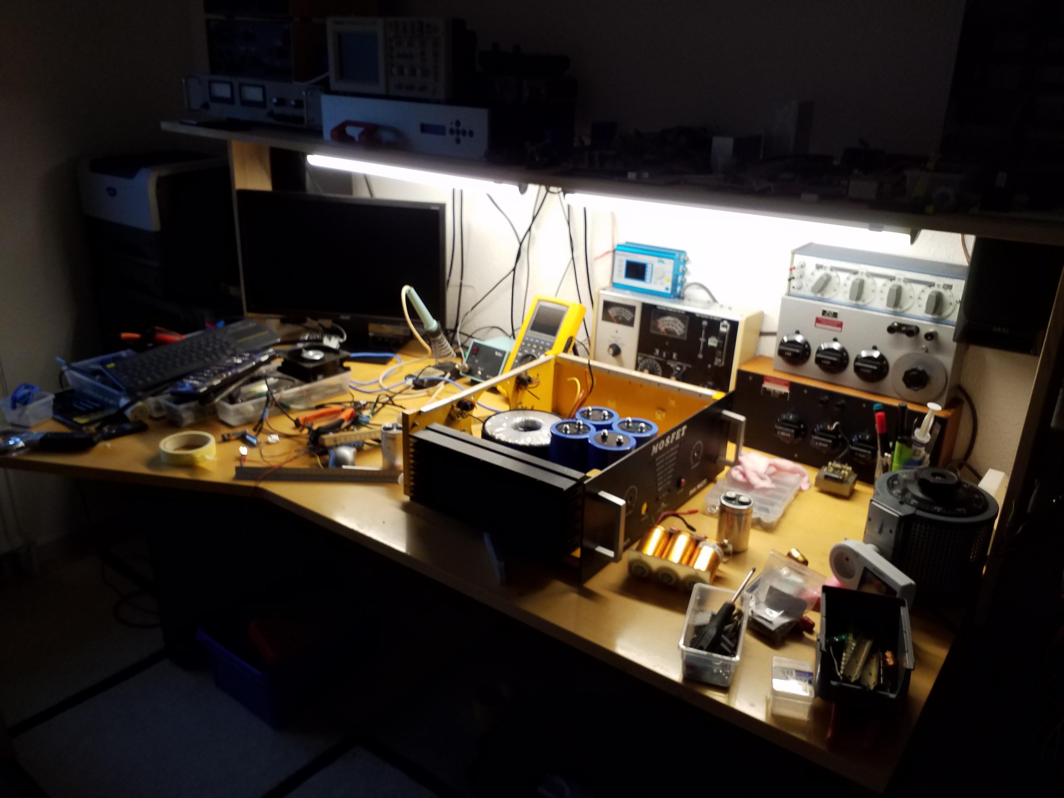

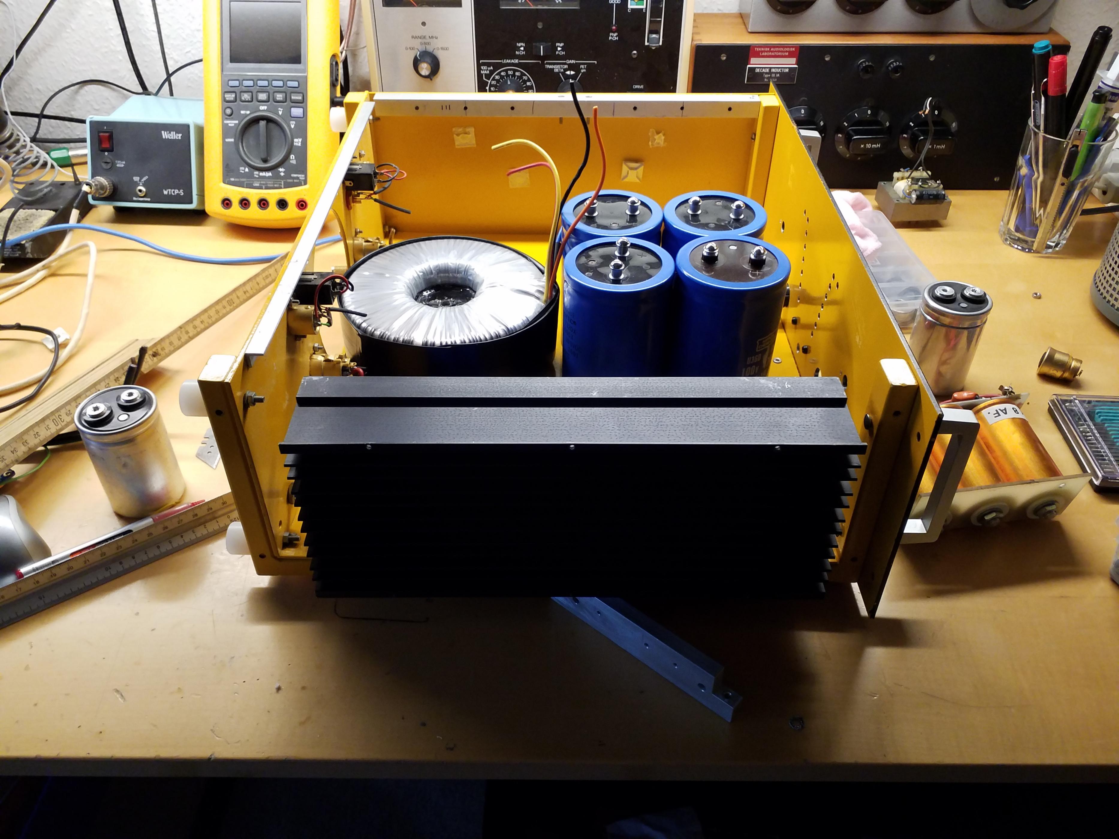

I am building the dx blame, and i have a question regarding heatsink.
I'm on a budget so I'm using an old chassis, it's going to get a paint job, quite a yellow chassis, the heatsink are from an old pa amplifier and weigh around 5 kilos, my only problem is the fins, they are horizontal, convection must be degraded or am I wrong, adding some pics
