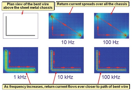

The latest issue #91 of the EMC journal has an excellent article by Keith Armstrong; "Maxwell's Equations, Quantum Electrodynamics, and good installation practices for SI, PI and EMC". Page 40 has some simulated diagrams of the extent of tracking for various frequencies.
As well as EMC, this is citical to signal integrity for high speed designs and layout, which is where my interest are.
What is interesting for audio signals, is they cover a sort of transition zone, where the low frequency (and generaly the highest power) spread, whereas by 1kHz the signal wants to track to some extent. It would be interesting to have the data for 20Hz to 1kHz in smaller steps.
The "Resistive vs. Inductive Return Current Paths" further complicates things by showing a U shaped trace, where source and load are next to each other! Not done with most practical designs.
This shows the complexity of the audio signals and why inter component (pre-amp to amp etc) grounding is so important. Though on PCB's having a ground plane is better than the star grounds often employed, let the current find its own quite complex path ( a heretical view here), though controlling high and low current sections is critical.

A few more links:
Printed Circuit Design & Fab Magazine Online
above but more in depth.
http://www.emcs.org/acstrial/newsletters/fall08/tips.pdf
Return Current in Plane
Visible Return Current
