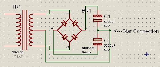

I have
2,9,10 connected together on the pcb
3,4,8,7 connected togehter on the pcb
5,6 connected together on the pcb
Now i have pads to tap these all so lemme see if i have this right:
I take all the taps (wires) and connect them and the ground (CT off the xformer) of the psu caps together?
like this??
Looks like you've cracked it, CD. The star point needs to be at the point where C1 and C2 connect - not on a spur from this point. Make sure all the ground "taps" connect at as much of a single point as possible. There are lots of ways to do this. When I make a star ground I usually solder eyelets on each wire and then screw them together on a bolt and I put the high current gounds at one end of the stack and the low current at the other end. Try to run the ground wires and psu wires in a close bunch from psu to pca to reduce loop inductance.
BAM
(ps: your bridge rectifier isn't connected correctly in the diagram :xeye: )
That is opposite of what I do. If the caps are mounted on PCB's I run a heavy, short trace for the common connection between the caps and then run a short stub off the middle of that trace to my star ground point.
If the caps are connected with harnesses then I run a heavy gauge wire between the common connections of the caps and run a single wire from one of the common cap terminals to the star ground.
Making the ground connection that way means the capacitor currents aren't flowing through the star ground point.

Meeting point
That's something you shouldn't do apparently: put capacitors meeting point and star point on the same place. The star needs to be away from it. Reasons for this seem to be that is a high current point.
Doug Self seems to give similar reasons from where you should pick the feedback on an amp output, and that you shouldn't do it from the point where the two emitter resistors meet, but slightly away from it.
The star should also be isolated from the external box, though a wire from it should also go to the star.

Star point
"Doug Self seems to give similar reasons from where you should pick the feedback on an amp output, and that you shouldn't do it from the point where the two emitter resistors meet, but slightly away from it. "
This is to do with taking the feedback from a true summing point (i.e. the summed output to the speakers) and is a valid point.
The problem is, with a single transformer secondary, the bus-bar between the caps is not a summing point, and the significant and large current flows here make for measurably different potentials (DC and AC) as you move along it.
Connecting at a tap though, gives you a shared current path, of finite impedance.
I REALLY like BAM's idea - it allows lots of wires, in the smallest possible distribution, with the end result being a 'lump' of commendable volume, and hence low impedance.
With dual centre-tapped secondaries, the bulk of the current flow can be removed from the bus-bar, improving performance considerably, by removing the current flow from the signal earth (with correct wiring).
Remeber the current flows in loops - that's really important.
A.
Finding a point
"This is to do with taking the feedback from a true summing point (i.e. the summed output to the speakers) and is a valid point."
Just mentioned this to illustrate that the right point is not always the most logical.
"Connecting at a tap though, gives you a shared current path, of finite impedance."
I wonder if you can use a T shaped pcb track, the two opposite ends being the caps and the lone end the star.
"I REALLY like BAM's idea - it allows lots of wires, in the smallest possible distribution, with the end result being a 'lump' of commendable volume, and hence low impedance. "
I have seen using the caps meeting point used as star on many projects... and criticized later on.
What I don't know is how potentials work when you use a "surface" instead of a track. That is many use a copper surface or even a metal plate and put the star there.
"With dual centre-tapped secondaries, the bulk of the current flow can be removed from the bus-bar, improving performance considerably, by removing the current flow from the signal earth (with correct wiring)."
Yes, that seems to be the way many transformers are being rectified now, and I should be trying it on my next project. But you need separate secondaries.
"Remember the current flows in loops - that's really important."
But how does that concept apply on why we shouldn't use the caps meeting point? We are not making a loop here.
