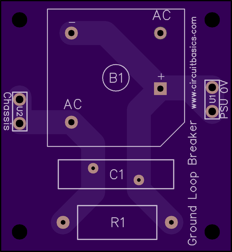

I am building a power supply to power 2 amplifiers and I wanted to build a ground loop protection circuit. The fellow that designed the power supply and amps also has a schematic for a ground loop protection circuit.
But I had a pause when I read this.
Quote:
If a ground loop protection circuit is used, all input and output terminals must be electrically isolated from the chassis. Otherwise, the ground loop protection circuit will be bypassed entirely by the input/output ground wires that connect to the main system ground
EndQuote
Does this mean that no part of the RCA input jacks should be in contact with the chassis ?
The only input or output terminal that I have are the RCA jacks and the speaker terminals.
And now i am confused

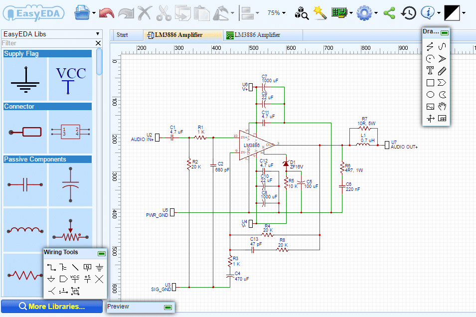

Ok, here are a ton of photos. In no particular order:
Power Supply Schematic
Amplifiers schematic
Ground Loop Protection
Wiring diagram.

I read the article Scottjoplin pointed me to and at my level of expertise, (hah !), most is beyond me.
But this is what I gleaned re hum and wiring.
1) wrap the 0v, +v, and -v, around each other. I am already doing that so I am good there.
2) locate the signal connectors, for ground and signal, close together and wrap the signal wire around the ground wire.
This I did not do. The 2, signal wires are independent and the 2, signal ground wires are wrapped together.
The picture shows the back of the chassis and it shows the 2 RCA connectors separated by 3.5 inches or 88mm. I put them near the corresponding amplifier and speaker connectors.
Near the top of the picture you can see the power lines red, yellow, and black, wrapped together.
So, I think that I will leave the RCA connectors where they are, and do the signal/ground wrapping solution.
What do you think ?

Regards the power wires, twisting is better than braiding, but the most important thing is that they are in close proximity so shouldn't matter too much. Yes, leave RCAs where they are, again probably ok, but twist the signal and ground together as you say. The whole idea is to keep flows and their returns (whatever they are) as close as possible and twisting also reduces interference.

Thank you Scott. I redid the wiring yesterday and it made a big difference. I silenced the right channel so much that it is completely silent,:D:D:D.
So what about the speakers, should I do them too ?
