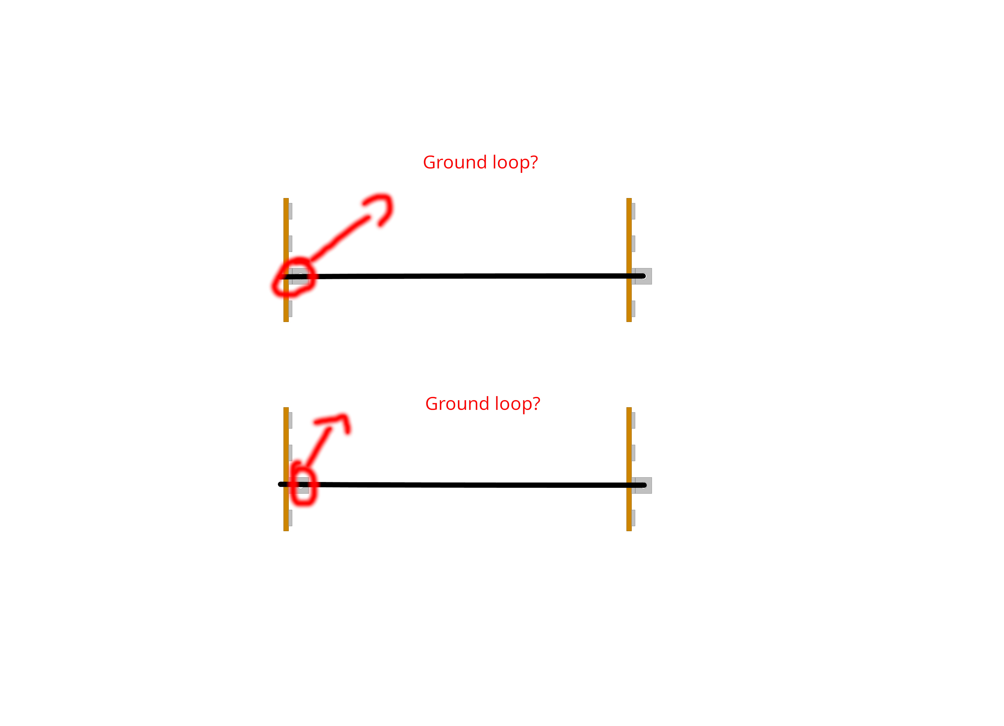

I'm planning to build my first tube amp with Tag Strip boards. But I have a question about ground bus bar and ground loops. If I mount some tag stripes board, and one of the tag goes to chassis with a screw and I solder the bus bar... this is a ground loop?

Yes, if you use that tag as a ground and do the same with another tag strip you have a loop. I always bend that tag over the strip and crimp with pliers it to ensure that I don't use it as a ground by mistake. Once you fold over that tab, the tag strip becomes stronger and you can add a dab of epoxy to the joint if you want it really secure.
It's only a ground loop if current is flowing in the chassis where you don't want it. Get the power supply right (adequate filtering, no capacitor ripple current through the chassis, no heater current in the chassis) and you can ground anything else anywhere and be completely hum-free. Look at any 50's - 60's hi-fi construction - they knew how to do it. Star ground and bus can have hum-producing loops if not implemented correctly - keep current loops short!
1. Connect the B+ secondary center tap to the very first filter cap.
Then connect from the very first filter cap to the second filter cap.
Then connect from the second filter cap to the amplifier central ground point.
2. Do not connect the B+ secondary center tap directly to the amplifier central ground point.
A little drawing of these two, and a little thought will show you one of the best and worst
ways to wire the amp.
The first (1) keeps the high frequency transient currents in a local loop.
The second (2) puts the transient currents onto the rest of the amplifier.
That IS a very bad ground loop.
Now you know something about ground loops.

Sorry missed the diagram, I would joint C11 and C13 together instead and make that your star/chassis ground, but I don't think it matters. Your RCA inputs should not ground to chassis. Just make sure you return the rectifier currents back to the transformer and prevent them getting into the signal ground. The proof is in the pudding.

Technically would be, but I just finished a build where I did exactly this, along with another strip just below it. It's grounded to the chassis as well as jumpers across. If you're worried about hum, empirically my build has almost none. I have to stick my ear right against the woofer to hear any.
