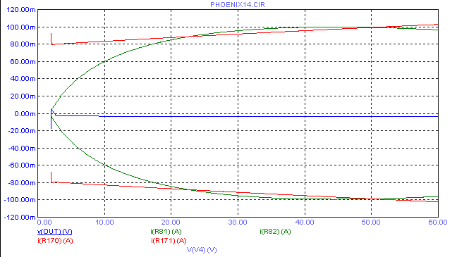

By the way, below the bias as function of the supply voltage.
Red: CCS
Green: Compensated bootstrap
Which of the two do you prefer?
Looks like an unfair comparison to me. Show us the bias stability of the bootstrapping version without any corrective arrangement. Such could be introduced for the CCS version as well.
I showed the compensated bootstrap as an answer on Dado's remark:
"although this might result in somewhat reduced bias stability with unregulated power supplies."
Of course you also can apply some form of compensation on a CCS.

I don't have exact data. I guess VA will vary as much as beta will. For a given process, VA * beta seems to be constant.
Anyhow, no matter which method is used (a CCS or a bootstrap), in both cases the Early effect will affect the bias stability (that is, with an unregulated PSU).
E.
