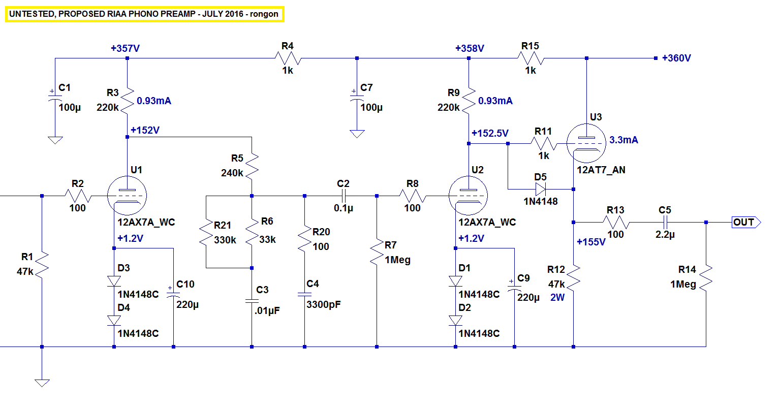

I only had time this past weekend to wire up a Slagleformer AVC volume control (yay!), and run the TubeCAD RCA-with-Aikido-CF circuit through LTspice.
I took the same two stages of 12AX7 and simulated them, one with a plain R-loaded CF and the other with the Aikido-style CF. Is it possible that a regular old R-loaded cathode follower will yield lower distortion than the Aikido-style CF?

Hi rongon
Why would you consider using a 12ax7 as a cathode follower? I would use a different valve/tube. You have a lot of options.
Ian
Ian
Oh, sorry. The first two gain stages would be 12AX7, the CF would be something like a 12AT7 or 12AU7. I guess I could use a 6SN7. But the CF would not bea 12AX7.

I was thinking of something like 12AX7 common cathode > 12AX7 common cathode > 12AU7 cathode follower. Or maybe the cathode follower could be a 12AT7, or even a 12AV7 (because I have a bunch of those).

I would assume that multiple stages is OK when designed properly. I have some 3A5 tubes I bought (can't help buying tubes) and some chap made an RIAA out of these before even though they have a mu of 15. Actually, I only got a turntable recently and have but two records so this RIAA stuff is new to me - I'm currently laying out a PCB for a transistor version (TGM1i thread) but I like to follow information on tube RIAA. I would like to clone the Shindo Claret as first attempt, I'm not sure I'm brave enough to design from scratch and I have all the design details for the Shindo as well as one of his power amps so I thought I'd make an all-tube integrated.
Here's what I'm thinking (attached schematic). 360V B+ supply, 1mA plate current and 220k plate load resistors for each 12AX7, DC coupled to a plain old 12AT7 cathode follower with 3.5mA plate current. I can plug a 12AU7 or a 12AV7 into the cathode follower spot and the performance hardly changes.
I was thinking of trying a Morgan Jones Statistical Regulator-style power supply. It would take twenty-four 15V zener diodes to make the zener string. I have a 30uF motor run cap I could use as the final bypass cap.
I also ran a simulation of the same circuit with 100k plate resistors on the 12AX7's, from a 300V B+ supply. The prediction is for about twice the distortion and about 15% lower gain. That should still work well, though. Distortion is predicted to be low for either version.
