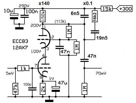

To get rid of Miller, turn down the gain 😀
With a cascode the gain is round 1x for the lower one.Better put an extra C to keep HF rubbish out.
An other advantage is the high output impedance, determined now almost completely by the load.
Like this ? 😉

This is another valid solution. I remember some Grant phono amps that used this kind of method.
Ian
How do you arrive at the 500 pF capacitance? How much of it is caused by the miller capacitance of the 12AX7 and how much by the cable?
Miller capacitance is fairly straightforward to calculate.
Cgk = 1.6pF + 0.7pF stray = 2.3pF
Cgp = 1.7pF + 0.7pF stray = 2.4pF
If we do unbypassed cathode, with a plate load of a 370K and bias to around 1V at 0.5mA then you are looking at a amplification factor of around 55.
Av(unbypassed Rk) = (mu*Rp)/(Rp+ra')
But the unbypassed cathode increases ra' - example: ra'(unbypassed Rk) = ra + (mu + 1)*Rk - in this example, with only 0.5mA current, ra is about 80k Ohm according to the GE specs sheet.
So for this example ra' = 80k + (100+1)*2.2k = 302.2K and the amplification factor becomes = (100*370k)/(370k+302.2k) = 55
Therefore Miller capacitance of the 12ax7 stage alone will be 2.3pF + (55+1)* 2.4pF = 136.7pF
Now.. how will this effect 3dB upper frequency roll off? Let's remember that we have a 47k Ohm load resistance for MM.
f = 1/(2*pi*R*C) = 1/(2*pi*47k*136.7pF) = 24.8 kHz
Sounds pretty decent, but as Stuart mentions, there are things that add to the miller capacitance... MM cartridge itself and the cables for example.
In Stuart's example, he claimes a total input capacitace (cartridge plus cables plus miller capacitance) of a whopping 500pF (!) This would theoretically experience 3dB high frequency roll off at around 6.8 kHz
This sounds pretty dire. BTW - You can do the same for a Triode strapped D3a. If you use a CCS then it can be useful to simply estimate the plate load to 1M. If you bias using an LED then do the calculations for a by-passed cathode instead to determine ra' I did those calculations and the miller capacitance was actually worse than 12ax7 (assuming MM input). Maybe I should do them again just to be sure...
So, what does this mean? Does Stuart suggest MM should be generally hung? I can't comment for him on this and expect he might have more to add. 🙂
However... look at it this way: The whole point of a phono stage is amplify the signal enough to neatly and progressively roll off the higher frequencies to match the RIAA curve. After RIAA equalization the signal invariably must be boosted again to get to line-level, and then usually requires some output buffer to drive a reasonable load such as a cable. ok?
So perhaps the inherent high frequency roll-off can be used to our advantage (if we are careful).
Beyond using an inverse RIAA network, it is therefore probably wise have to use a test record with frequency values to do MM well. Mine is admittedly not so great - it just has discreet signal levels - the highest being 15kHz - which I simply can't hear at all anyway. There are far nicer once out there.
Btw - this also means that using an MM phono stage for MC (or the opposite) not such a brilliant idea...
Ian

Could you be so kind as to explain your 500pF value?
Btw - my gain is only 54.. since input impedance of next stage is 1M. Sorry I left that part out.. 😉
Lets swamp the cathode some and add 5pF then.
New total Miller capacitance including strays and cable = 2.3pF + (54+1)* (2.4pF+5pF) ~= 410 pF
Looks big! Its a good thing I account for it in my RIAA anyway.

So for the MM carts that don't manage tube-level input capacitance well, the only alternative would seem to be solid state. Correct?
Nope. 😀 There's other ways to handle the issue- lower mu, cascoding, grounded grid, buffering...
Ok, I've done some of these things for MC before, but never really considered it for MM.
Chiefly due to manufacturer recommendations.... but now it makes much more sense. I suppose I have been lucky with my relatively limited choices in MM cartridges until now.
I'm glad you managed to get your 150MLX down to 100pF-200pF range that is recommended. If it were me I would try a buffer stage. sounds like a nice challenge!
