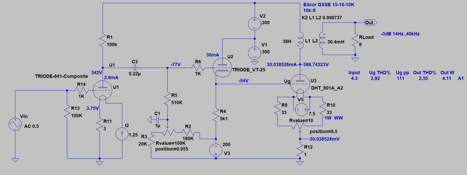

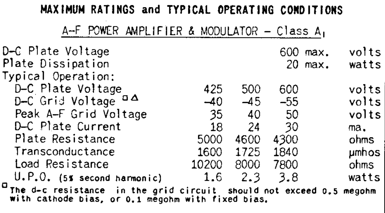

Great, the greenvalve operating point looks reasonable (570v / 30mA / 48v) and I'll probably use it as a starting point. I'll be sure to keep an eye on the grid resistor.
Cheers
Cheers
For this operating point even the -resistor loaded- 841 gain is too weak (see attached simulation).
If you use active load (CCS or "gyrator" -see Ale Moglia versions-) the 841 VAS stage gain would be greater for full amplification at 2V RMS input.
Thank you Euro21. Once I've improved my skills with the greenvalve build, your circuit with 841 ccs/gyrator load, source follower and A2 output is a logical next candidate. Keen to put those 841 to work!
