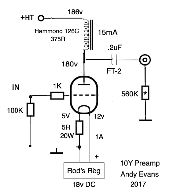

48V bias for 1.25A filament current will result in 60 VA wasted plus the normal filament power. I would never use filament bias with this kind of tube. That's the filament consuption of 2x 845 tubes!
That would be true of 48v bias as you say. But it depends on your operating point for the 10Y. I used a 19v supply to Rod's regs and an operating point of 175v, -5v and 15mA which suits the 126C. Ale used a similar operating point and a 17v supply as you can see here. It sounds just fine. Not the only way to do it, but one way.

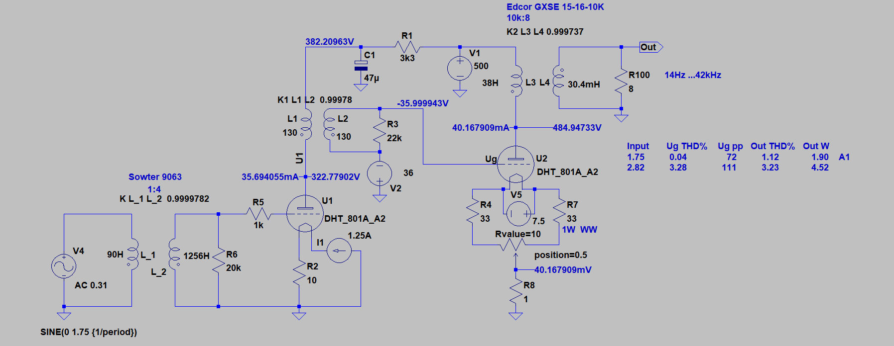

The other solution is using 801a in A2 mode (zero bias) as L0rdGwyn had:
801A in Single-Ended A2 - Design and Build

@Andy: thanks for your advice and 10Y bias schematic, I'll use that one as a blueprint and go with cathode bias with DC link for the output

If you have Edcor 10k:8, this is one of the acceptable solution.
Looks like an elegant way to get into A2 with only two stages. But the added cost of the other interstages & input xformers plead against it for now. Glad to see you consider the edcors as viable candidates!
