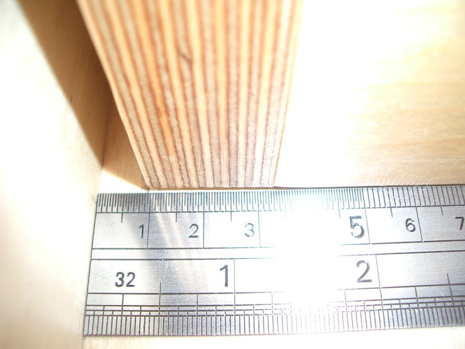

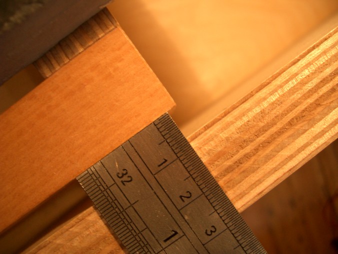

Well I am well and truly P-off with myself . I have somehow managed to glue up my vent piece crooked. AGAIN!
So, when I put the inner box in to mark up I have one vent gap that measures good on one side of box but then runs wide along it's length by about 1-2 mm. Other vent is similar but only runs wide less than 1mm. Not sure what can be done. I thought about cutting the brace with a bit of a lump in it, as if I flex the box the vents even out a bit. what would you guys do? split the difference in gap width? veneer part of the vent pieces? get chainsaw out for some fun?
Need more info
Dust, your impulse to fill the gap is a good one...leave the chain saw for later.😉
Is the area of the gap visible from the listening position?
Does the gap affect the x-section area of the vent?
Can a shim be made to fill the gap...avoiding the clamp-warping of the case?
What finish do you plan? Paint?
You still have 100% chance of success.😉

Hi Ed. The vents will not be visible once I've put the side on.
I'm not exactly sure what you mean by cross-section but If you mean the whole surface of the vent pieces measured diagonally then I think yes. As far as a shim goes, I have some iron on veneer at about 1mm thick. I have just oiled the wood with some Danish oil. Picture is bottom of vent ... about 9.5mm
Ok
I would fill the void with a strip of wood. The care you exercise in its placement will determine the degree to which it is visible when completed. Inside the case doesn't pose a problem...you can make the filler wider than necessary and all of the excess can be inside. The edge of the filler along the outside edge needs to be neat.
I would cut a very small piece of wood 9.5 mm (~= 3/8") long and place it in the throat entry. This could be a wedge for removal through the driver hole later. Bend the wood throat to allow it to fit. Mark the location on the outside of the case. If the 9.5 mm spacer causes the back to bulge, a clamp placed there will bring it into alignment during glue-up. After the side is glued on it will be forgotten.😉
Thanks Ed. Just to clarify, you are saying make the 9.5 mm strip of wood 82mm long ( the width of the vent piece) and wedge it in at the top of vent. (the 7.5mm gap) Yes? to be knocked out after glue-up? Correct?
Dust,
In my second paragraph above, I gave you 2 options:
1) A 9.5 mm "post" to spread the throat from the back of the case, to stay in place or pulled out later. This could be as small as 1/8" x 1/4" x 9.5 mm and would have very, very, little effect on response.
2) A wedge to be adjusted in place to arrive at a 9.5 mm space between the throat and back of case, to be removed after assembly.
Removal after glue up depends upon keeping glue away from the subject piece.
HTH
