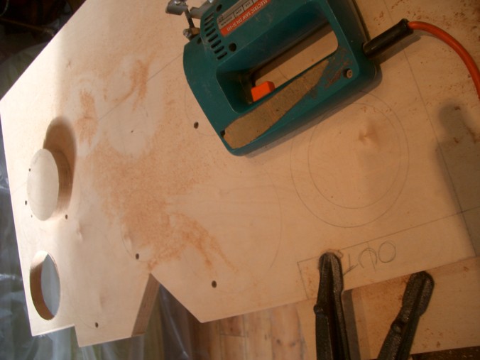

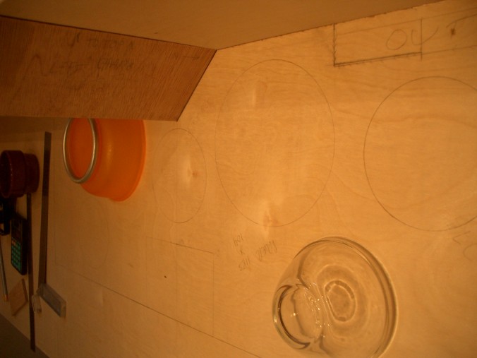

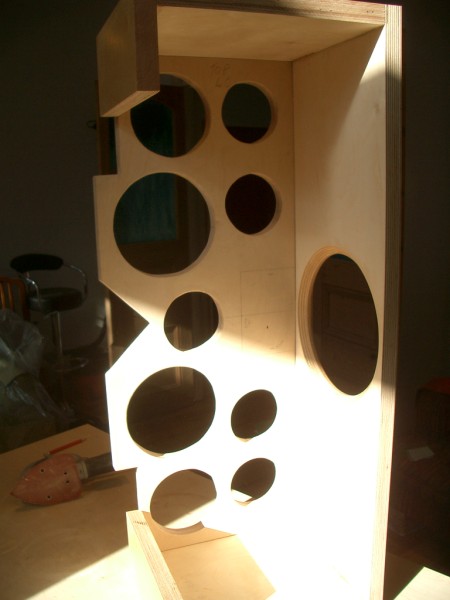

Dust said:My little mock-up is/was usefull to decide on how to attack the build.
that's cute 🙂
looks like it's going well so far... quite a hectic glue-up! reminds me when i recently ran out of clamps for my needle glue-up... 35 degree heat and quickly drying PVA glue = not a lot of fun

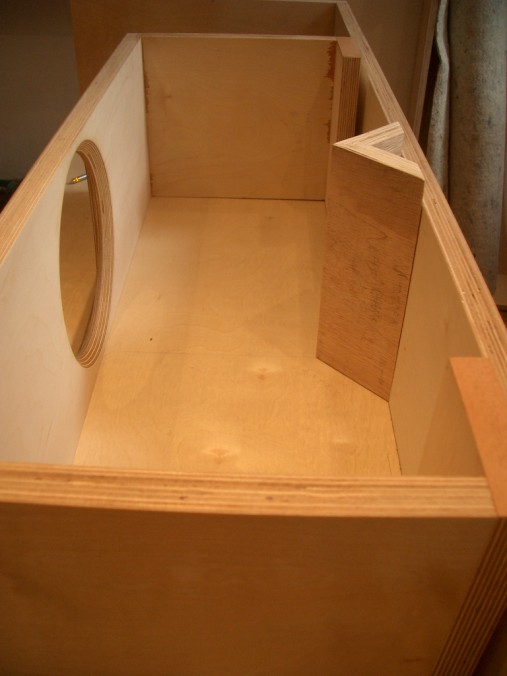

Hi. Can someone tell me if I should double up on the damping for the back of cabinet. I have some really nice 12 mm 100% Swaledale wool felt for the job. I know Scottmoose recommends covering 3 sides but can't remember if he said more behind the driver.
Thanks.

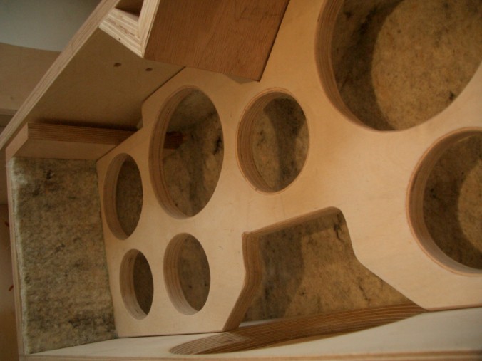

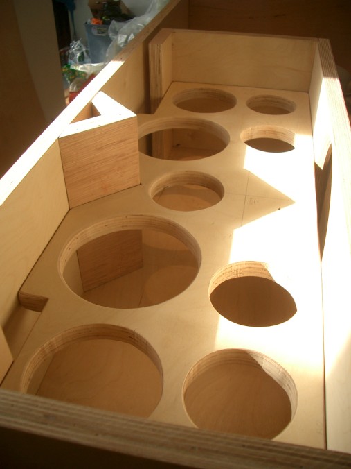

HI. Well I've managed to get the brace and felt ready to glue in today. The brace was guite labour intensive as it took a lot of sanding to fit. The next one should be easier as I will cut it a bit smaller. Hope the holes are ok , I thought bigger would be good for air flow.
dry fit of brace with driver cut-out and felt. I have left a 30mm gap around the vents with the felt , is that ok? I didn't want to get to close. Next up are the binding posts. I will be using Cat5
