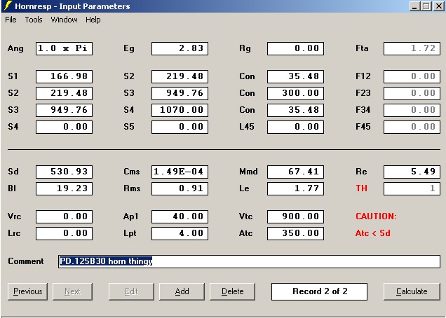

Ok I have a number of questions about the pd 12":
Precision Devices International Limited
1. What is the maximum safe compresion ratio? the cone is paper but looks good quality so I would estimate 3:1 if cheap 8" drivers can take 4:1, but I have no experiance
2. What is the LE of the PD driver, two inductance mesurments are given presumably two voice coils? if so my driver would be the 8ohm version.
3. A loaded and unloaded RMS are given, which is more suitible for Hornresp?
4. I'm looking at the tutorial here which describes a horn with an outlet on its longest dimension, I want to make a horn that is tall verticaly and so need to close the bottom like:
Is there a way of modeling this in Hornresp? or do we just assume that the corner dosn't exist?

Do you want a tall enclosure or a folded one?
The bass doesnt see the corner since it is small relative to the 8metre wavelength.If however we were talking about 900hz that would be another matter.
No idea about loaded/unloaded RMS just enter the lower number
3:1 appears a good rule of thumb
Dont worry too much about le its mainly the low pass filtering element,just guestimate ,or see what a few similar sized woofers are eg compare eminence or 18sound 12"

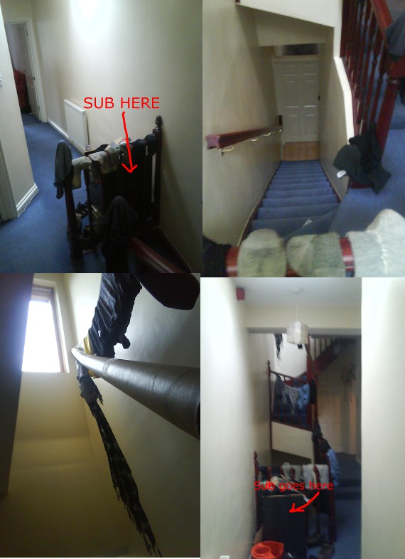

thanks! design seems to be going ok so far, basicly current constraint is that it should fit somehow in a prius with 4 people in aswell due to finding a time slot to build it in the summer when I am home and needing to take it back to London. The reasons for this mainly revolve around the nearest source of MDF to me at the moment been 5miles away and only having public transport to get there wheras at home I can drive to an actual wood yard and get peices cut to size.
I have enclosed a picture showing where the sub is located, this is wall loading so in hornresp I need 1pi space loading?
so tall is good then I can make the main speakers tall and just place next to it, my original dimensions were based on putting the mains ontop of the sub. However height is ultimatly constrained by having to transport it in a car with a maximum of 1 seat down, I could however potentialy construct intialy with screws and flat pack so would prefer the longest dimension to be slightly less than the diagonal width of a prius boot. May not be posible wherupon creativity may be needed.

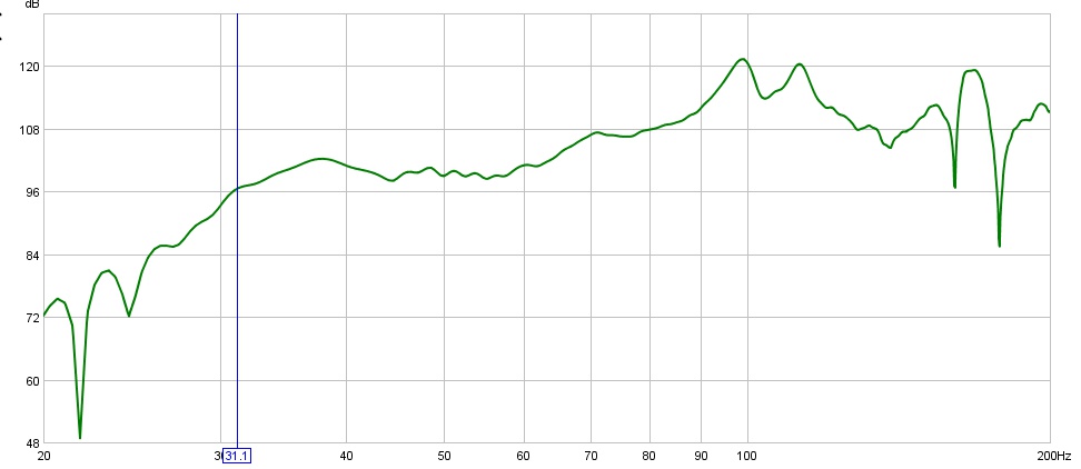

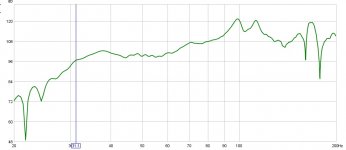

Mesuring the room using my current subs playing pink noise without their EQ curve and comparing with there outdoor no EQ mesurment shows nodes @ 20Hz and 40Hz, managed to lose my memory stick with the plots though :(

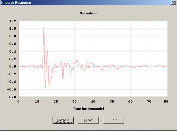

30hz is all fine and good, but dance music only very rarely gos below 40hz, so it is a waste (unless you have unlimited time, money, transport, etc. Also, the 240cm length is possible from 120cm sheet without the problems of your 300cm length.
"my impulse response is awfull"
Impulse response determines the HF response, who cares? You are not going to run it past 100hz, are you?

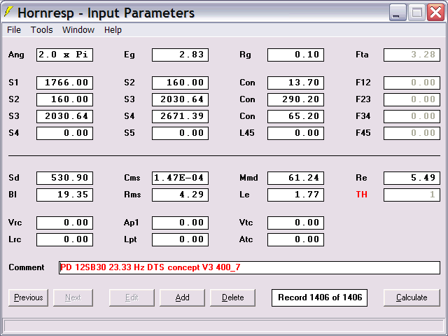

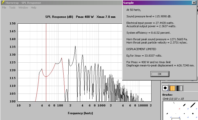

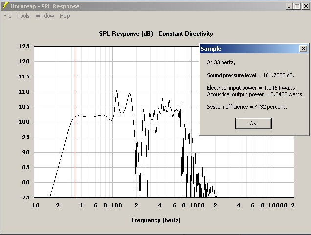

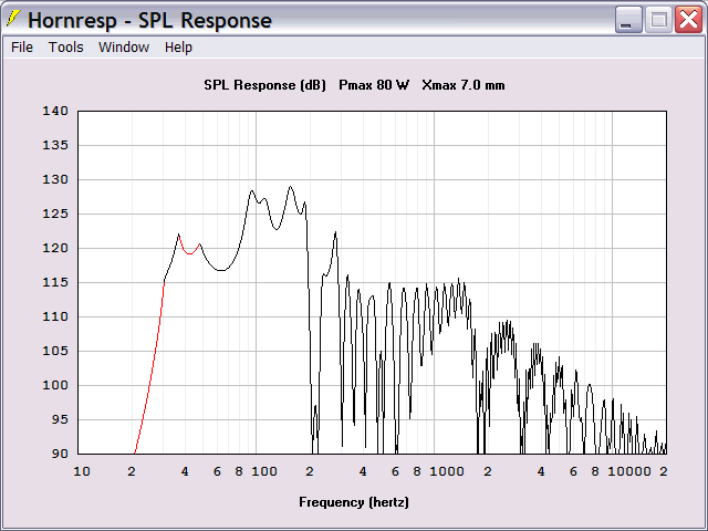

OK, then just running the numbers' for an oversize DTS concept to ~handle up to the driver's Pe rating while staying within your ~480 L bulk limit:
GM
Yeah, this driver has such a high mass corner that it 'wants' a tuning well below Fs, especially if 'blown up' to fill a specific bulk to keep it from being technically under-damped as my sim. WRT its HF mass corner, I just now noticed that the sim I did won't work as is since its L12 value must be 16 cm minimum to mount the driver, so its response should be a bit different than predicted beyond the known variances. Of course without measured specs of the actual driver used, this is all just pure conjecture.............

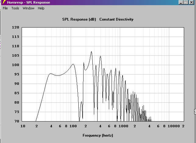

My previous simulation I acidently had a throat chamber but it didn't effect the response, slightly confused over this.

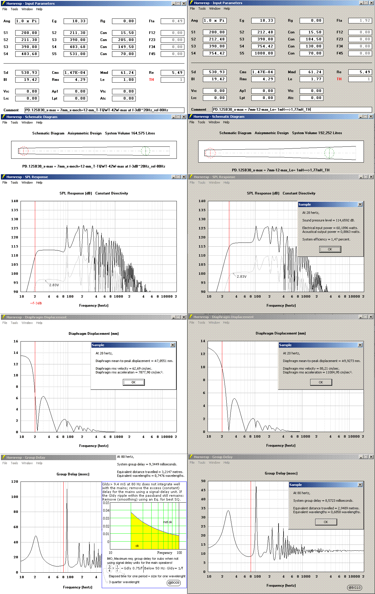

looking at bjorno's simulation I like the idea of 108dB @ 20hz but I am unsure of the physical reprensation of the S5 section. Is this the new horn mouth and if so why not just extend the L34 section instead of adding a new section?

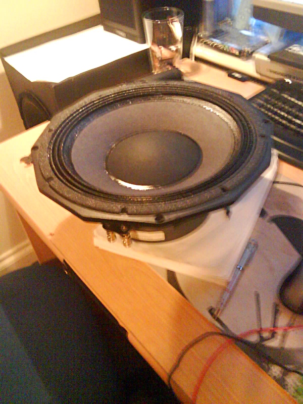

My sub has arrived, very well made bit of kit, completly solid construction about 1/2" thick basket and push fit terminals.
Still unsure of S5 in relation to the tapped horn if anyone has any insight.
Also how would I go about modeling positioning the driver low on the central board such that S3 is efectivly 0?
HR allows either a three or four segment TL/TH to be designed and according to the HELP files, for a four segment the driver is at S4 and the mouth at S5 whereas for a three segment the driver is at S3, mouth S4, ergo S3 is just a phantom point between S2, S4 in bjorno's design as shown by it being just dashed in.

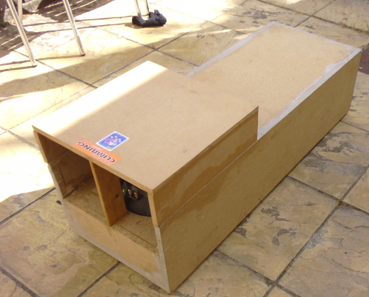

Long time no update...
I ended up going with a tapped 'pipe' with no expansion as the sims indicated only a slight increase in pass band ripple for this configuration.
Initially I had the mouth of the pipe forming a 90 degree bend at the driver end however this didn't work well with lots of turbulent air between the magnet of the driver and the upper edge of the mouth. I think this was because the driver was located too close to the mouth and has a large magnet.
Anyway I had very little time to work on this project so I created an expanded mouth shown in the pics just to get things working. This worked well for a year at my old house and having recently moved house I had time for some pictures and measurements.
At one point I totally fused the voice coil playing sine wave test tones as I was sat in a null and didn't realise just how loud I was going. So the woofer has been through a recone. As a point of interest the PD.12SB30 did take 1.2KW for about 30S before failure.
Anyway measurements coming in the next post.

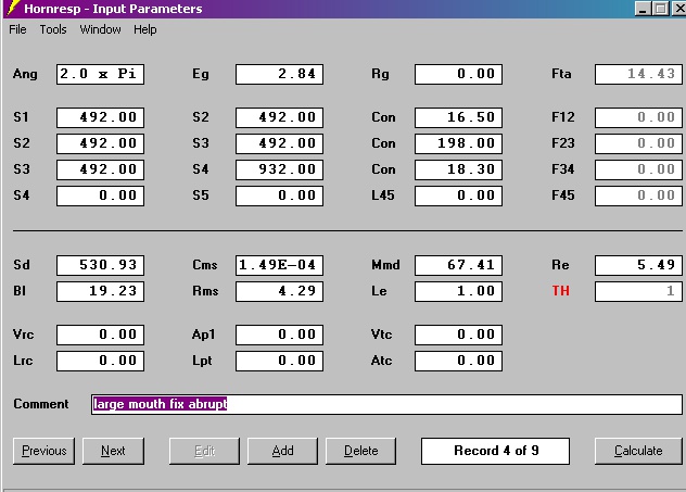

Heres the data. 2.84V SPL taken at a lower level and adjusted to avoid equipment overload. Used ECM8000 mic with generic .cal file and radio shack SPL meter again with generic cal. Just in back yard as shown in earlier pic.
