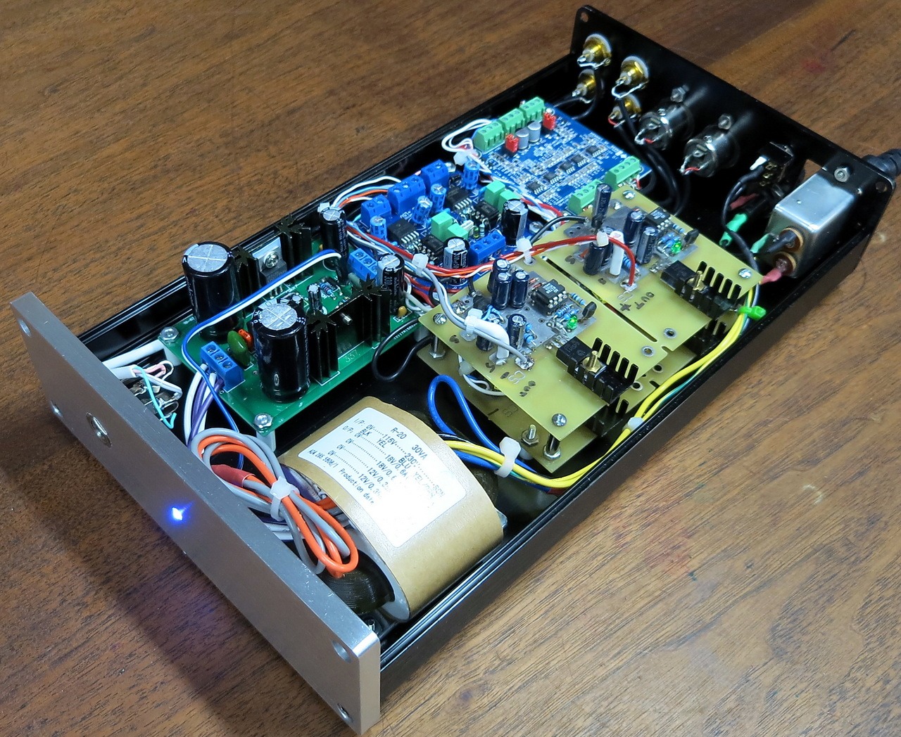

So this will complete what I will call my Covi-d Collection. Projects completed during this miserable pandemic which by all accounts looks like it could be the last leg when we get through the peak.
These projects were started just before or just when the Pandemic arrived. ( I got my Denon DL103 at$269 now $479!)
Line Level amp using Neurochrome Universal Buffer driving my Neurochrome Modulus 86.

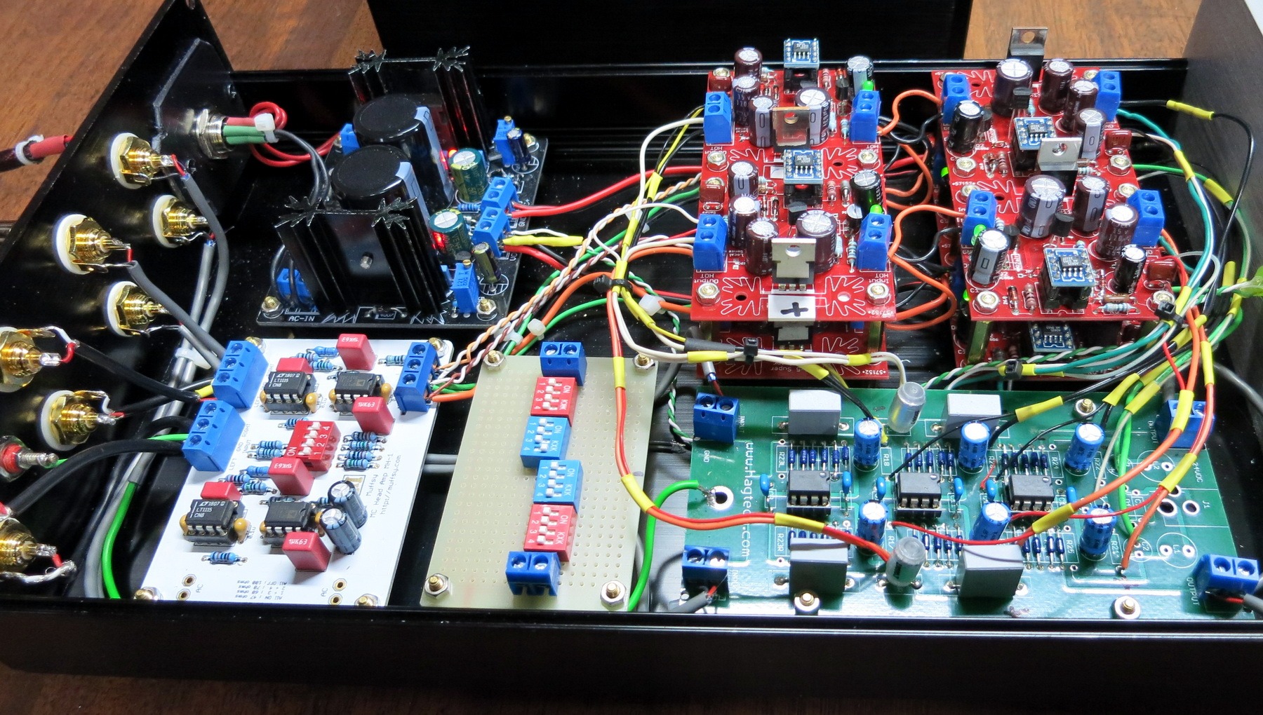

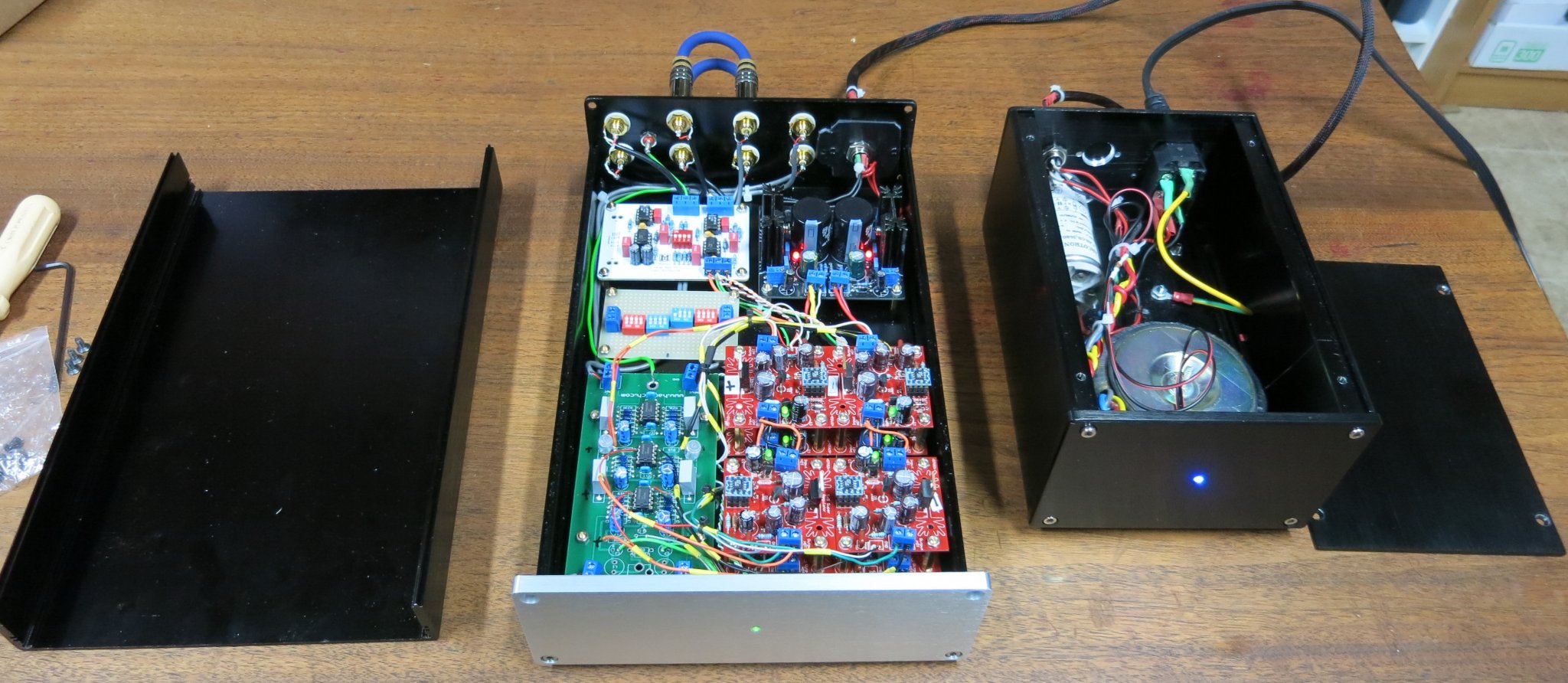

Then finally my Phono Section using Muffsy MC head Amp. This is simply a textbook App note design based on the LT1115. This is followed by Hagerman Bugle 2. I chose that preamp because it has three op amp sections and I am able to separate each op amp on a circuit board with a ground plane. Before I completed the phono section I ran it on 2 Super Regulators not using line sense...reason...I did not have the longer spacers needed to elevate the other 4 regulators. You'd think with the LM4562s with superb ripple rejection ratios there would be hardly improvement with 4 regulators feeding each op amp. That is where I was pleasantly surprised when I finished. When I placed all regulators and used the line sense lines to tightly regulate the voltages, the preamp was very different. I had thought before this I was hearing the pronounced upper bass fatness of my Linn LP-12 as well as some type of resonance in the tonearm/cartridge combination (DL-103). These issues were all gone when each op amp was super regged individually. I never heard my turntable sound as tight and dynamic. I did not expect it to be this good honestly.

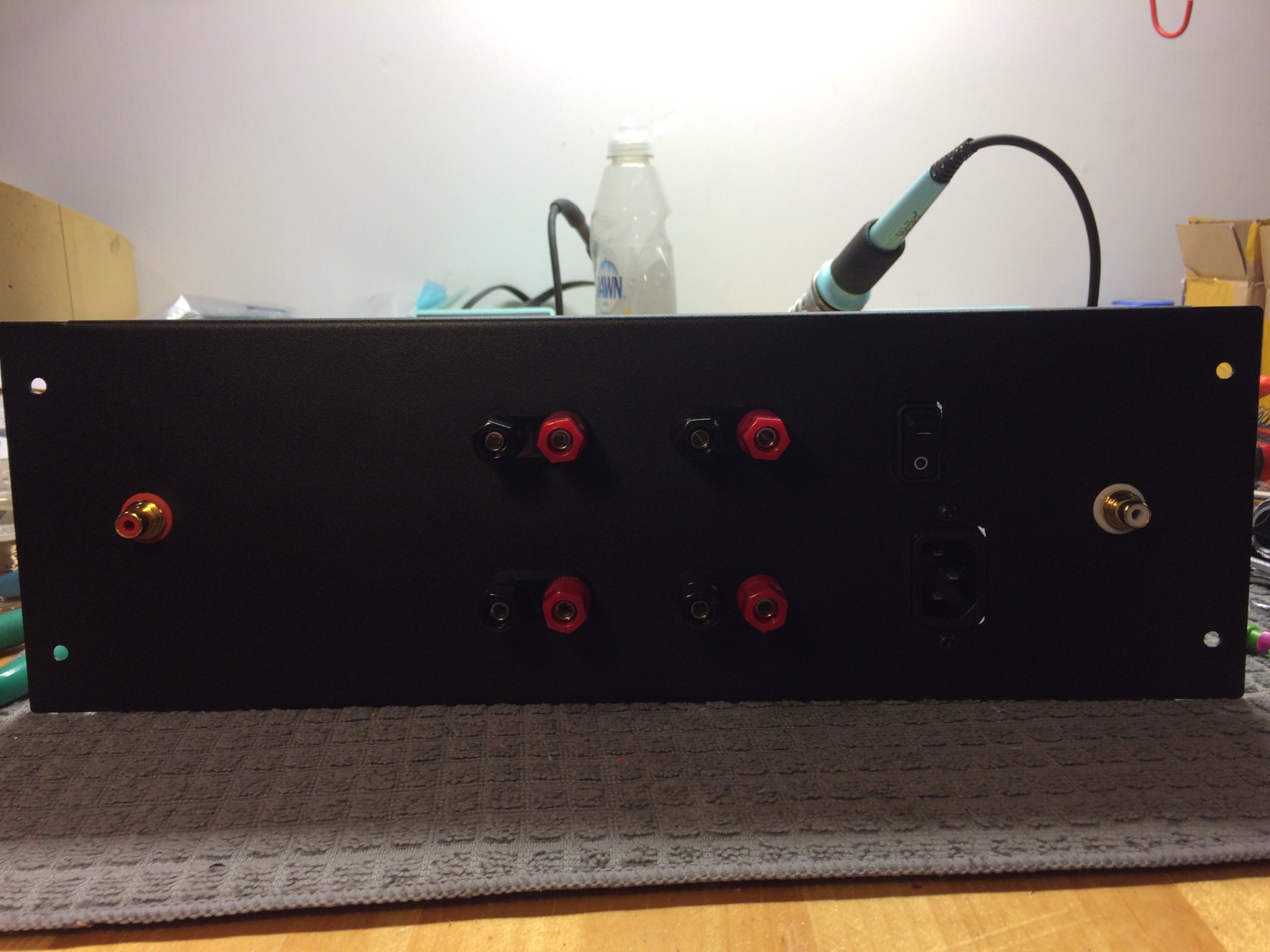

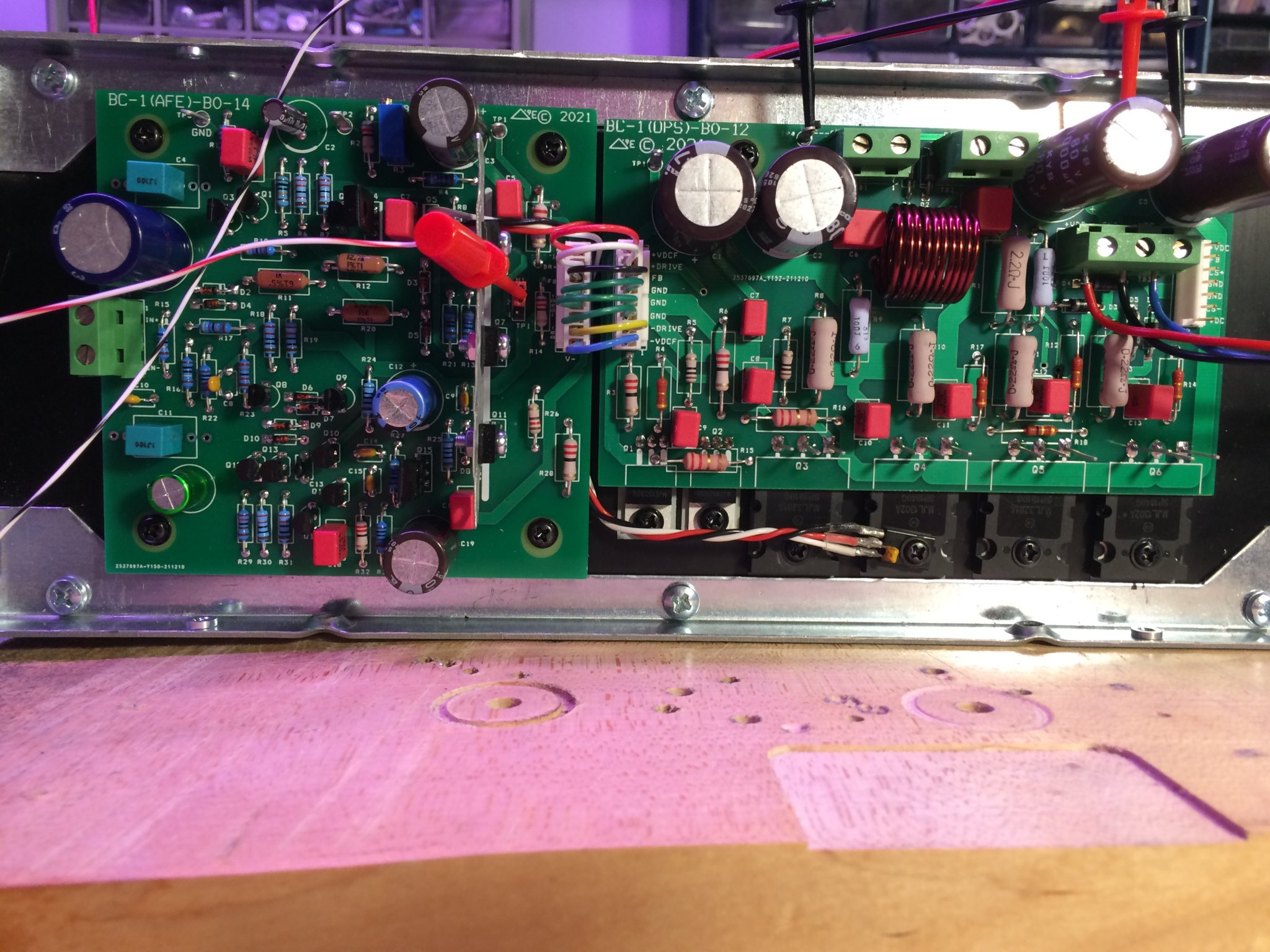

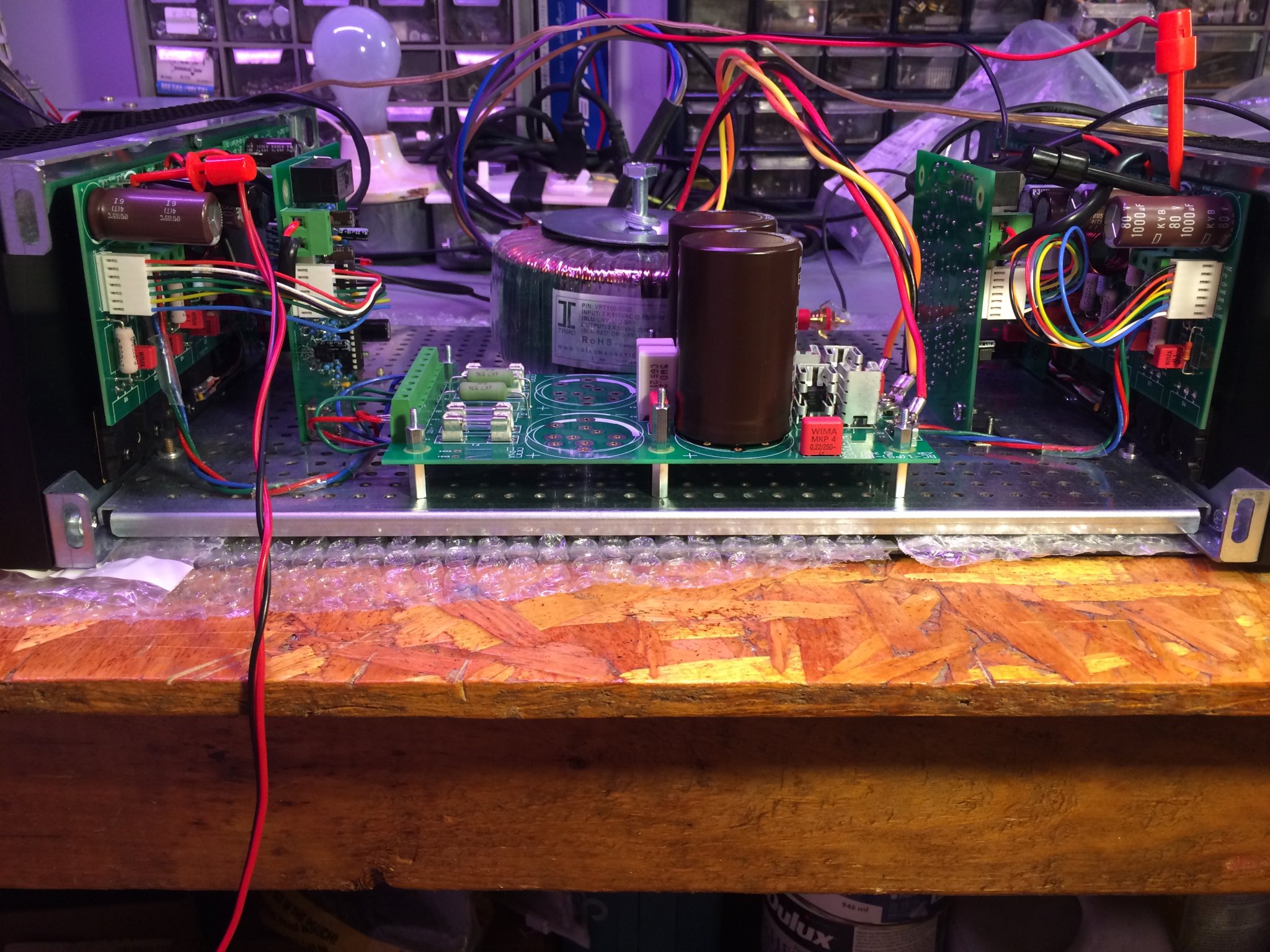

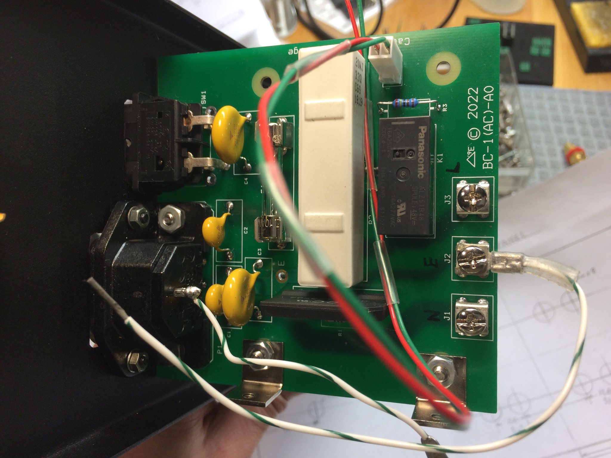

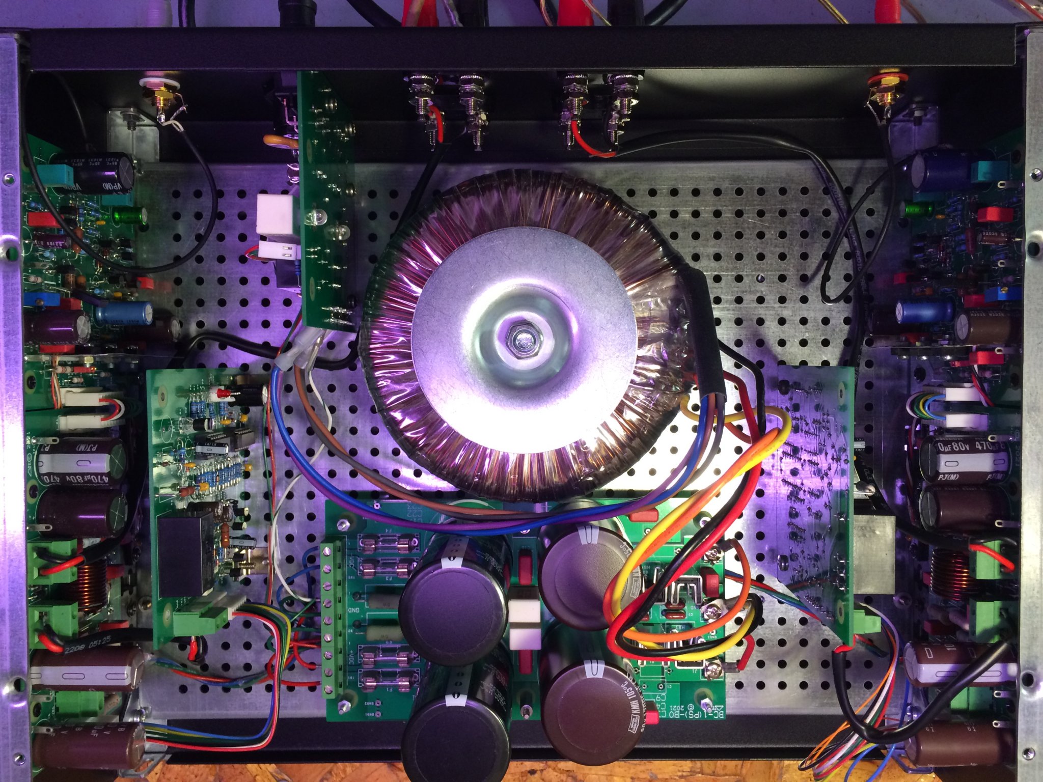

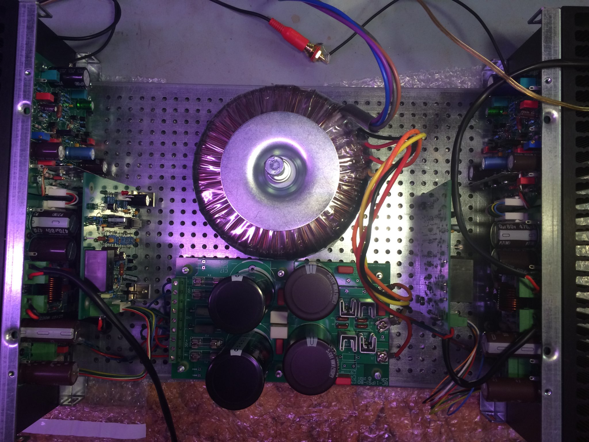

Hello folks,
I have completed the BC-1 prototype amp and it has been running for a few weeks now.
Hafler DH-200C gets shut down after a good few year run. It needs the RCA jacks upgraded anyways +++
Some pics of a working BC-1 for you to gaze at.
the one pic is of the AC inlet, switch, soft-start/relay, filtering pcb which was the last one to be designed and tested to complete the pcb set of 8, 7 different types. Bob C. specified mirror imaged pcbs for the AFE(front-end) & OPS(output)
What I really would like is someone to evaluate it. But in reality it is a solid 150W/ch amp, clean sound, nothing new 🙂 Quiet as a mouse.
Its basically ready for distribution, imo, Bob is still working on his unit, so until he says its a go, its on hold. but i think we could use a beta builder/ tester, parts are a big PITA these days, you have to research and be creative.
