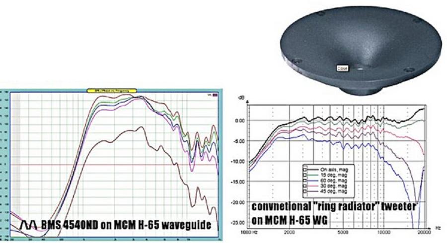

Something is off about those two sets of curves. The first family has very little directivity (spread) plus a pinching together at 3500 Hz. The second group has a very even spread. I don't think a different driver would cause the difference??
In general, could you guys give some info on measurement angles like: "Taken every 10 degrees" (or whatever)?

Measured w/o baffle looks like, in the first curve, evidencing an apparent diffraction "bloom."Something is off about those two sets of curves. The first family has very little directivity (spread) plus a pinching together at 3500 Hz. The second group has a very even spread. I don't think a different driver would cause the difference??
Geddes plots are every 7.5°, as I recall; mine are 5°, typical....
