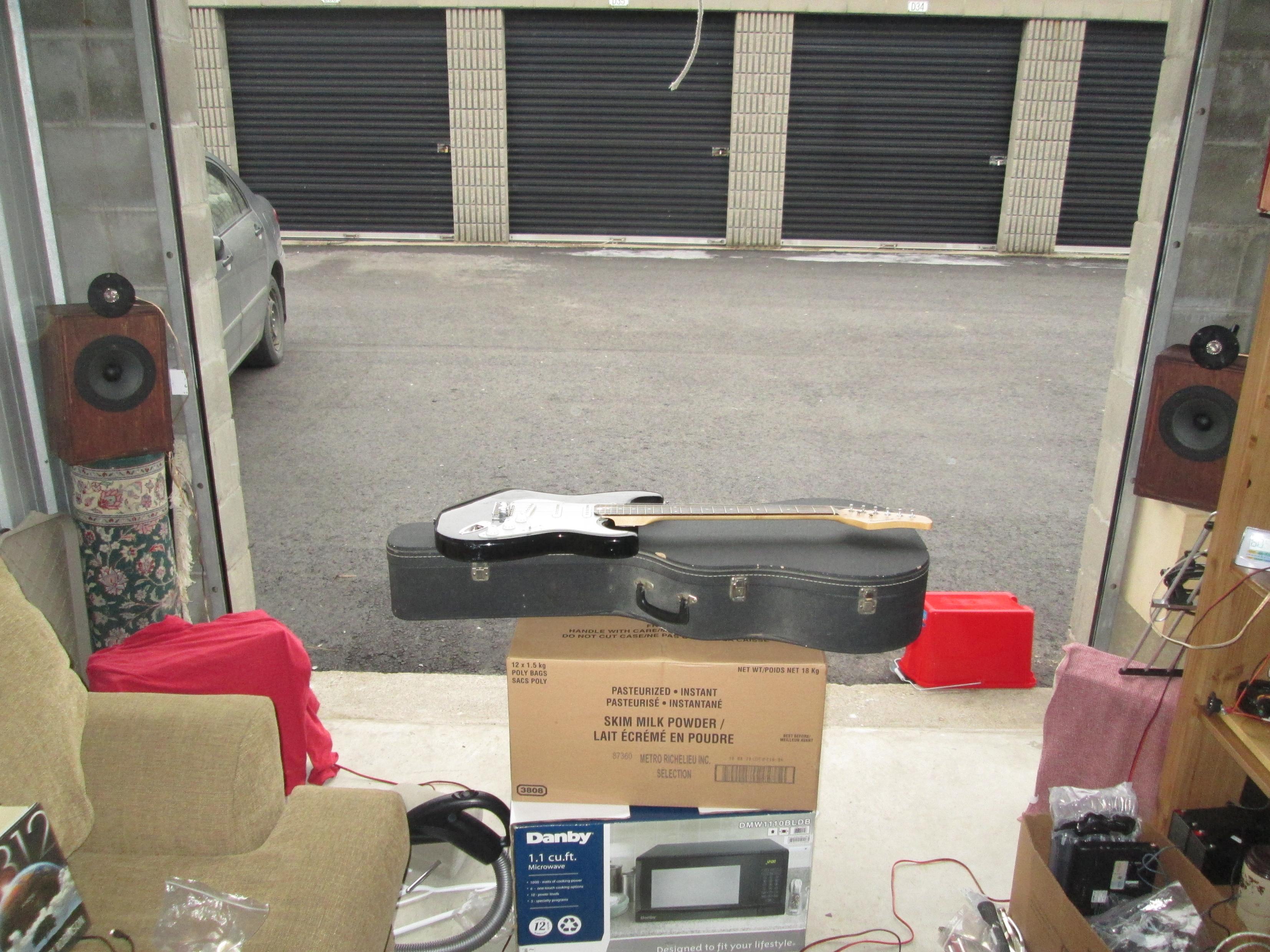

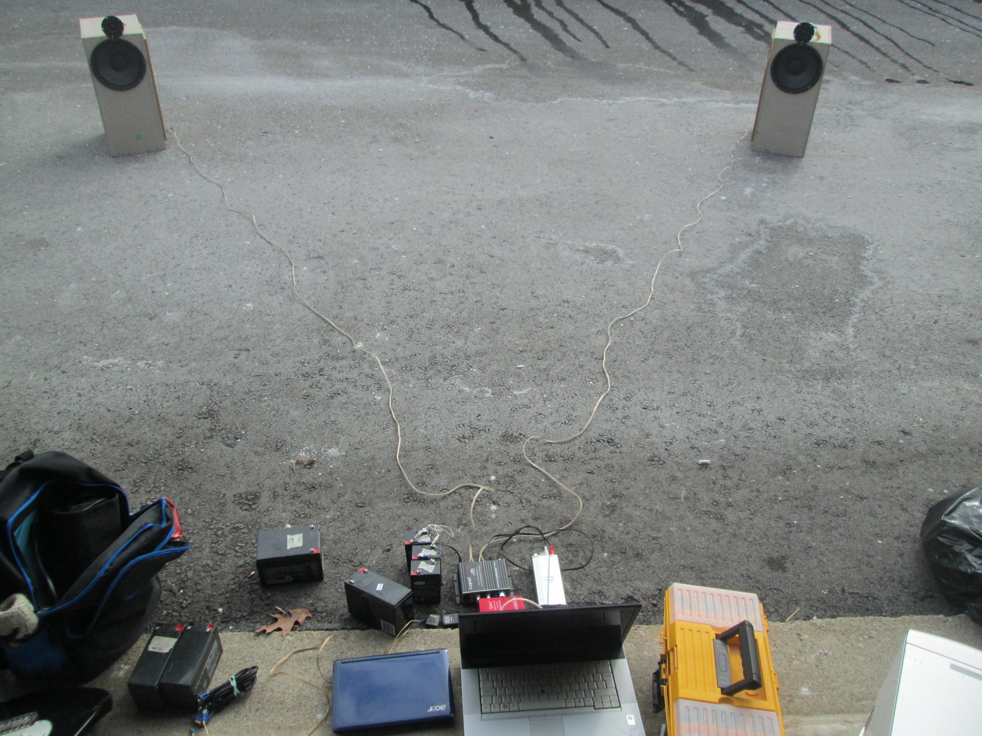

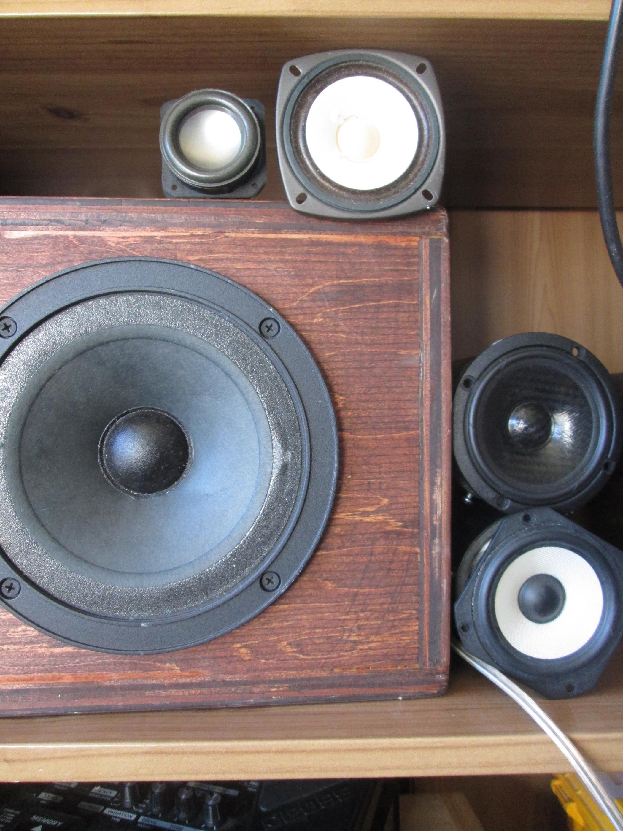

Ha, dude!
That's soo many centuries ago ...
I have no basement ... only ...
Storage!

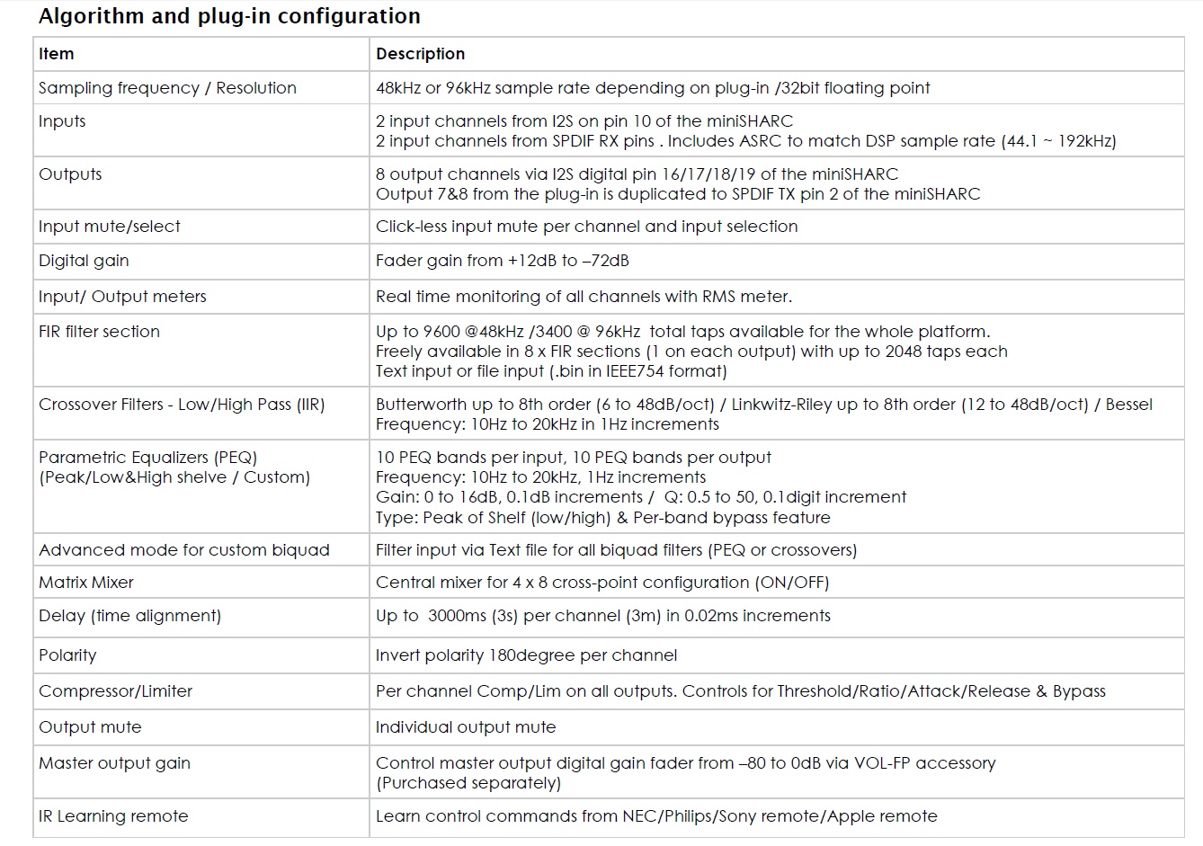

If you want real delay go miniSHARC
"Delay (time alignment) Up to 3000ms (3s) per channel (3m) in 0.02ms increments"
![miniSHARC.jpg miniSHARC.jpg](https://www.diyaudio.com/community/data/attachments/439/439176-8022dbd2e9c126d27db22ae9c98c262c.jpg)
PS and ... FIR

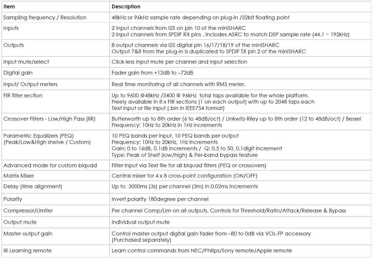

oh ya ... and:
![SHARCspec.jpg SHARCspec.jpg](https://www.diyaudio.com/community/data/attachments/440/440790-d032f82aa89500875adb96170b36a1d2.jpg)
Plugin:
96k/24
2x i2s in
2x spdif in
8x i2s out
2x spdif out (i2s 7, 8)
and ... achoo:
FIR filter section
Up to 9600 @48kHz /3400 @ 96kHz total taps available for the whole platform.
Freely available in 8 x FIR sections (1 on each output) with up to 2048 taps each
Text input or file input (.bin in IEEE754 format)
Crossover Filters - Low/High Pass (IIR)
Butterworth up to 8th order (6 to 48dB/oct) / Linkwitz-Riley up to 8th order (12 to 48dB/oct) / Bessel
Frequency: 10Hz to 20kHz in 1Hz increments
Parametric Equalizers (PEQ)
(Peak/Low&High shelve / Custom)
10 PEQ bands per input, 10 PEQ bands per output Frequency: 10Hz to 20kHz, 1Hz increments
Gain: 0 to 16dB, 0.1dB increments / Q: 0.5 to 50, 0.1digit increment
Type: Peak of Shelf (low/high) & Per-band bypass feature
