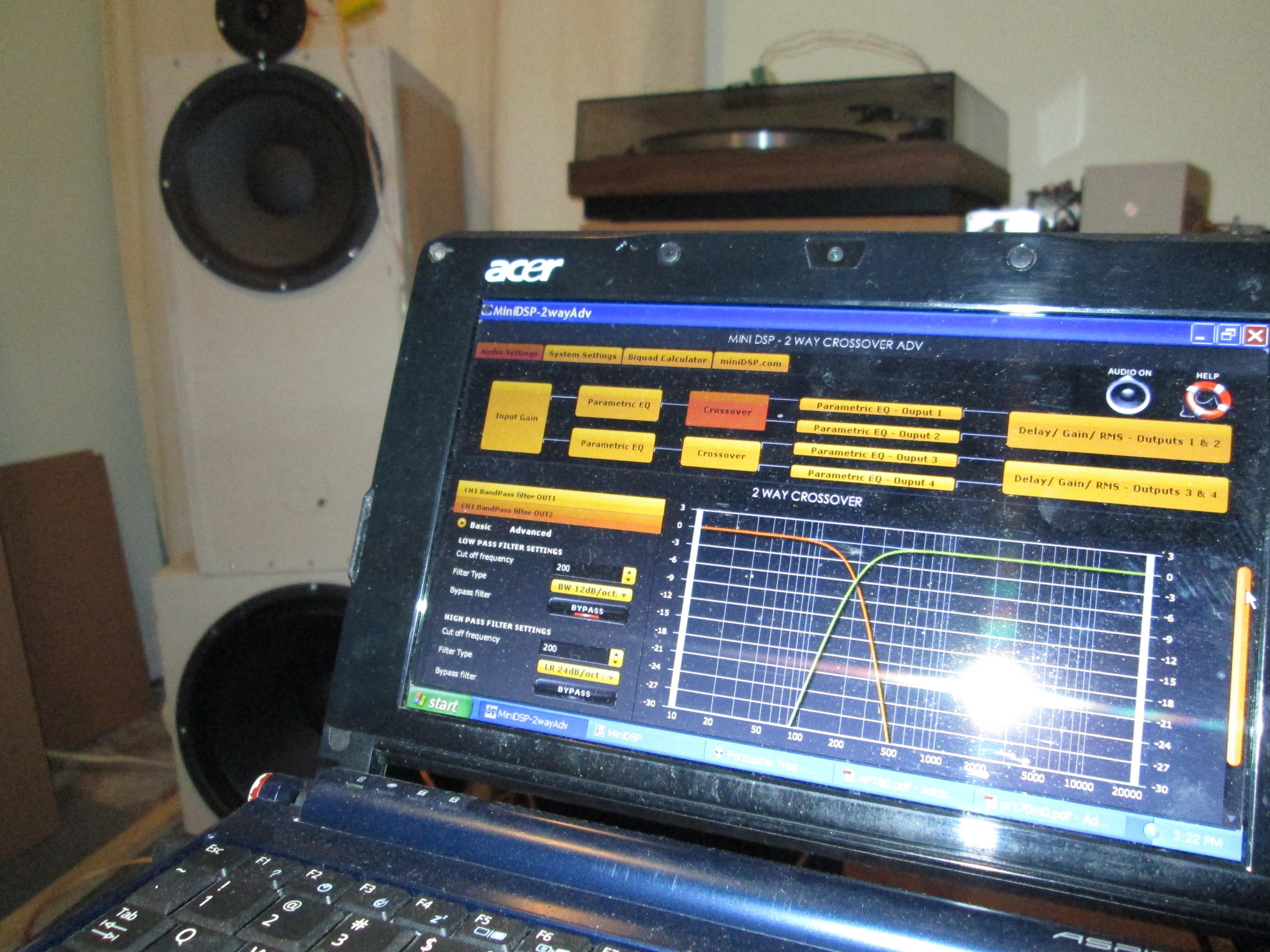

Howdy Folks,
For those still interested in controlling 2 or more miniDSP units from one PC, here's how I do it. Scroll down to section 3 for the description of that particular part of the project. And for anyone who likes to actually watch the sausage being made, here is the whole story of my current, somewhat goofy but wonderful sounding setup. (It does have a happy ending!)

Jim the Oldbie,
Thanks for the link. I guess Adobe Air is the platform miniDSP plugins are based on? I will give it a try but hope it doesn't wreck my computer. 🙂
https://github.com/chrisdeely/AirAppDuplicator
Jim the Oldbie,
You're welcome! I also hope it doesn't wreck your computer, of course. 🙂
Let us know how it works for you if you have time.
