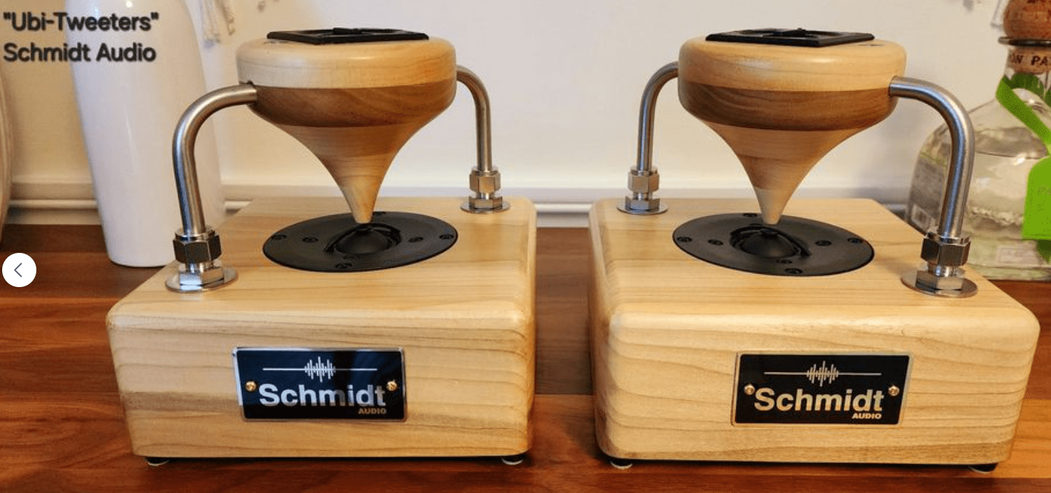

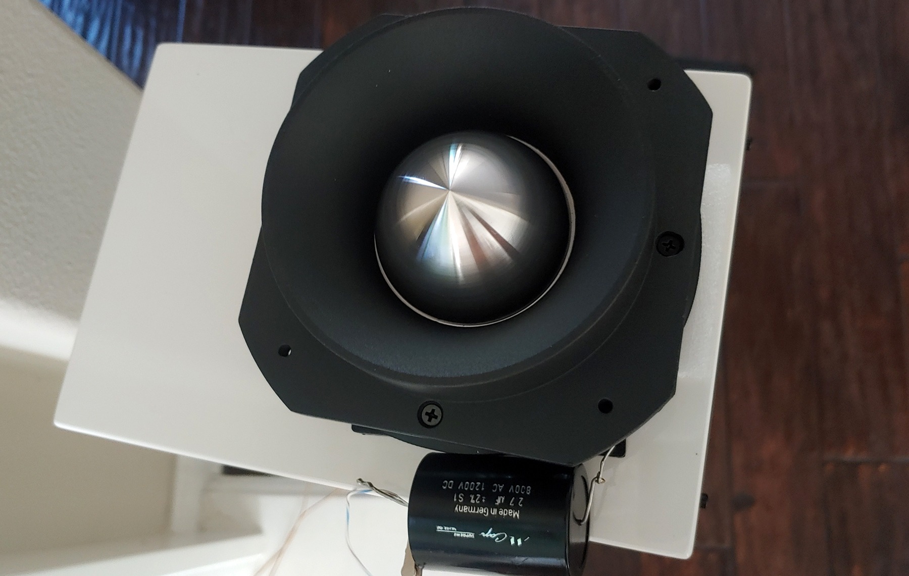

I've been truly impressed by these old, OG Pyramid JBL clones (when you can find them) firing straight up to the ceiling. When firing straight to the ear, you do notice their sound signature is different from AMT drivers, or actually any drivers like dome tweeters, etc, but once you fire them to the ceiling, all that goes away and you get a continuous walls of ambient air and sparkle.
Too bad one came with cheapo electrolytic cap and the other with cheapo MKT cap. Only large enough film caps I had laying around were some Mundorf Silver/Oils...😆

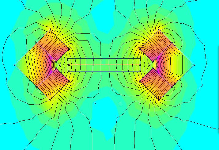

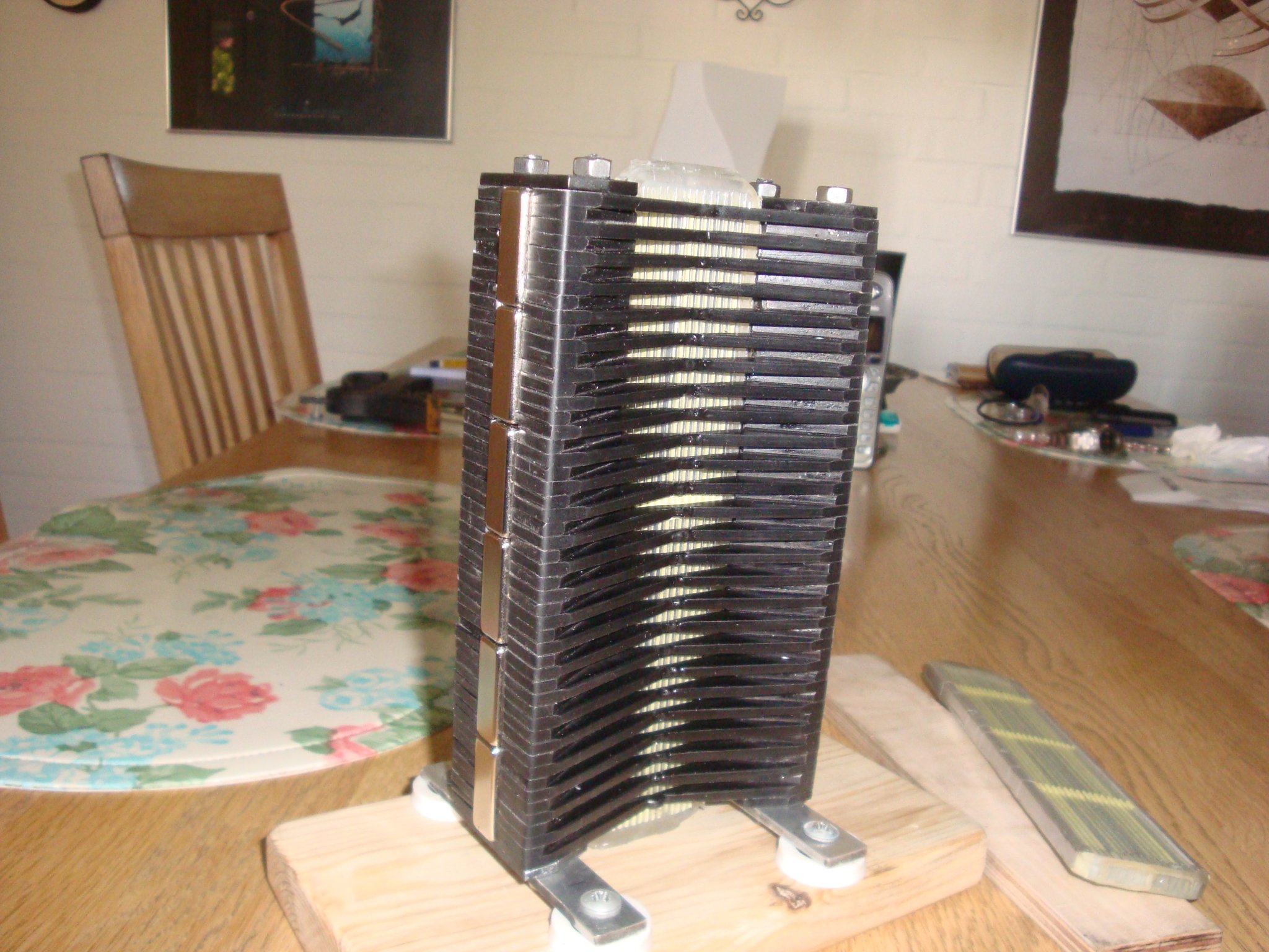

It is DIY and only magnets at the sides
That's what I was afraid of. That magnet alignment only works with the first few folds of the diaphragms on each side. Since the middle can't do anything (because of no motor, it's literally a huuuuge air gap), the few actual working folds are acting like separate tweeters. This will result in horizontal interference and also very low spl.
To fix it, at least run some ferromagnetic metal stripes horizontally on the front and back, touching the magnets.

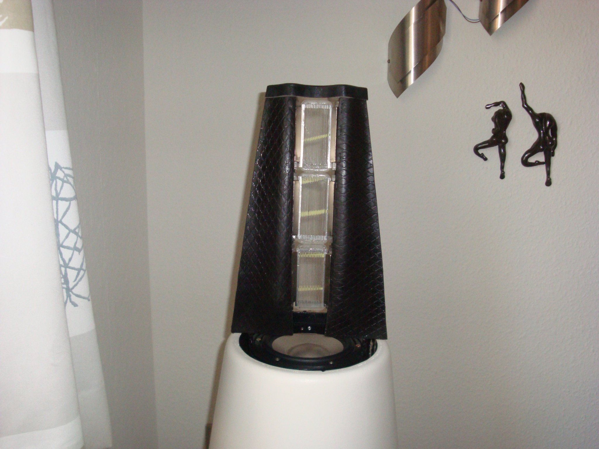

I send a picture of a n AMT i build that is made with 3 diaphragms .
I am very pleased with sound and sensivity .It playes down to app 600 hz.

If you look at a factory Heil they have "fingers" that extend, from the magnet structure, across the diaphragm and only leave a couple of the folds not covered. If you look at the DIY the 'fingers" are missing. That implies less magnetic flux interacting across the diaphragm surface where the "fingers" are missing. Ideally you want uniform flux density across the entire width of the diaphragm.
That's my take FWIW
Rob 🙂
That is right.

Hi is this model TW57 4 ohm ? Me too am looking for a nice sounding tweeter specifically to fire towards ceiling.Are those ESS Heil AMT drivers and magnet without the black housing?
Too bad one came with cheapo electrolytic cap and the other with cheapo MKT cap. Only large enough film caps I had laying around were some Mundorf Silver/Oils...😆View attachment 1343782
That's it. I don't think it's 4 ohms though. Specs say "4 Ohms to 8 Ohms impedance," and judging by which cap comes with it and how low they play, I suspect closer to 8 Ohms when calculating cap values. Just remember this thing weights 10.5 Lb and the square part is 6.25"x6.25" so make sure you have room.
This one comes with cheapo 3.3 uF cap, and that probably plays too low for our purposes. I would try 2.2-2.7 uF.. or even less if going for supertweeter territory.
