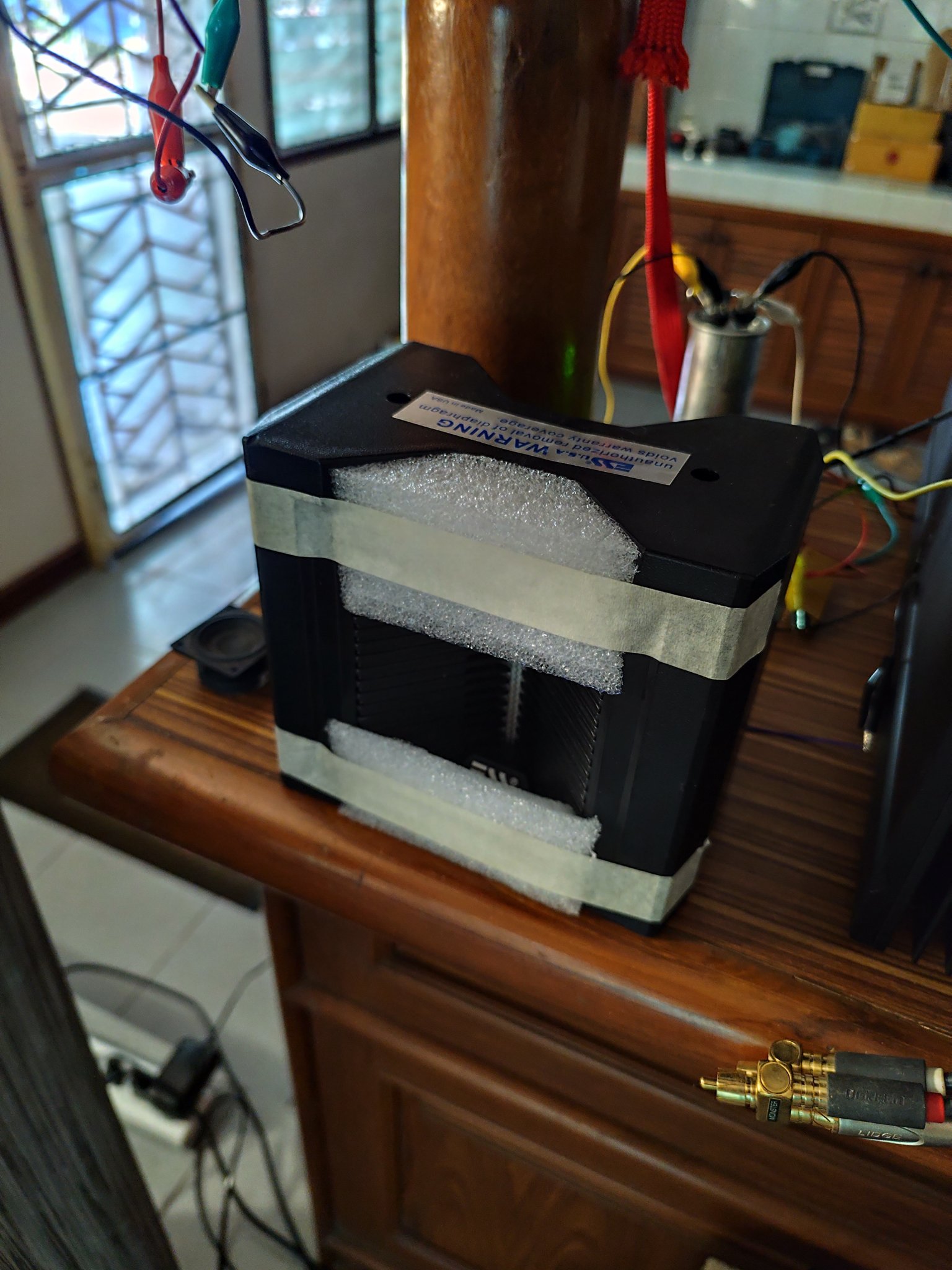

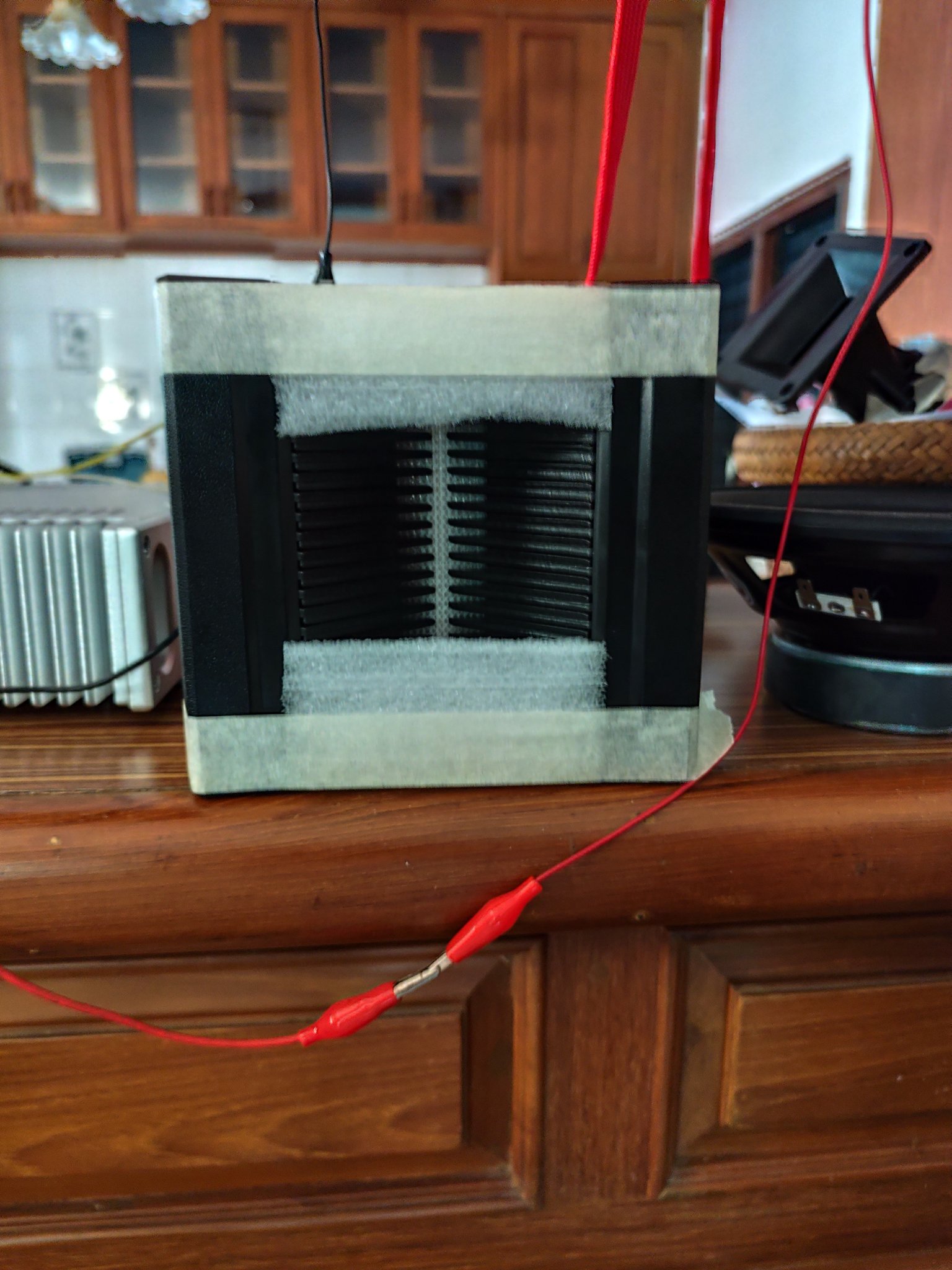

I played around a little more with the foam inserts and they really do wonders.
I read many times the Heils are hard to integrate because they are so fast that they don't blend well with moving coil drivers.....nothing apparantly is fast enough to keep up. But now I think it may be the dispersion that is the problem. With the foam inserts it sounds so much more coherent playing with bass and midrange drivers. Probably because the reflected sound is more similar due to the vertical dispersion being so much wider.
I still have to try other materials but maybe the foam is perfect. The lower the frequency the more acoustically transparent the foam is.....so it works where it needs to and doesn't where it shouldn't.

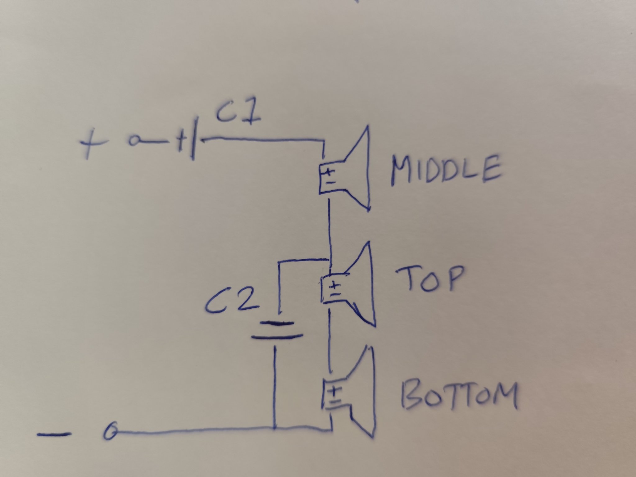

I would be very interested to see what power tapering does to a stack of three. Something like this:But that approach makes too much good sense. Not allowed.
With C2 at 2.2 or 3.3 uF
And then I would try foam inserts on the middle one.

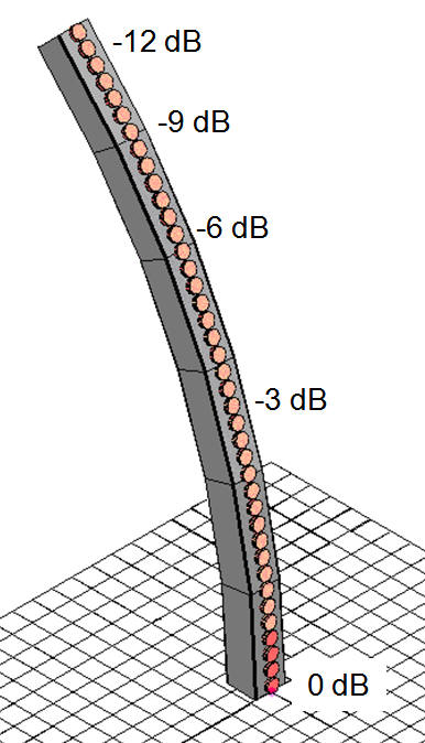

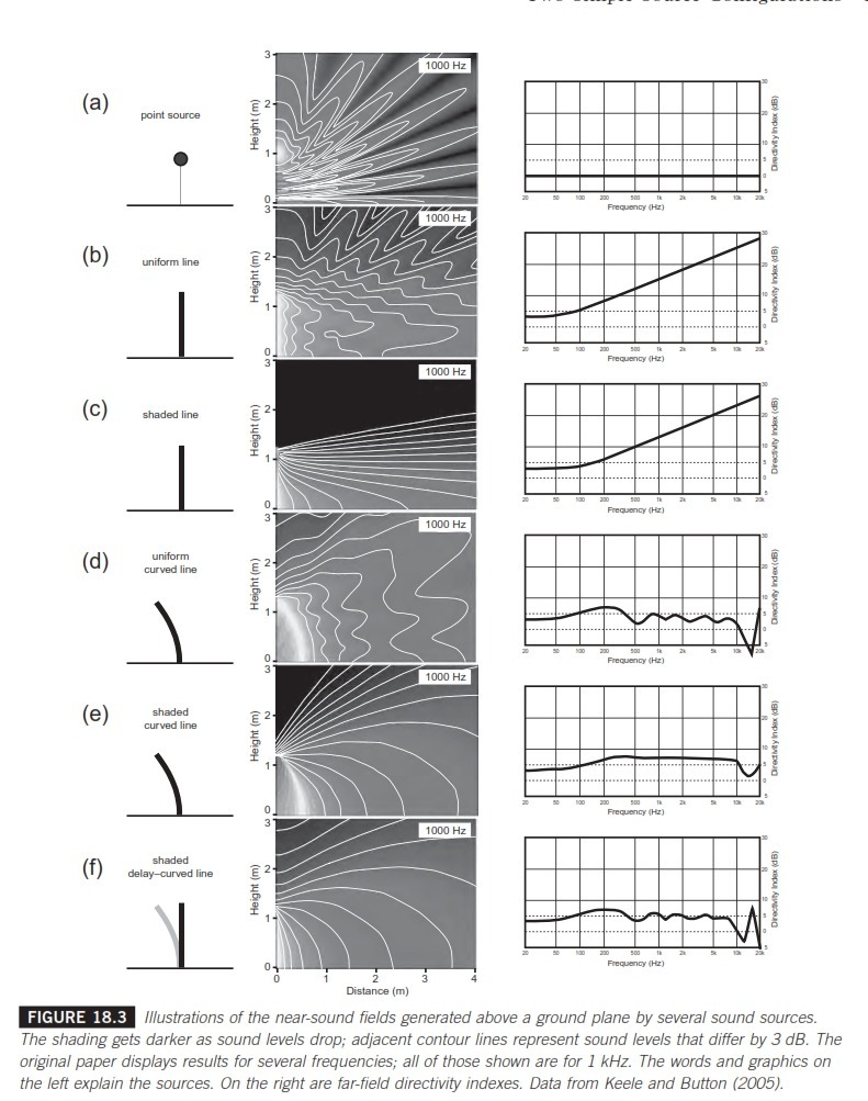

Recommend an experiment using the three-stacked AMTs, but instead using Don Keele's CBT idea, but simplified down to three elements instead of 42 drivers, inserting tapered spacers between the three AMTs to spread out their vertical polars, or alternatively, inserting delays in the top two AMTs via multi-amping to approximate a phased array (i.e., configuration "f" in the bottom figure):
Figures above from Don Keele's CBT webpage and from Floyd Toole's book, respectively. This basically solves the vertical polar coverage issue of the AMT design.
I use two AMTs stacked on top of each other, with the top AMT leaning backwards about 15-20 degrees via a wedge custom neoprene spacer, and the whole assembly placed on top of Belle Klipsch bass bins and dialed-in using a miniDSP 2x4 HD as my surround loudspeakers in a 5.1 array (fully horn loaded)--configuration "d", above. Solves the narrow vertical coverage problem of the AMTs.

What would be C1 value and what benefit would power tapering have?I would be very interested to see what power tapering does to a stack of three. Something like this:
For the CBT to work properly, you have to eliminate the reflection of the back dispersed sound.
Typically, I use my ears to inform me in these sort of questions. And I find that's actually more toward the realm of how the loudspeakers are being used (5.1 surrounds fairly close to the side walls, in my case) and personal preference.
YMMV.
Chris

Just ignore C1. That is only there if you run a first order passive crossover. C2 is just in addition to your passive or active crossover crossover.What would be C1 value and what benefit would power tapering have?
That's not a personal preference. A CBT works on the precise dispersion and reflection. If you add the back dispersion of a dipole driver, it will not deliver a CBT result, it's as simple as that. Maybe you'll like it, maybe you won't but that will not result in anything like the CBT was built for. I don't want to discredit the principle more than it already lacks in (bandwidth, horizontal dispersion, non-compability to other room shapes than rectangular, etc) but that dispersion does not come down to a 'matter of taste'

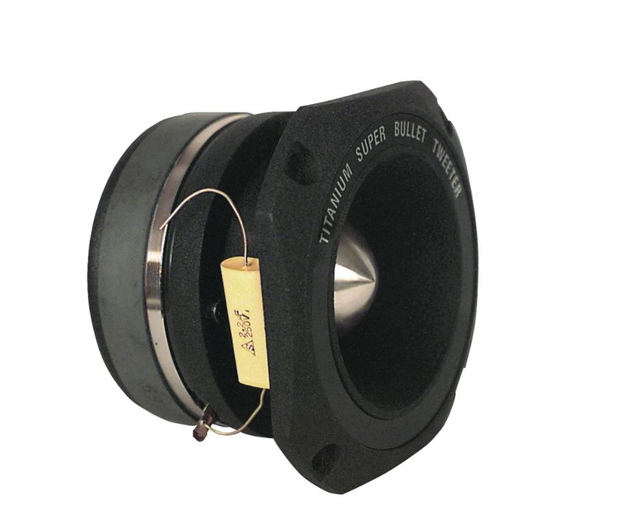

Post office found one of my bullet tweeters, so I plopped it on top of my home theater speaker to break in. Without any adjustments, using the included cheapo electrolytic capacitor as crossover, I am liking what I'm hearing so far. This bullet tweeter is making it sound like the front and side walls have become Magnepan-like speakers with ambiance and air!

One bullet tweeter is still "arriving late" per post office tracking with doubts as to if it will ever show up.

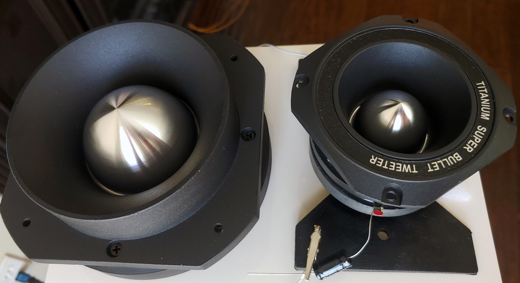

So I bought a pair of another Pyramid model. It's really difficult to find NOS pairs of these available, but when they arrived, I could not believe how large and heavy they are! They are solid blocks of aluminum, weighing more than 10 Lb each. It sounds different than the smaller one..
What is the model number detail of those ???
They look a lot like Pro JBL Bullets that have 'sooper-dooper' high efficiency but surprisingly little output above 18Khz.

The 075/2402 just kinda dies above 15K and turns into a flashlight beam. If you want extension above that you want 077/2405. All you have to do is look at the large format monitors none of them used the bullet.
And even a 2405 doesn't go higher just wider horizontal dispersion.
