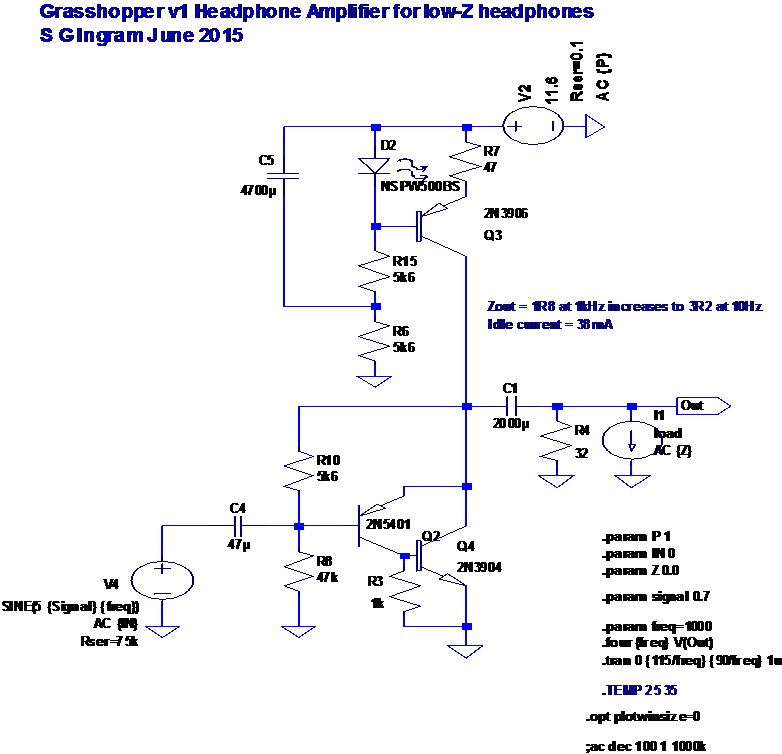

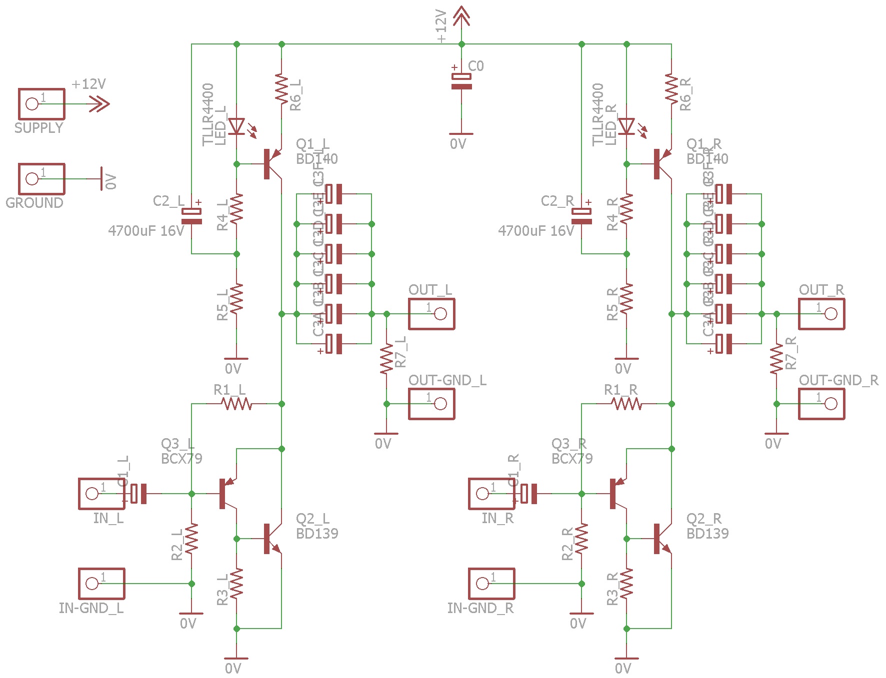

I ran the spice simulation for the circuit, of course it's 'just a simulation' but gives some grounds for optimism that the design approach is on-track.

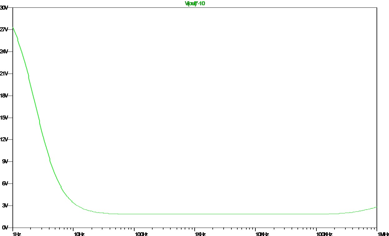

Output impedance (2nd attachment where the vertical axis reads 'V' but is is Ohms) is at 1R8, increasing to 3R2 at 10Hz, where damping factor will be at least 10.
Frequency response (3rd attachment) looks better than my ears.
PSRR (4th attachment) exceeds the design criterion.

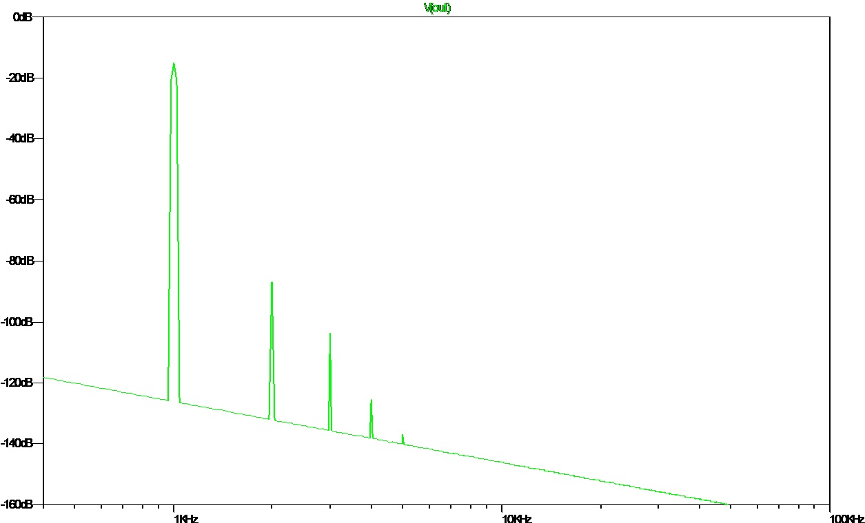

And FFT into 32R at 1mW (last attachment) looks tube-like nice. It is device model dependent and I may adopt a TO-126 packaged device for the build but I don't expect this to detract from a good result.

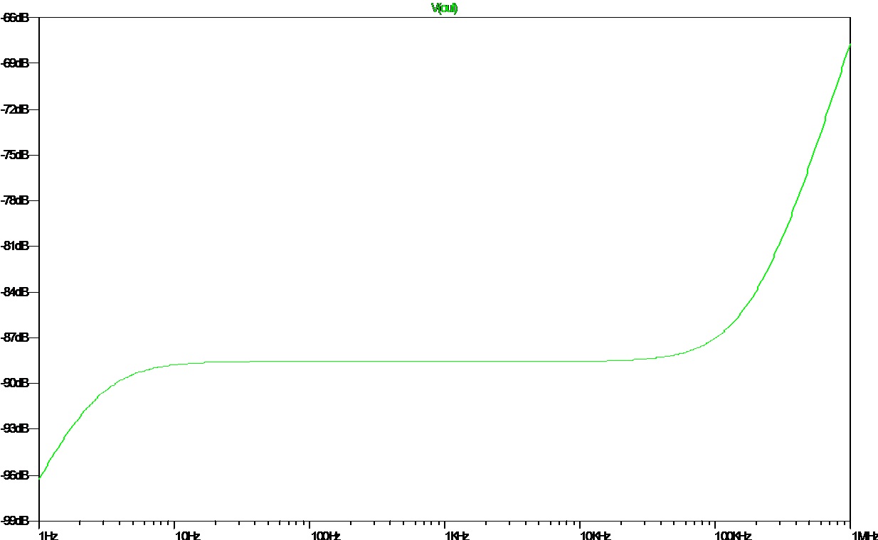

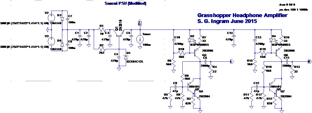

Anyway, whatever the problem is, I can't reproduce it here. I hacked the schematic into LTspice myself, and gain comes out as about -1.44 dB with stock transistor models... and that's mostly to be blamed on input impedance. Distortion at 1 Vp in: -66 dB 2nd, -74 dB 3rd, -85 dB 4th (improving a few dB on a low-impedance source). Good enough for FM, I say.

Good question ! - well, you see low gain in my FFT because I used the 'volume control' (i.e. high source impedance) to dial down the output. So the signal was turned into heat - poof !
I noticed that you used 1 Vpp which corresponds to more than 15mW (rms) at the headphones and I'm wondering if this is the right kind of signal level to be using for FFT analysis since I thought 15mW would be a 'how fast can I go deaf' plan ? - the Grado headphones will already be dangerous at 1mW and normal listening levels will be more like 100's uW where distortion will be negligible and mostly 2nd harmonic.
Interestingly and perhaps as expected, the distortion varies with the idle current. One might choose to 'dial in' the preferred sound through the use of an adjustable idle current. A higher idle current than I've selected could be used to drop the distortion further at high volumes. How low does the FFT need to go ?

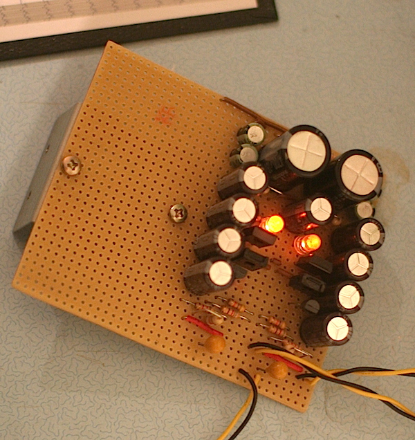

Attached: I've prepared a piece of Veroboard and a mounting bracket (taken from the Sansui amp) onto which the Grasshopper circuit will be assembled. I haven't used a proper piece of Veroboard for a loooooong time, so I'm looking forward to it !

True enough (my listening levels on 300 ohm HD580s tend to be in the 10s of mV), but it's always a good idea to look at maximum expected peak output, and that was about my ballpark figure for 32 ohm cans. Reaching 103 dB with a Grado SR60i would take about 0.4 Vrms (0.56 Vp), and that sim would have been for a more conservative 106-ish dB.I noticed that you used 1 Vpp which corresponds to more than 15mW (rms) at the headphones and I'm wondering if this is the right kind of signal level to be using for FFT analysis since I thought 15mW would be a 'how fast can I go deaf' plan ? - the Grado headphones will already be dangerous at 1mW and normal listening levels will be more like 100's uW where distortion will be negligible and mostly 2nd harmonic.
This is expected indeed. You can probably best see it with a plain CCS-loaded emitter follower. What happens is that transistor collector current is modulated by output current - a constant-current source being what it is, there is no other place for output current to come from. Now transconductance is inversely proportional to Ic, and its inverse dominates output impedance.Interestingly and perhaps as expected, the distortion varies with the idle current.
On positive peaks, collector current increases, and output impedance drops to a minimum. Hence that positive peak on the load will be a smidgen higher than it ought to be.
On negative peaks, collector current reaches a minimum, and output impedance reaches its maximum value. Hence the negative peak will get pulled down a bit by the load.
The result is that positive peaks become peakier, while negative peaks are flattened. Classic even-order distortion. Doing the math should reveal a dominant-2nd affair.
(Those who've paid attention may notice that adding some output resistance would be expected to reduce distortion. That's because we are looking at a voltage divider of 1/gm to the sum of Rout and Zload, so a given absolute variation of 1/gm as a result of given load current gives a smaller relative variation in load voltage. And in fact, add 32 ohms in series while doubling input amplitude, and distortion drops by about 6 dB.)
With a conservative well-behaved circuit like this, I might shoot for -60 dBr (2nd) / -70 dBr (3rd) @ 103 dB SPL out (0.56 Vp / 1.12 Vpp at the load in this case), 10 kHz. In your case that means 25 mA of idle current is the minimum. (The onset of clipping is just a few dBs higher up, so not too much dynamic range wasted.)One might choose to 'dial in' the preferred sound through the use of an adjustable idle current. A higher idle current than I've selected could be used to drop the distortion further at high volumes. How low does the FFT need to go ?
If you still want -80 dBr or better up there, however, it's more like 75 mA. 10 dB more idle current or 10 dB less signal, both cases amount to much the same here - dominant 2nd drops by 20 dB, 3rd by 30 dB, and so on. You can also calculate nth order intercept points and all that fun stuff from the RF world. Really predictable behavior as long as you stay a few dBs away from clipping. These are classic "you get what you pay for" circuits.

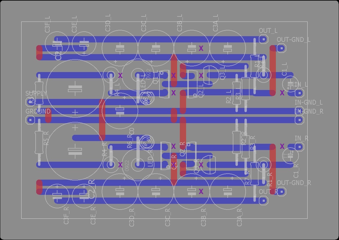

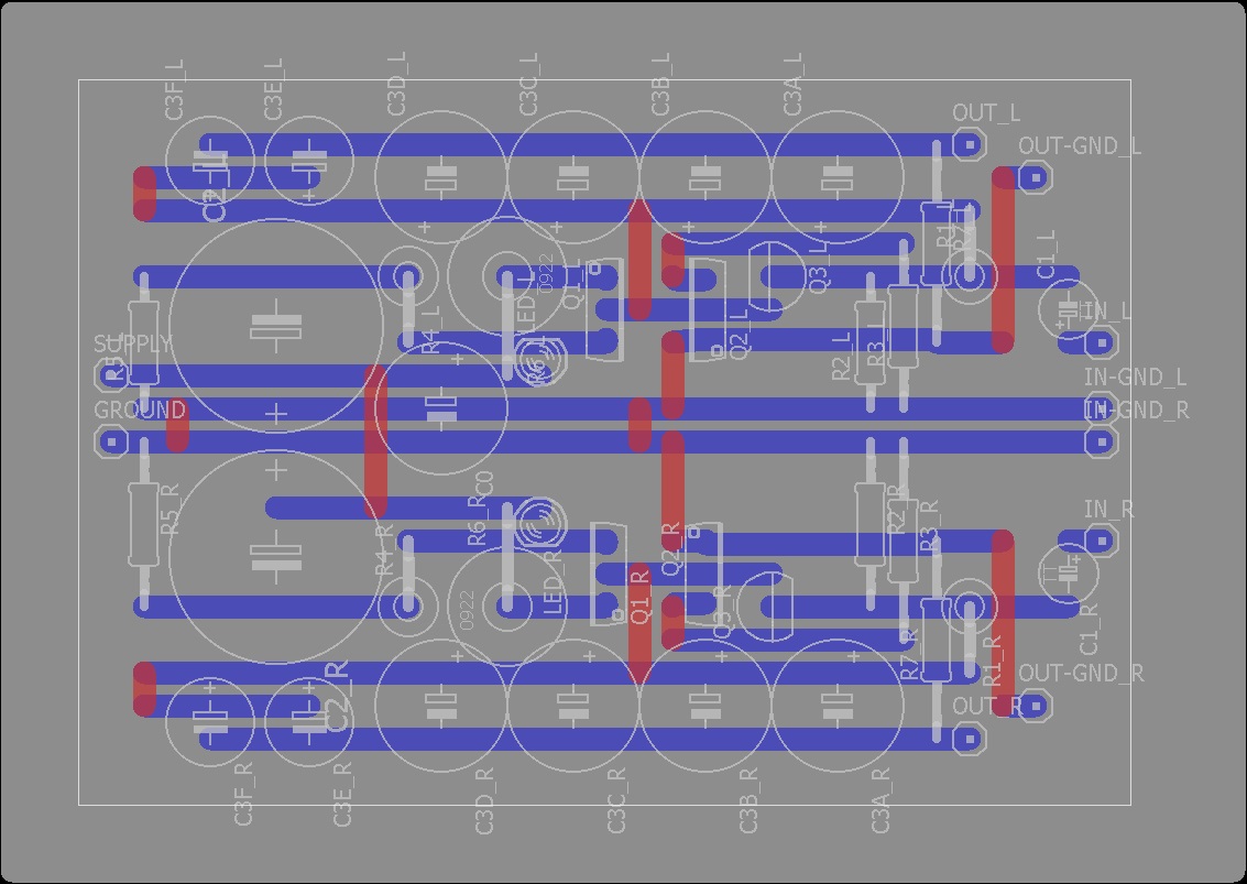

Attached - first attempt at a Veroboard layout

I have built up the Veroboard design. I ended up swapping the polarity of the input cap, it's not correct as drawn in the posts above. The values I used were:
LED - Fairchild bright yellow
R1, R4, R5 - 5k6
R2 - 47k
R3 - 820R
R6 - 18R (selected on-test to give current of 57mA per channel)
R7 - 8K2
C1 - 47u
C2 - 4,700u (takes a few seconds for CCS to start-up)
C3 - 4 x 470u plus 2 x 47u = total 1,974uF
C0 - 470u
Q1 - 2SA1142 (pnp)
Q2 - 2SC3423 (npn)
Q3 - 2N3906 (pnp)
R1, R4, R5 - 5k6
R2 - 47k
R3 - 820R
R7 - 8K2
C1 - 47u
C0 - 470u
Q1 - 2SA1142 (pnp)
Q2 - 2SC3423 (npn)
Q3 - 2N3906 (pnp)
Joined 2009
The power devices get warm but not hot enough to demand a heatsink. The bench supply shows 12V at 110mA total; voltage drop across R6 calculates to 57mA per channel - so good agreement there.
The dc bias at the input (base) of Q3 is 5.78V (left) 5.67V (right)
The dc bias at the output (emitter) of Q3 is 6.45V (left) 6.33V (right)
seems good there.
I added a 33R resistor load to the output of the left channel.

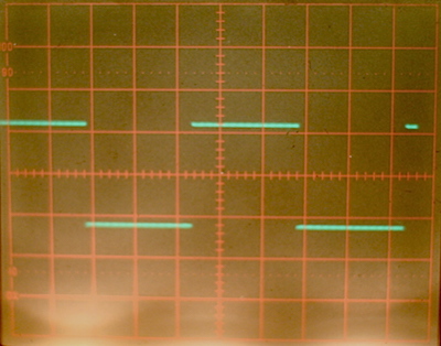

With no signal and shorted input I can just see some 'fuzz' on the oscilloscope with max gain (all knobs pulled out) which looks like +/- 100uV and represents all noise sources including my old O'scope so I'm not sure I have the means to measure the amplifier noise properly with my equipment.
Using the CRO probe calibration point, a 1kHz 0.5Vpp square wave - the output of the amp looks clean. The gain measures at 0.96.

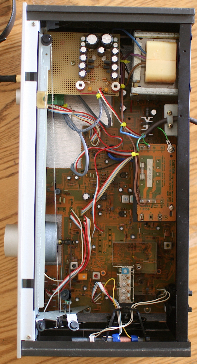

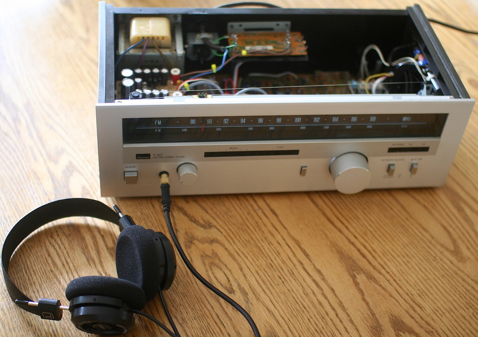

Joined 2009
Top view of the finished unit with the lid-off.
At the top right is the power transformer (transplanted from the A-40).
At the top left is the new Grasshopper headphone amplifier built on overboard. The two red bobbins with square holes are the output inductors.
Centre on the right-side is the mains fuse pcb (transplanted from the A-40)
Joined 2009
Here, attached, picture of the finished unit (lid off). On the left hand side of the front panel the new headphone socket and volume control (transplanted from the A-40) and the new Treble Cut switch just to the left of the large tuning knob.

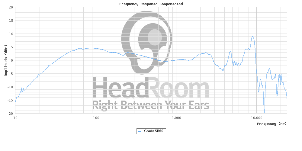

The box is closed and the unit is installed on my desktop at work. Reception is limited to strong stations due to short wire antenna (which will be upgraded) but I'm pleasantly surprised by the sound quality. Generally, I find that engaging the Treble Cut produces a more balanced sound with these headphones on 'popular music' channels.
Given the treble response of Grados (plus SR-80s being one of their brighter-sounding models if memory serves), I'm not surprised. Response with treble cut on probably is closer to some HD650s or similar "well-behaved" cans...
