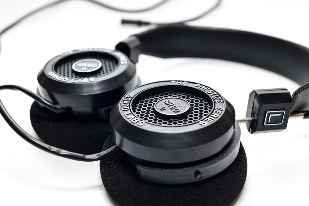

I just took delivery of some headphones. They have a low impedance of 32R which doesn't vary too wildly with frequency. It seems that they don't use a lot of voltage, line-level is enough. They will sit in their box until I have made something with my own hands to drive them.
I've never heard, designed or made a headphone amplifier before; time for Grasshopper to learn....

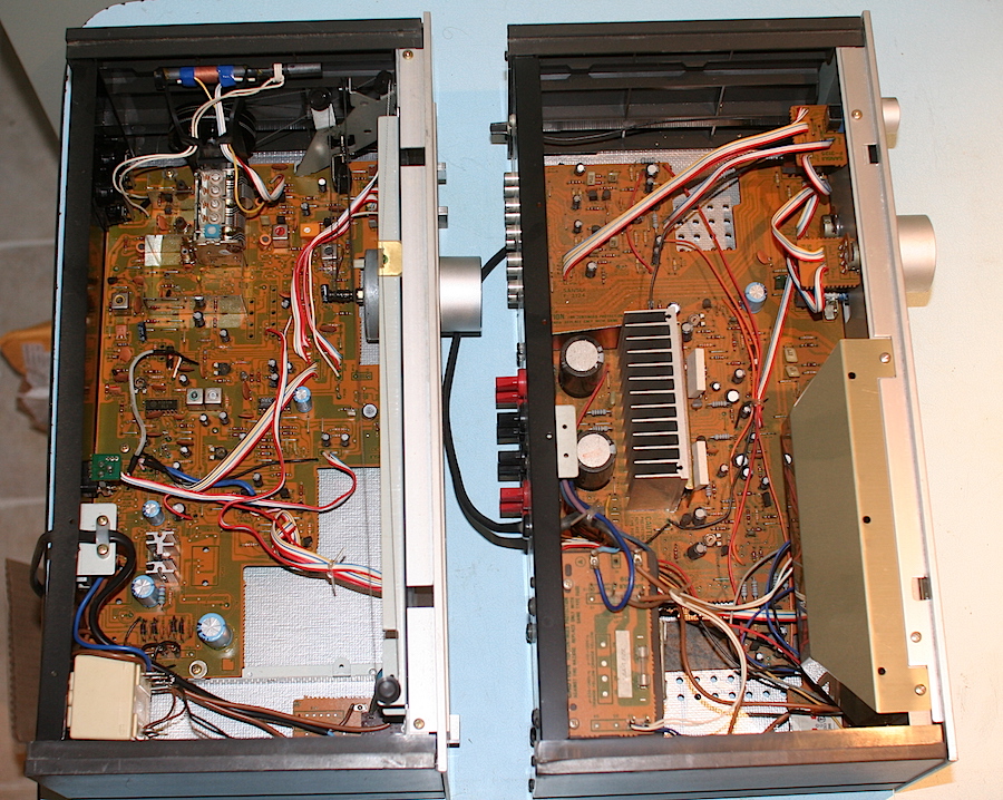

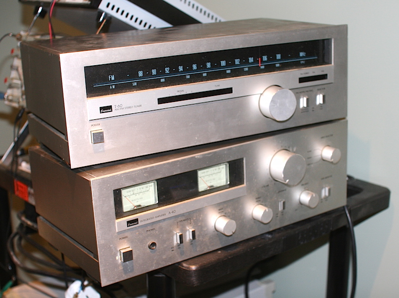

Pulled out two old Sansui boxes from the e-waste. A bit grubby, some scratches and dents. They're also originally from the UK and both wired into one mains plug for use with a voltage conversion transformer (for use here in Canada). I did find out who put it in the waste :shhh:
Taking off the lids I can see the Tuner is a nice old all-analogue design (T-60). It's low-end for Sansui but I see potential and will plan to use this as a source for the headphone amplifier. The Sansui power-amp (A-40) isn't so nice, undersized heatsink, standard 1970's topology and a lot of other bits in the signal path. The headphone amplifier will go into the tuner box, seems to me there's space for it alongside the guts of the tuner.
Because the tuner is equipped only to run on 240V I'll not be able to use it as-is, so I'll transplant the power transformer from the Power amp into the Tuner, which when used on my 120V mains will give me a useable voltage for the tuner. I see a few other bits I can transplant across including a headphone socket, a push-button switch and a volume control that will be needed for the headphone amplifier and what's left of the power amp will go back in the e-waste.

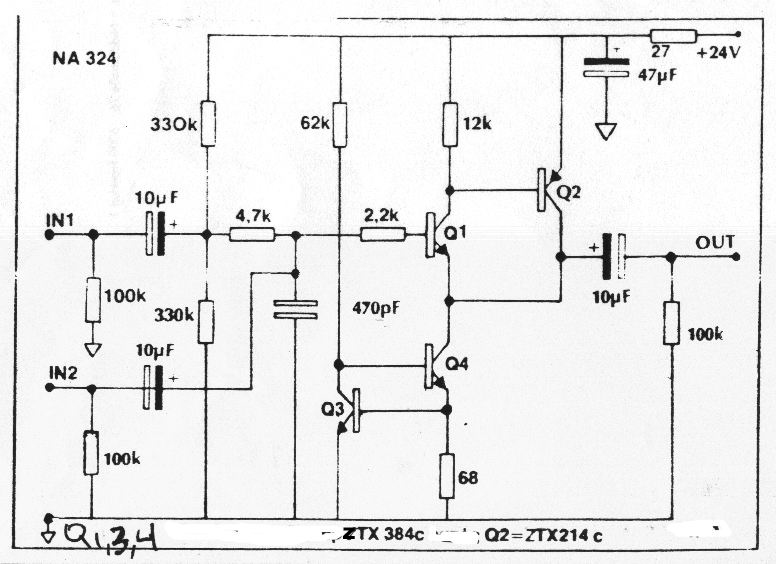

I read through the DOZ as a headlamp article - very good article. Seems that it is still over-kill for the power I need. But it linked another article for a lower power circuit (project 37). It's single ended class A based on the DOZ but with the upper output device configured as a current source.
A bit more searching on the net turned up another very similar design which was attributed to NAIM (attached). Looks like I could get high input impedance, low output impedance and low parts count for ease of build. Is it too simple ?
Edit: thanks Counter Culture, just saw your post. I'm not sure how much sophistication I should aim for first time around, perhaps a simple discrete circuit will get me started before I try something with servo's etc.? I've built a few power amps with discreet parts but I've never made anything with an op-amp yet and don't have any in my parts bin either.

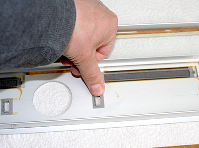

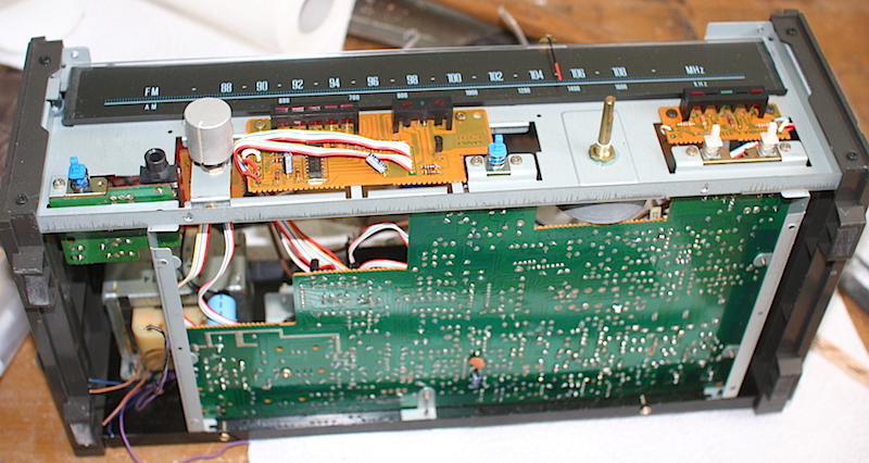

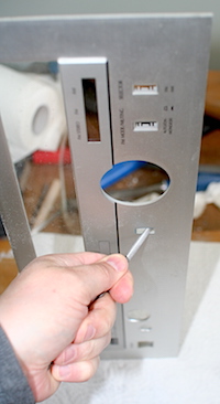

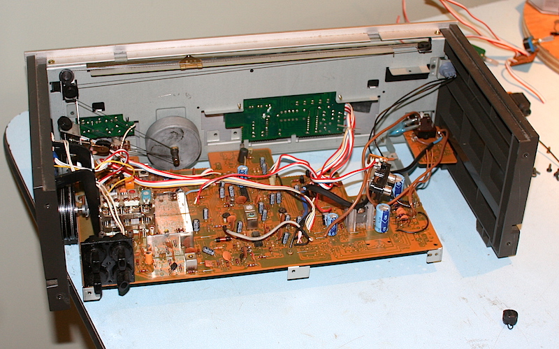

Some more progress on the box. I've pulled it apart to start drilling holes in for the new power transformer, transplanting of a small pcb with power supply fuse on board and making holes in the front panel for the headphone socket, volume control and selector switch.

The extra switch, volume control and socket for the 'phones are now in place. Power transformer is hooked up.
Old rectifier diodes replaced by soft-recovery types, power supply electrolytic caps replaced with new (KME and Nichicon). A safety earth and new power cord fitted. Output caps and various power rail decoupling caps replaced with new. Mains switch and mains fuse installed on primary side of transformer (original tuner was switched on the secondary).
Front panel finished up but not installed yet.
It's coming along.

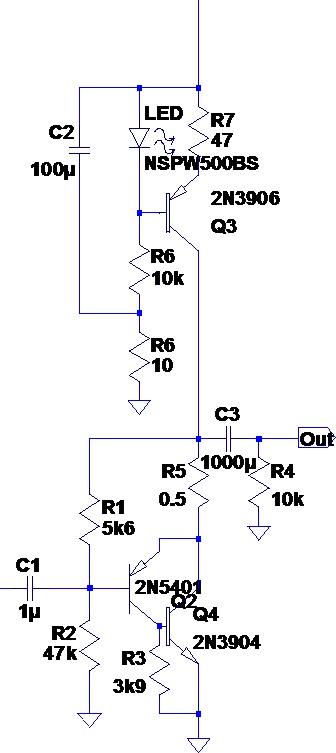

What about this approach, not necessarily novel but appears to meet all the needs. A CFP emitter follower suspended from a current source. PSRR is excellent, linearity is good, output impedance is <3R.
Assuming you can get input impedance high / linear enough and dissipation is under control and power draw not an issue, that should work. 0.7 Vrms into 32 ohms means at least 30 mA of standing current, the more the merrier, so that may be pushing things a bit for TO-92 with a typical 13 V supply. I'd definitely be looking at what kind of heatsinking the regulator pass transistor has right now (and what sort of current the reg can supply anyway), and beef that up if needed.
Also keep in mind you'll need a clean ~+Vs/2 (-ish) reference. R/RC divider with series R should do the job.
For a minimum of fuss, a unity gain follower with an NJM4556AD (or two combined via 2.2-ish ohms) isn't too bad really. ~9 mA idle for both channels.
Good point! I checked - the original unit was expected to produce 25V dc after the rectifier, then get dropped to 20V by an RC filter and then to 12V across the regulator pass transistor. The pass transistor would see an 8V drop across it and is a TO-220 bolted to a decent vertical pcb-mounted heatsink. It seems it was designed to be happy at 0.8W because I measured a current draw of around 100mA. With my modified power supply the pass transistor experiences a smaller voltage drop of 5.4V so for the same power dissipation I can draw 185mA, or 42mA per channel for the headphone amplifier.
I will bias the input transistor as you say with a divider but no filter C is needed because this is a unity-gain follower so I can run the divider off the amplifier output to ensure the bias is free of power rail noise. In this way there is also some bootstrapping so I don't have to use excessively high valued resistors for the bias chain in order to maintain a suitable input impedance.

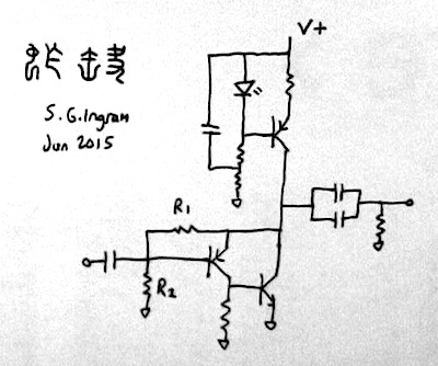

I still don't entirely see how this would work (reliably). The circuit is essentially a fancified emitter follower whose DC voltage levels need to be defined somehow. I suppose you could use input transistor base current to generate the needed offset, but that's not exactly the definition of thermal stability.
I hope the attached drawing will help explain my idea. There is a resistor potential divider made from R1 and R2. The current flow through R2 is 4 or 5 times larger than the base current into the input transistor so current gain temperature dependence should be limited. And with cap-coupled output there isn't a problem if the dc-level shifts around by a volt or so over normal operating temperatures. I ran a spice simulation using the TEMP command and the idle current through the totem pole has a slight negative temperature dependency (safe) - if the device models are correct of course.
The voltage at the base of the input transistor is set by the voltage drop across R2, i.e. V(base) = i x R2
The current through R2 is set by R1. The voltage drop across R1 is the Vbe of the input transistor which is around 650mV for a silicon bipolar transistor. If I choose R1 then the current is i = 650/R1 mA.
Say R1 = 5k6, then i = 0.116mA
And so a value of R2 of 47k would give V(base) = 0.116 x 47 = 5.45V
And so the voltage at the amplifier output is = 5.45V + 650mV = 6.1V which is roughly half way between the power rail and ground.
What do you think ?
