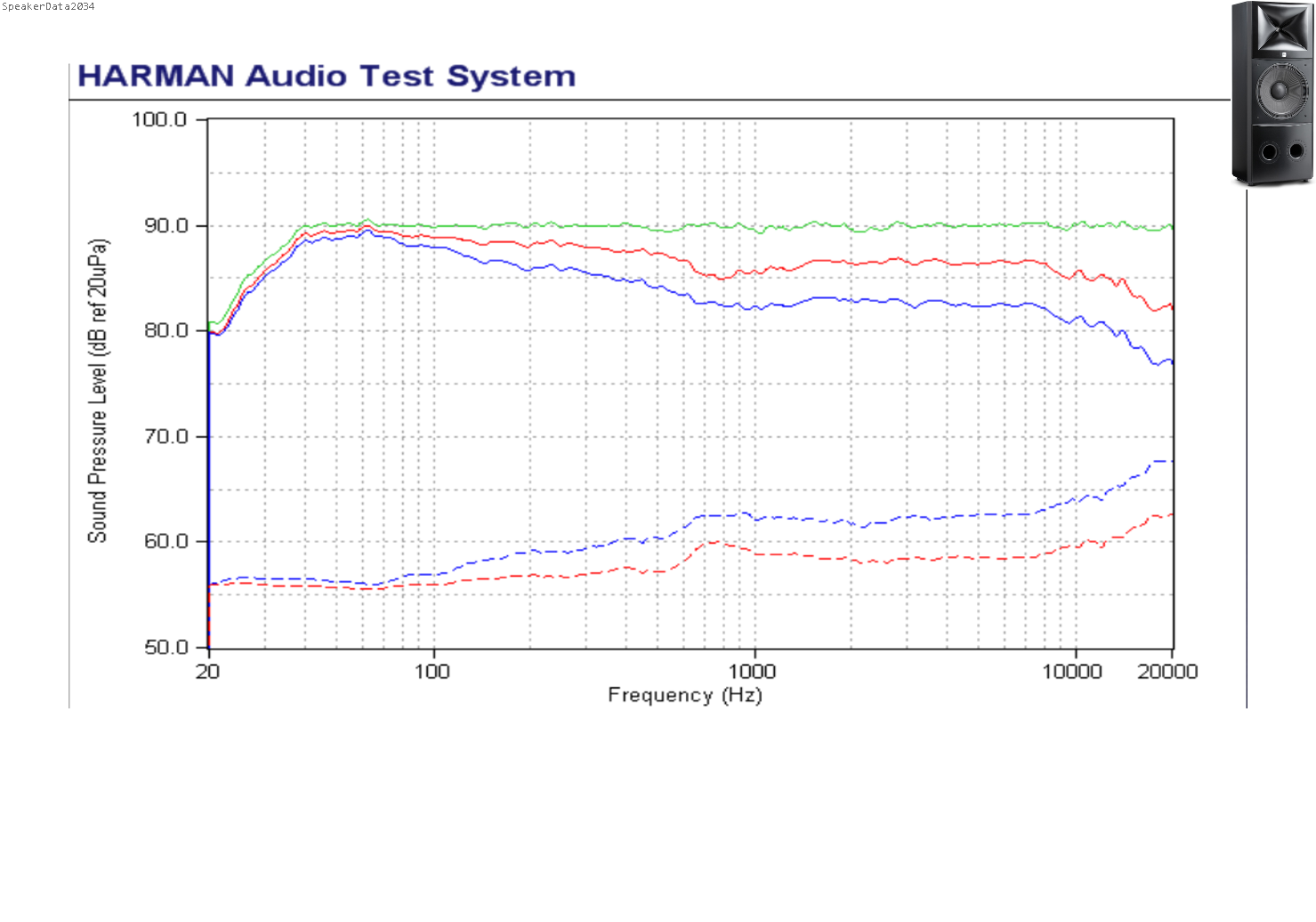

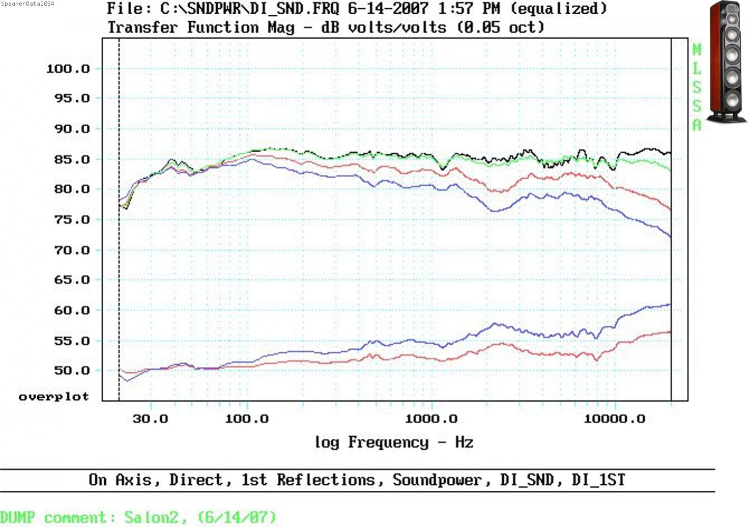

Floyd Toole made some relevant comments on the waveguide vs waveguide shootout:
Why is it waveguide vs waveguide not waveguide vs direct radiator? Because the Revel Salon2 uses a waveguide at 2.3kHz.
1) Speaker measurements matter in predicting performance. Good measurements backed up by double blind listening tests by the manufacturer = good speakers.
"First let me say that I am greatly reassured by the result: two truly excellent loudspeakers were judged to sound as good as their measurements suggest they should. In the global context of loudspeakers both are in the highest category. I regard it as a minor breakthrough that; (a) measurements were acknowledged as having meaning in terms of sound quality, and (b) doing listening tests blind was recognized as allowing one to form opinions free from non-auditory influences. None of this is new, but only a tiny minority in the audio community have bothered to read at least some of the existing science." - Floyd Toole
2) Revel's waveguide controls above 2.3kHz while the M2 controls down to 800Hz. The JBL 305P Mk II waveguide (& the 708) starts controlling about 1.7kHz.
"Early reflections are the dominant room interactions above 500 Hz and this may be the most significant difference between these loudspeakers – directivity. They are quite close, but the Salon2 will energize more far-off-axis early reflections than the M2. For laying down tracks and mixing many engineers discourage room reflections, even use “near field” monitors, although mastering engineers often prefer to hear some “room”. I discuss this in some detail in the book, and it is clear that “one size does not fit all”. Some evidence points to hearing loss (an occupational hazard in pro audio) as one factor causing professionals to prefer simple, reflection-free, sound fields." - Floyd Toole
The key thing to understand is these different speakers all sound good when used within their design parameters. The reason they're good is because they track directivity patterns that earn high listener ratings in double blind tests. At this point someone might think I said *only* these directivity patterns sound good but that's not what I said. These JBL/Revel directivity patterns predict good performance. Good performance isn't restricted to their directivity patterns. But, thanks to science, buying good speakers is easy today. You can buy a speaker online and know it's going to be good as long there wasn't a defect during manufacturing.
A secondary issue relevant to DIY audio is there's no waveguide vs direct radiator dilemma.
