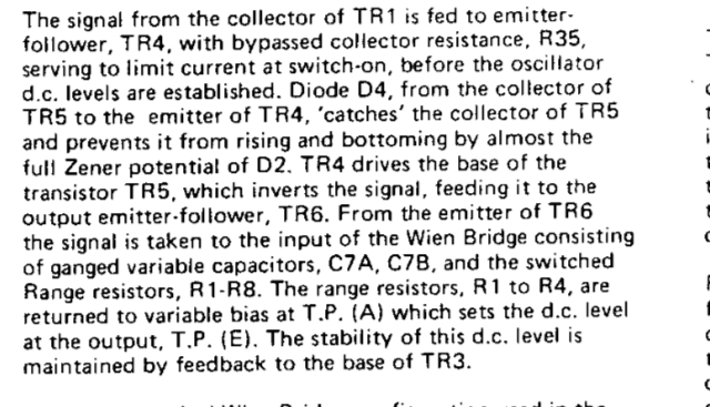

The reason I think there may be a problem in the oscillator is the section in the service manual that says that D4 is supposed to stop rail to rail sticking?

Indeed, there seems to be some sticking mechanism in play, though it may not be debilitating given that eventually a clean sine wave appears.
D4 should prevent TR5 from being driven into saturation and should begin to clamp base drive to TR5 when the emitter-collector voltage is driven within roughly 3V of saturating--- hard to be precise. You may be able to provoke this mechanism for steady-state examination by adjusting R34 for increased amplitude. Maybe you can capture some scope pics if there's any remaining mystery.
