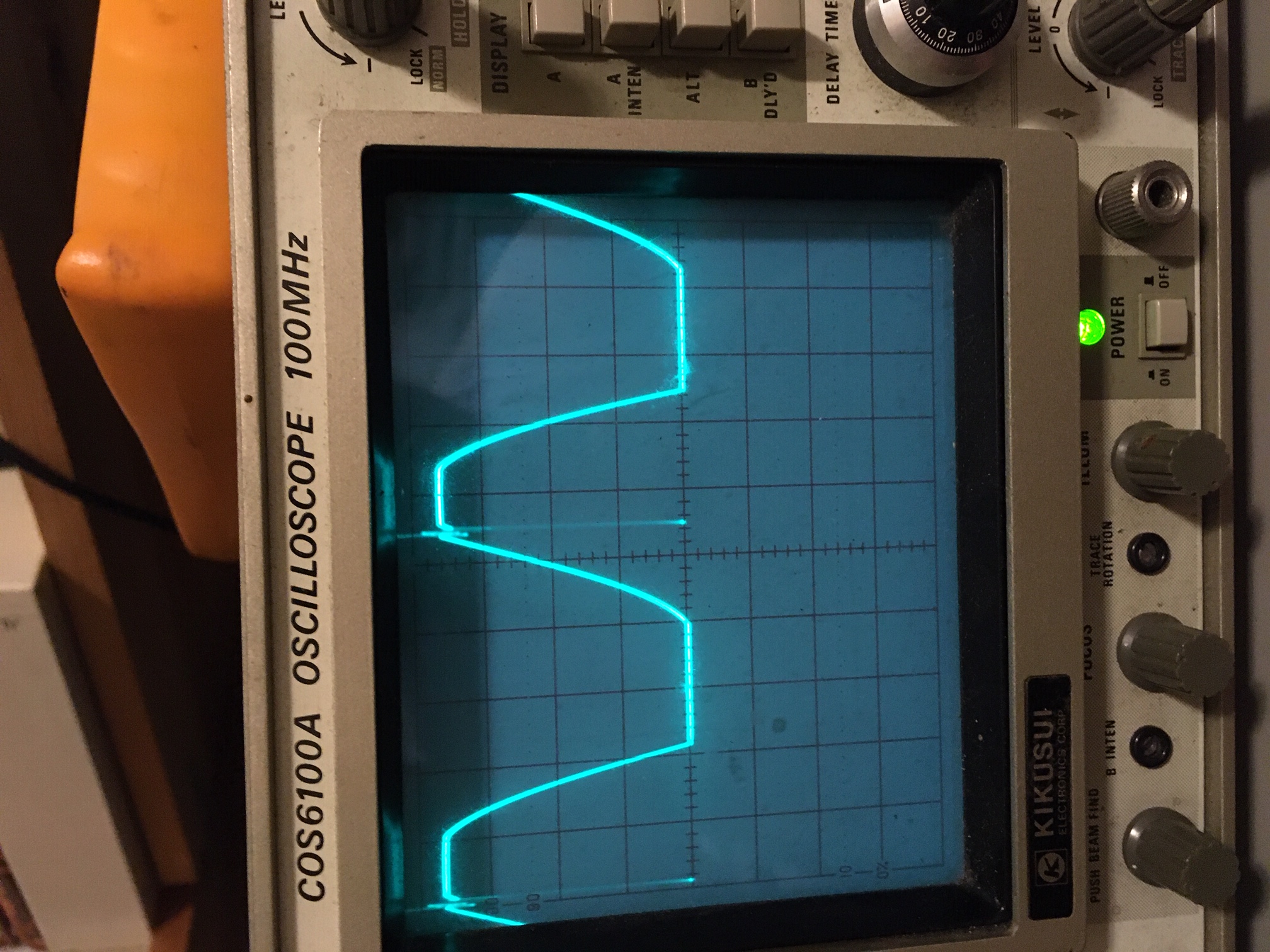

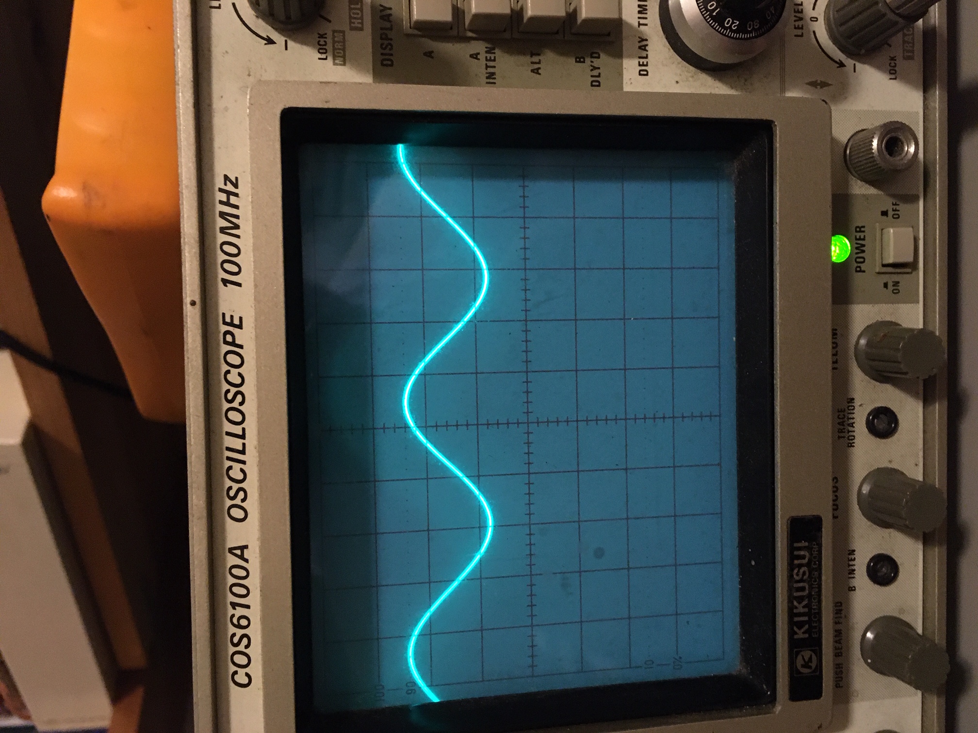

The sine wave in the first photo appears "thick." Is this a high frequency oscillation riding on the oscillator output? Is this the distortion you mention? If the output amplitude is set to 0 via the level pot (R10) and the oscillator is measured at the top of R10, is the oscillator then clean?
Would you provide details about the test points being probed in your photos? e.g. What points in schematic, volts/div and time/div. BTW, I also advise using x10 scope probes to minimize load capacitance when probing internal test signals.
Good luck!
It is, the second photo is that of the "thick" sine wave in the first photo zoomed in using the scope.
The test point is as advised in the service manual and is clean and showing the right amplitude ( about 8V pk-pk) both when the power amp is disconnected ( i.e. just the power wire connected ) or if R10 isn't turned up high enough to cause the oscillation.

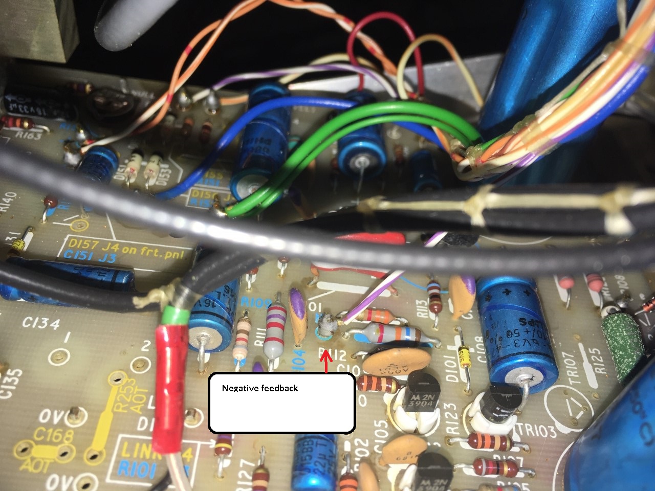

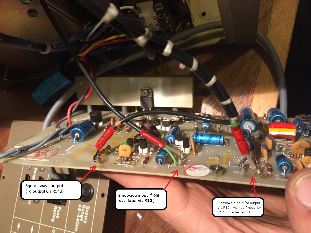

So if I'm interpreting correctly, the signal behaves reasonably until sudden onset of higher frequency oscillation.
To take a super wild guess with scant evidence, I'd suspect power supply bypass defect and would look for supply misbehavior at onset of oscillation.
Assuming your scope is dual channel, I suggest the putting oscillator test point on channel 1 and using channel 2 to poke around for sudden appearance of the spurious oscillation on the supply rail. Supply ripple should be only few mV, I think. If ripple seems suspicious, failed cap might be the culprit.
If supply looks ok, poke elsewhere for clues and keep us posted. I can suggest additional experiments if problem not found.

Thanks for your suggestions, I shall probe the power supply rail and see if there is an overload.
Your surmise is correct but I think that increasing the output increases the oscillation riding on the fundamental, becoming very obvious at full output. I think I see the line thickening as I turn it up.

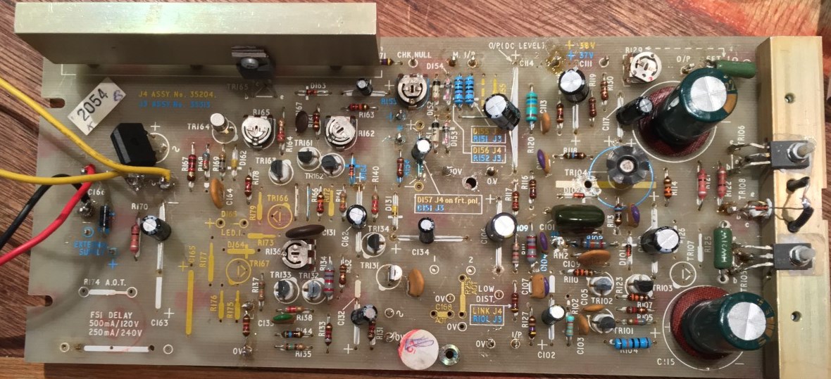

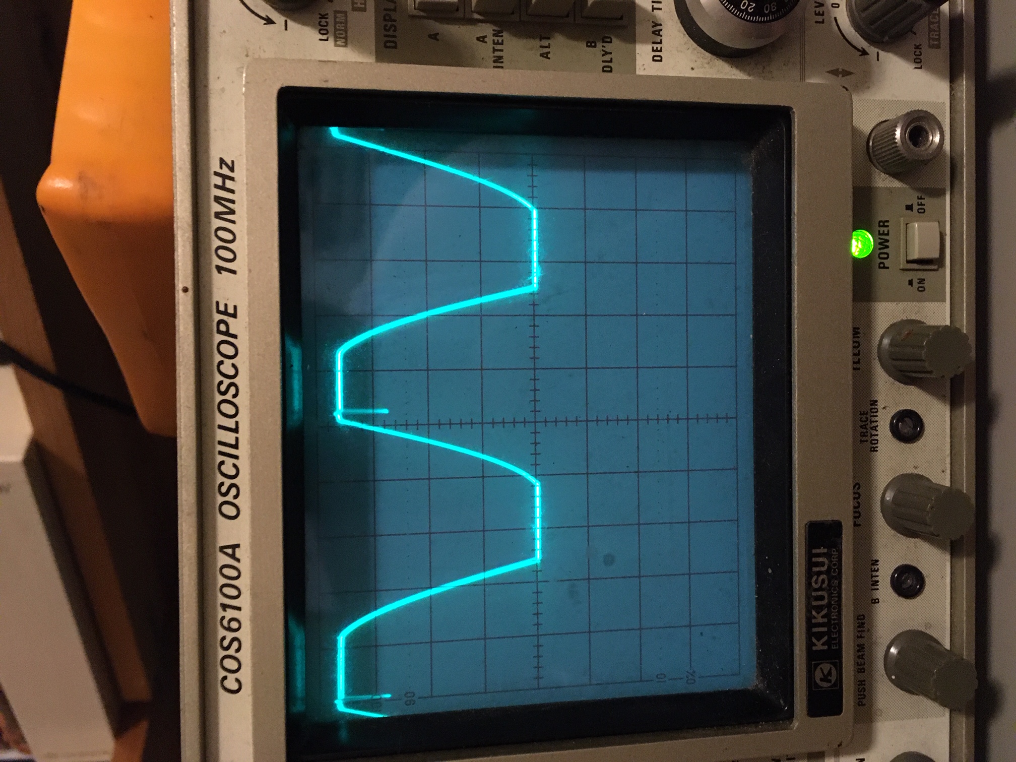

Also, something that might be relevant.
In the service manual it says that when the 'scope is connected to the test point and power applied, the oscillator should build up, die down and then build up again.
It does not do this, on the scope DC builds up in one direction and then in the other. then a very clipped sinewave is produced which seems to be at rail voltage peak to peak.
This clipped sine wave, almost a square wave, has a nasty spike at the top of the leading edge.
I'll try and get a photo of it with the digital 'scope.

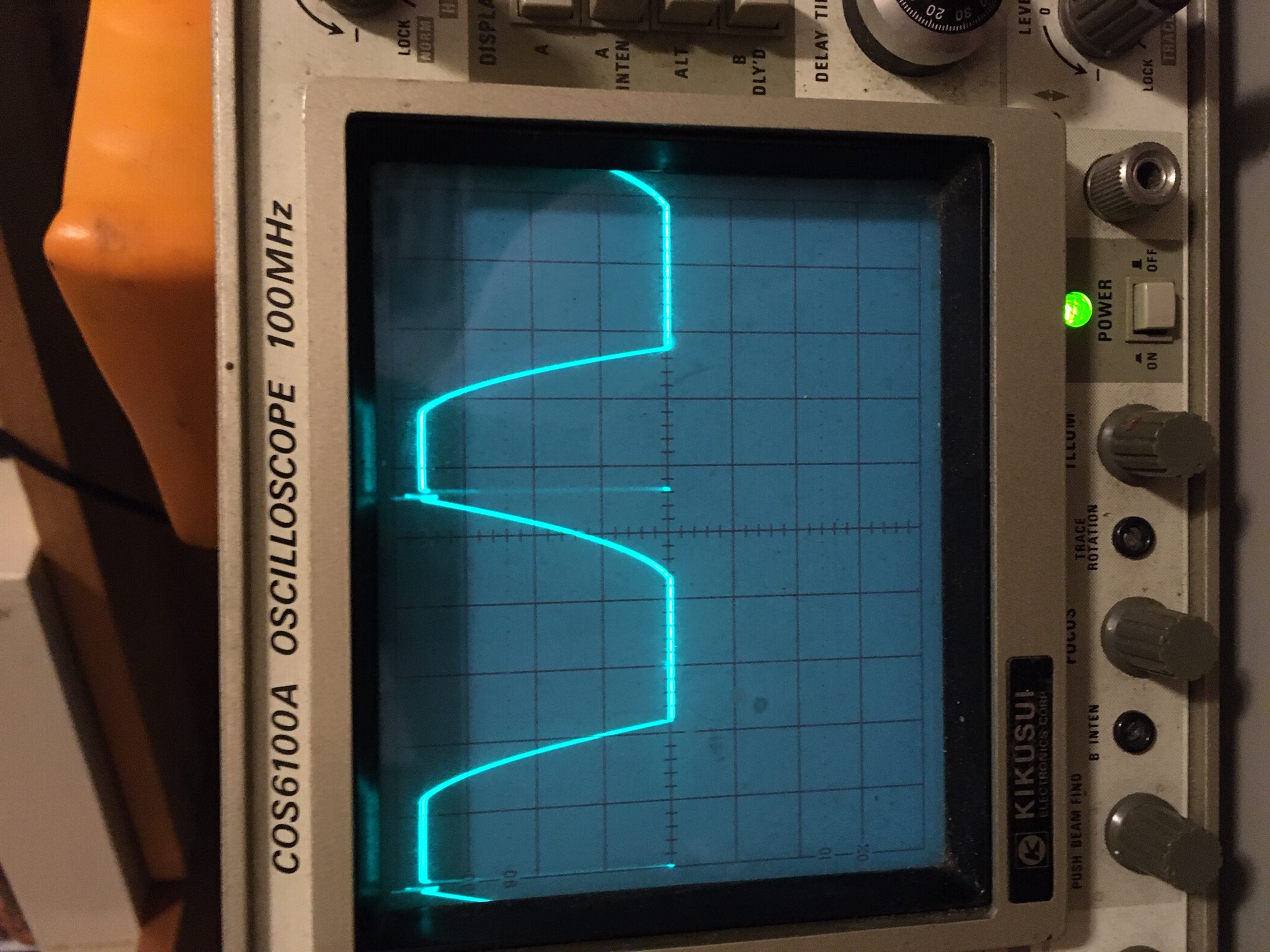

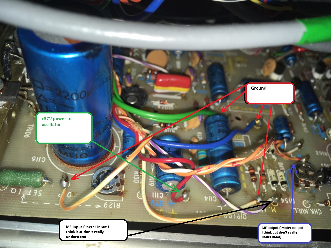

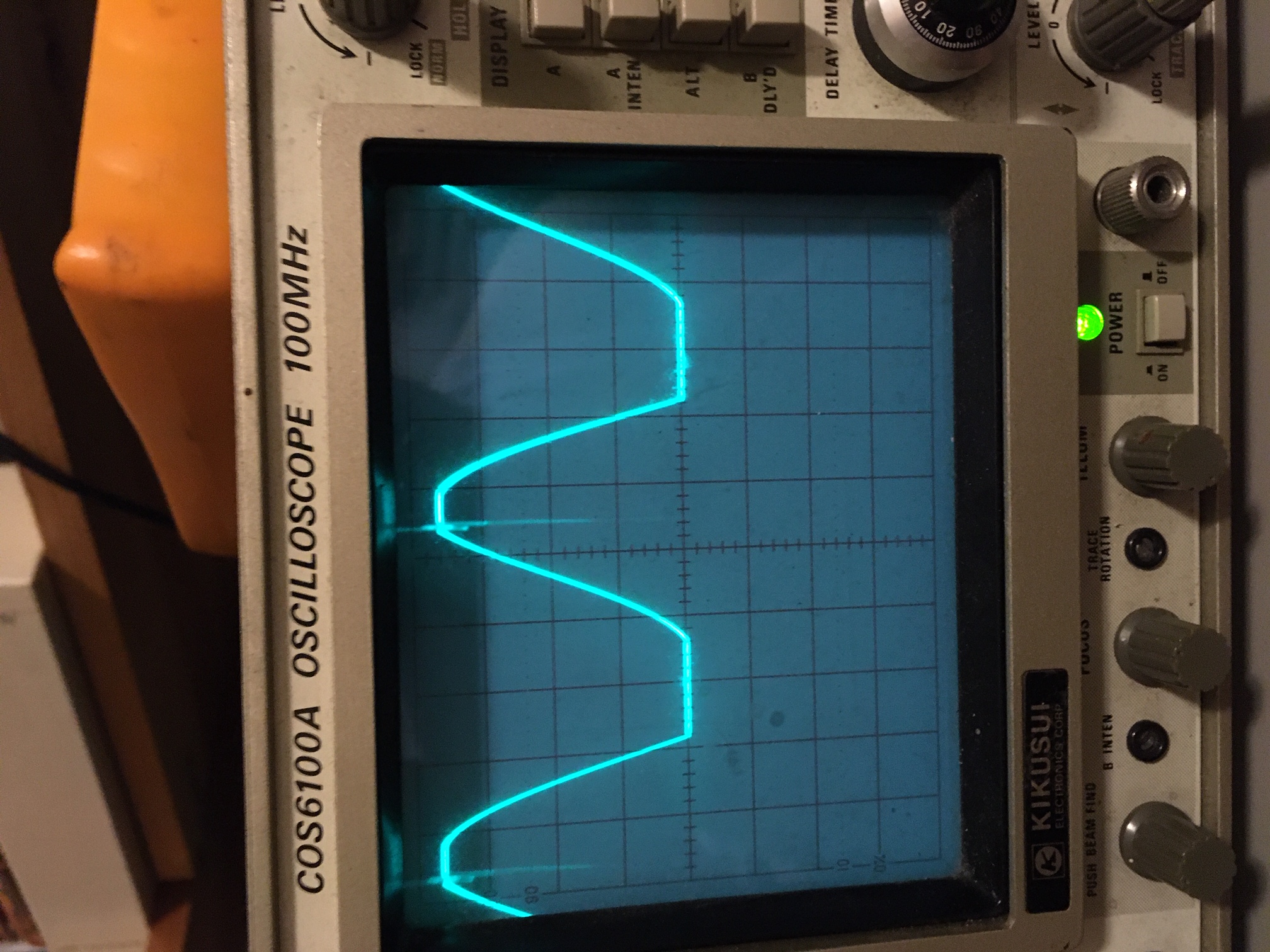

So using the trusty old Kikusui I isolated the oscillator and powered it with the 30v bench supply.
The following photos are what happens, it doesn't do what the service manual says it should I think. The whole sequence takes perhaps 10-15 seconds. The vertical is set to an effective 5V per division (by means of the best probe I have on 10x), the DC offset is considerable. The sine wave obtained at the end is the 8v pk-pk that the service manual specifies.
