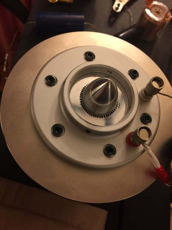

The phase plug is suposed to entirely cover the diaphragm.
If a Goto Unit driver sounds bad, the reason for that level of performance has nothing to do with the phase plug. The driver unit is either damaged, poorly loaded, or most likely, has been partly demagnetized. Furthermore, I suspect that the existing driver design has not been optimized through use of modern computerized modeling technologies. So there remains room for improvement above the already magnificent performance level exhibited by these units. I have never seen published PWT tests for these units as well as those made by ALE in spite of their astronomic selling prices. WHG
I meant phase alignment between drivers at common range.
Regarding phase plug, may be there is a way to redesign the one for GOTO.
GOTO's own competely covers diaphragm with very tiny holes around.
Sound with it is much less resolving...so, I've removed it.

Yes, poorly loaded diaphragm without phase plug, because originally it creates very high compression...1:100 I think, because total square of holes 100 times less than diaphragm square.
I don't think that something was wrong with GOTO drivers. I just don't like horn kind of HF. I have best ones including TAD ET703, but they are not good for my taste. I've disassembled GOTO and realized that it is because of phase plug. But without phase plug they don't work higher than 6k.
So, horn HF not my piece of cake.

Yes. Look, diaphragm is almost completely closed by phase plug:

SM,
.... do you have a picture of the diaphragm side of the phase plug as well?
This is the first time for me to see inside a Goto Unit Driver!
Do not like what I see.
WHG
SM,
