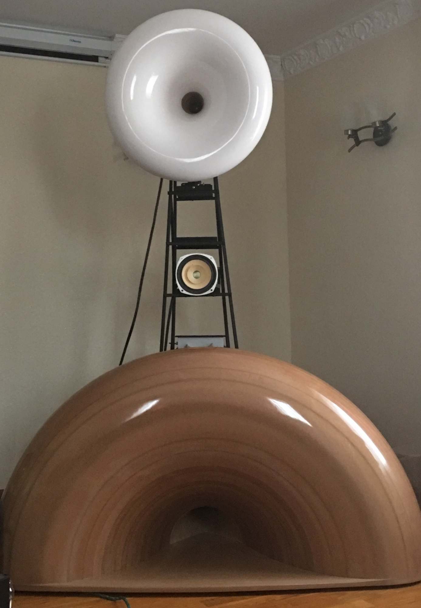

Hi! Great looking setup🙂.
Have you tried moving the sub horn to the align with the side wall? It should definitely smooth out the response even further (going from half-space to quarter-space when simulating in HornResp). Just a suggestion🙂.

Finally, this monster is in my room and I'm extremely happy with result!
20-100hz range sounds amazing...just like I was dreaming!
Transparent, delicate and powerful!
Wow, please explain 🙂
Well...with my "no compression" concept I was fail to get proper HF from GOTO.
Construction doesn't allow to make very short horn without front chamber. If I have even small chamber, HF disappears from 6khz. If I make bigger horn, anyway HF disappears from 6khz. The only way works, when I put phase plug back. Than I have HF from 8khz, but not from desired 3khz. I understand, that I can redesign phase plug to get 3+kHz, but after I heard how this AER works, I've decided not to create too much problems for my self.
At the end, when I hear other systems I always thought, that HF are good from many conventional speakers. Horns are must for lower ranges, because they dramatically reduce excursion and increase efficiency of drivers, so we can hear LF as clean as HF. But for HF there is not such a problem. Excursion is always very very low, so timbre is always clear and transparent.
That is why I still have 5-ways system, but other 4 channels are below 1000hz 🙂

But are you happy with AER (or any similar driver) high frequency roll-off ? I can't live with that personally...
Don't compare AER with any other similar. There is no any roll-off.
I don't know how they did it, but I've never heard such a true violin. (WAV file was attached few posts ago).
And you know, I'm really picky regarding HF. I was using RAAL Lazy Ribbon 9" on top of GOTO HF drivers!
I think that the only similar HF I heard is from top Diamond Seas. Top diamond Accutons are a bit less resolving.

I think it depends... What makes my system outstanding is actually just one range 100-300hz where I'm using GOTO bass drivers in 100hz LeCleach half circle horn.
At 50-100hz I'm using giant 25hz 5m long horn with the same GOTO bass drivers.
And below 50hz - ported 21" sub PHC LFC-21sm

Yes and No . I heard a lot of beautiful full-range drivers also got a few in my home. Some of them sounds just great (Voxativ stuff for example) . But all of them starts to roll-off at 10-16Khz range , its just a physics because a cone size and weight , central HF tweezer helps just partially. Sure in some cases that's OK or even good for a specific taste . A lot of people are happy with that , but my problem is - I can still hear 15.5-16.5Khz on my both ears , so I am not happy with such situation... Also high frequency directivity becomes narrow in this case .
You heard a such great violin because of no bad xover connections between drivers at 1-20Khz , but not for a flat frequency response and no HF roll-off .

Well, from some time ago I really don't care much about measurement values, but more about realism of event in front of me. AER kind of HF makes everything much more real!
I still have RAAL to add on top in case, but not sure that I need it...I'll see...may be you are right!
I can agree . Measurements and numbers are just for double checking in most cases with audio. At the most its just about feelings ...
But good pro measurements with good mics (at least M30 ) helps a lot to understand whats going on . And don't reject a phase measurements , they are important at same level with a frequency ones .
Umm, you threw that out with the phase plugs. I know of one compression driver that was actually designed without one that actually sounds good but it's main fault is bandwith. Removing the phase plug from a driver that was designed for one isn't a "mod" it is destroying the driver. Most people that have success with building horn systems shoot for a decade a driver because it works.
