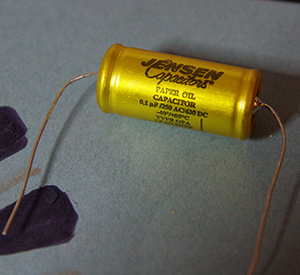

hi yes I have several nice Jensen replacements but it seems to be a bit of a sacrilege to change out the originals, but i'm kinda stuck if I can't reform them. I was under the impression that it was possible to reform the older metal can PIO caps, but i'm pretty new to this and really not that well informed
There are excellent axial film capacitors available.

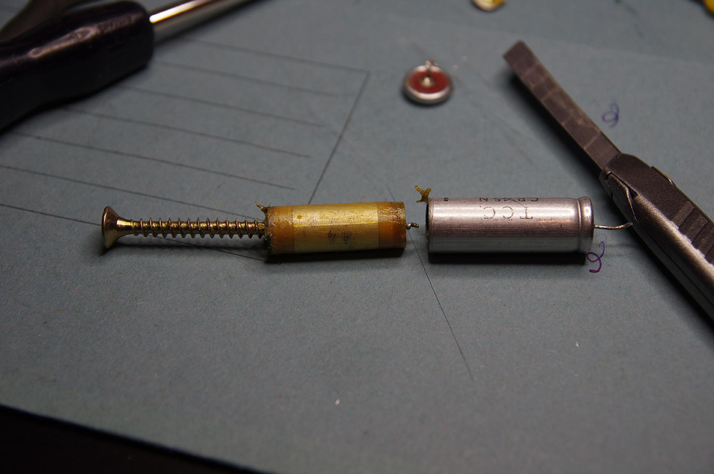

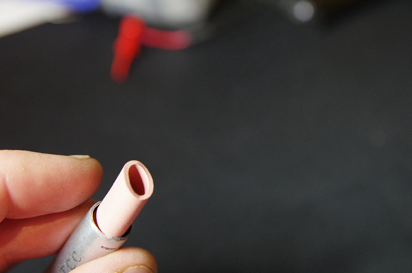

Whit a little handywork you can re-use the old shell and put a modern film capacitor in.

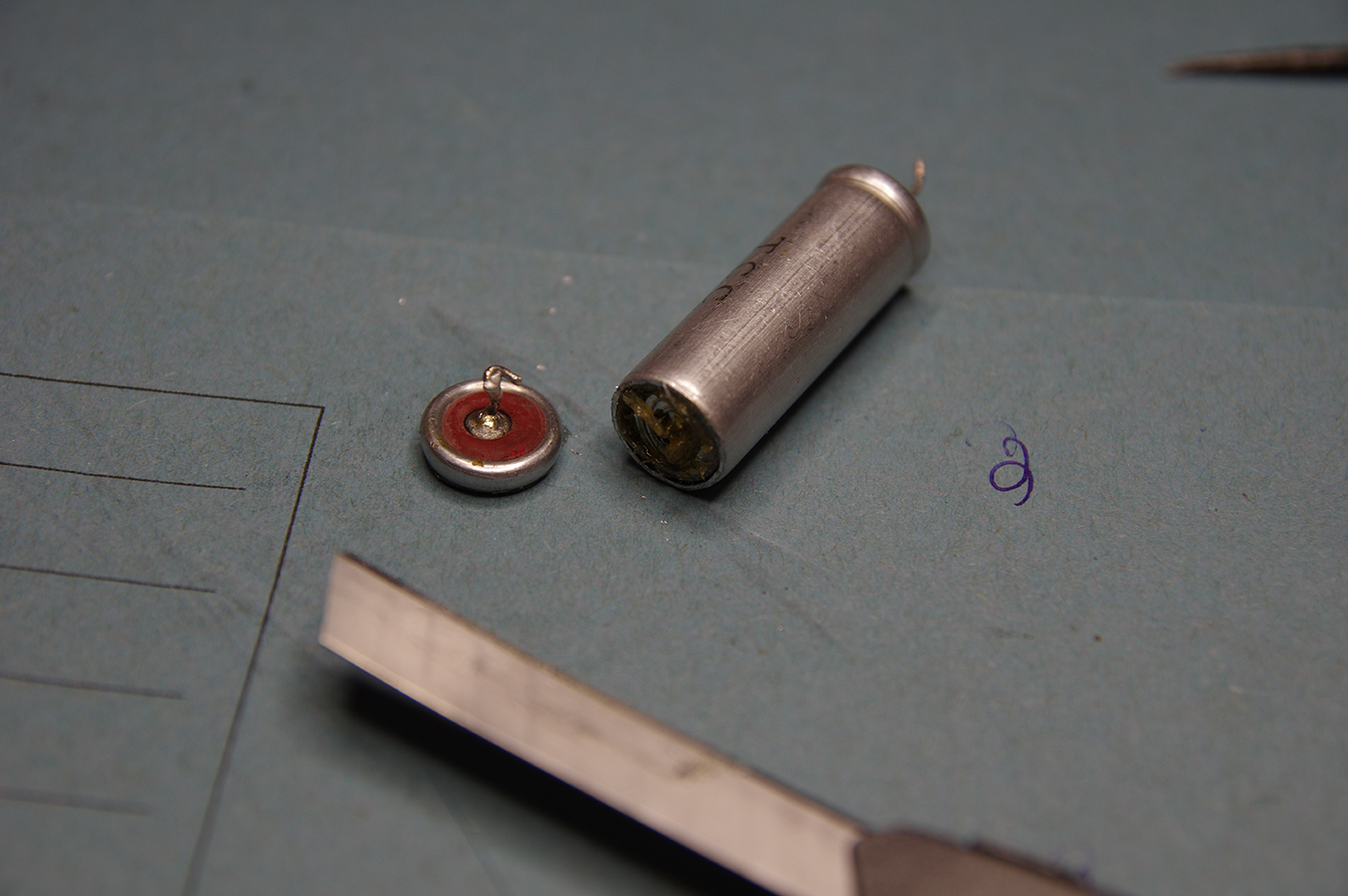

i Have just put dc across the new cap and it drops off to practically 0 but with the old caps there's 200v and little drop. I could restuff the cans and put in a film cap. It seems like the best solution as I don't think I can reform the old ones.
I restiffed the 8uf and it came out well

hi thanks for all the advice. I managed to get some vishay caps which will fit inside the case of the TCC metalcaps
I have started to dissemble them and I must say it is coming along nicely. Some rubber sleeving for insulation. The new caps leads will go through the existing holes and the end can be epoxied on. I can touch up with silver paint pen for that original look.

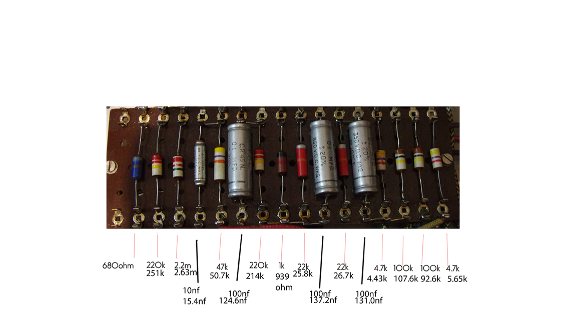

A lot of the resistors are out of spec so that will not be such an easy thing to hide. Might just need to fit new.

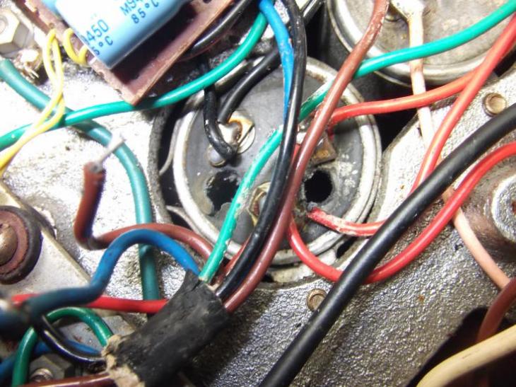

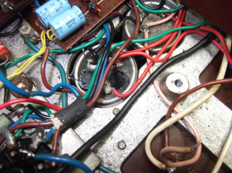

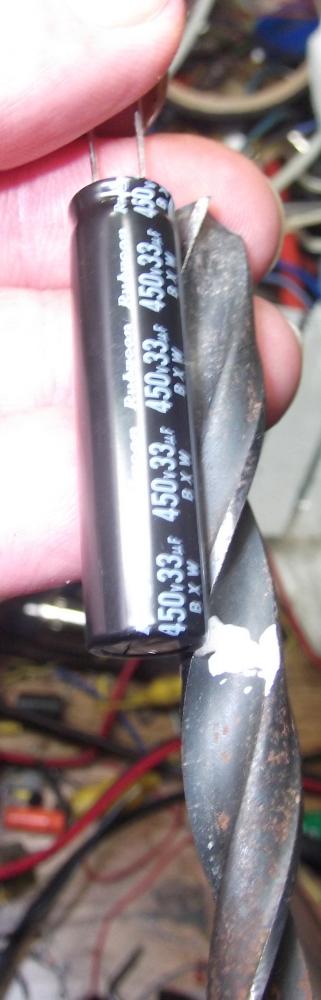

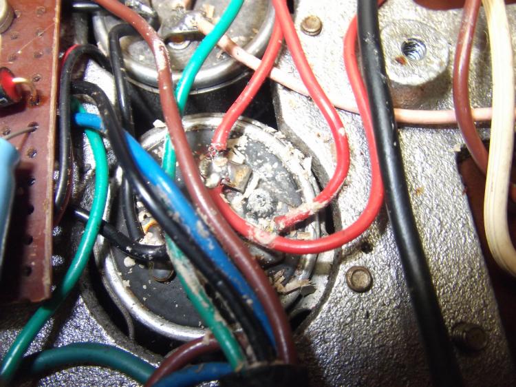

LCD panel mains capacitors (long and skinny type) can be fitted without removing the can from the chassis with the correct size of drill and a spot of epoxy.
The capacitors are cheap and can be got on both sides of the Atlantic.
450BXW33MEFC10X40 - RUBYCON - CAP, ALU ELEC, 33UF, 450V, RAD | Newark element14
450BXW33MEFC10X40 - RUBYCON - CAP, ALU ELEC, 33UF, 450V, RAD | Farnell element14
Drill small pilot holes and work up to the full drill size and use another full size drill to stop the internal material from rotating inside the can especially if you have drilled through the solder tag.

That's great about those long thin caps, very handy. I would get some of those for future work. I already have some F&T axial caps which U can use. It may require cutting along the ridge of the can, the join will not be seen once the cap is refitted.
It was a pretty quick job and also the amplifier was heavy enough and the capacitor clip tight enough that there was no need to hold anything during drilling.

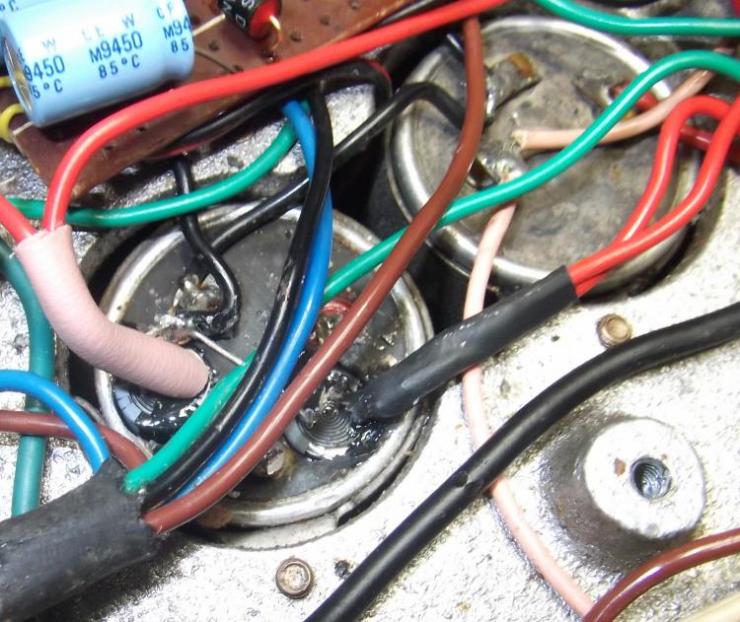

I have carefully changed all the coupling caps, replacing with restuffed metalpack caps. resistors out of spec have been replaced with Allen where possible.
Smoothing caps have been reformed as best as I can get 0.05v on 2v Range on DVM and 20 second to discharge caps. Capacitance reads within specs
