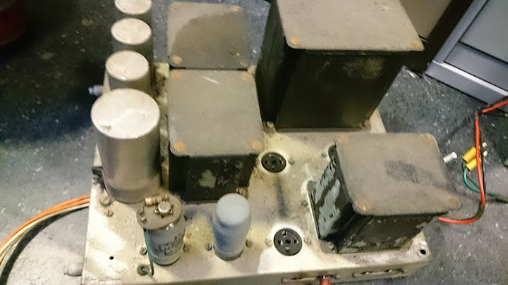

Got some PX4 valves from an old radiogram
turns out all the coupling caps are leaky. One is passing practically all the input dc. I shall attempt to recondition the rest as I would like to keep the original caps if at all possible.
I think you have settled on the right philosophy - to test and recondition where possible/sensible. But if you find multiple instances of certain types/values being leaky, its prudent to replace the other similar ones too.
hi yes I have several nice Jensen replacements but it seems to be a bit of a sacrilege to change out the originals, but i'm kinda stuck if I can't reform them. I was under the impression that it was possible to reform the older metal can PIO caps, but i'm pretty new to this and really not that well informed

i Have just put dc across the new cap and it drops off to practically 0 but with the old caps there's 200v and little drop. I could restuff the cans and put in a film cap. It seems like the best solution as I don't think I can reform the old ones.
I restiffed the 8uf and it came out well

hi thanks for all the advice. I managed to get some vishay caps which will fit inside the case of the TCC metalcaps
I have started to dissemble them and I must say it is coming along nicely. Some rubber sleeving for insulation. The new caps leads will go through the existing holes and the end can be epoxied on. I can touch up with silver paint pen for that original look.
A lot of the resistors are out of spec so that will not be such an easy thing to hide. Might just need to fit new.

Ok I have some progress good and bad.
I have carefully changed all the coupling caps, replacing with restuffed metalpack caps. resistors out of spec have been replaced with Allen where possible.
Smoothing caps have been reformed as best as I can get 0.05v on 2v Range on DVM and 20 second to discharge caps. Capacitance reads within specs
After a lot of other checking I decided to power up with regulator valve only, no problems. I used a 100w bulb in line with the mains
I then replaced the other valves and applied audio in and attached speaker
turn off again and insert PX'4's
well large hum, followed by brightening of inline bulb
so quick switch off
tried one PX4, no hum no brightening
tried second, hum and lamp brightening
looks like one of the PX4's is duff!
audio is very low with the other installed. I haven't run it long like this.

just as an update. Both vales were found to be faulty. One had a weld break and the other does not conduct. 2 new matched valves later and the amps is working. I am reading 350v from anode to chassis. Is this ok, I read max is 300 but I may be misunderstanding this. The amps sounds amazin, with a tiny bit of earth hum,may be the 2 pin plug
I put a 10k resistor on each anode to output tranny and measured 250v, so that's 25mA each valve.
