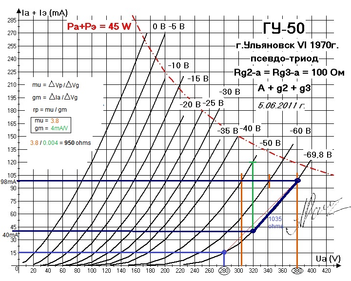

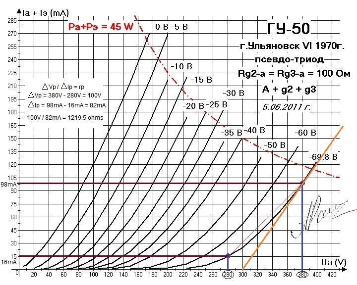

Why? Aren't we interested in the delta of the current and voltage of the actual device, and not some straightened tangent derived from measurements of the device?
I feel like I'm missing something big here.
Figuring the rp from the orange line I get 0mA at 300V and 98mA at 380V.
380 - 300 = 80
0.098 - 0 = 0.098 = 816.33
Really??
I'd figure if you were going to draw a tangent, you'd draw it so that it intersects both points on your plate curve down to cutoff, so that you incorporate changes in plate resistance that happen as the tube approaches cutoff (where rp goes up and gm goes down). That's what I tried to accomplish with the thin red tangent I drew from the high voltage/high current point on the curve to the low voltage/low current point.
I'd better go look at the RDH4 again.
380 - 300 = 80
Really??
OK, I checked the books. It does seem you want to 'sample' the grid curve in a 'central' part of it, where the curve is fairly straight. That will tend to give you a lower value of rp.
rp = mu / gm , so if you know those two other constants you can figure out rp. Solving for mu first:
gm = δVp / δVg
- I found that starting from an operating point of Vp = 340V and Ip = 98mA, the grid bias is -60V.
- Grid bias is -70V at Vp = 380V
- Grid bias is -50V at Vp = 304V
δVp = 380-304 = 76V
δIp = 20V
76V / 20V = 3.8 <-- That's the mu

Now for gm
gm = δIp / δVg
- I found that at Vp = 320V and Ip = 120mA, Vg = -50V
- At Vp = 320V and Ip = 40mA, Vg = -70V
δIp = 80mA
δVg = 20V
0.08 / 20 = 0.004 <-- gm = 4mA/V
___________________________________
rp = mu / gm
3.8 / 0.004 = 950 ohms
In the latest scrawling on the plate curves, I drew a tangent from 320V-40mA (-70V) to 380V-98mA (-70V). That gives rp = 1035 ohms.
I'm going to split the difference and say rp = ca. 1000 ohms.
rp is not truly constant, so isn't a bit of a judgment call? Yes, at a particular operating point there is one value of plate resistance. But the plate resistance will vary once the triode starts swinging out of its linear window of operation.
So yeah, I think 1000 ohms works for me.

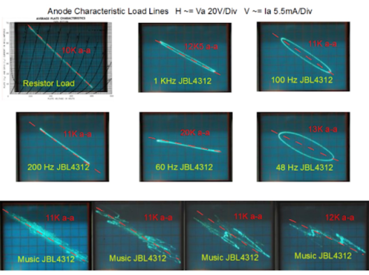

A few well-chosen 'scope grabs with real life loads speaks volumes. That's a spot-on illustration.
You got me to go back to the books on this. I'd read the chapters on calculating rp in the RDH4, MerlinB's and Morgan Jones' books, but I missed that crucial detail of how to choose a section of the grid curve to make the calculations. Yes, they talk about using the straight part of the curve. I see clearly now how that is just an approximation, an educated guess -- so there's no use nitpicking.
I learn better when I have a real life problem to solve, and this did the trick.
So, thanks again!

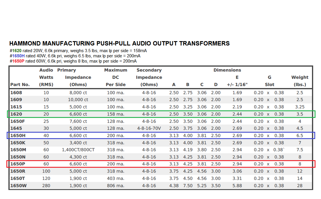

It seems Hammond Mfg gives max current ratings per each half of the primary for their push-pull OPTs.
I copied a table from their catalog, listing their PP OPTs.
Their part no. 1620 is rated 20W, 6.6k plate-plate primary, max Ip is 158mA per side. Weight is 3.5 lbs.
Part no. 1650H is rated 40W, 6.6k p-p primary, max Ip per side = 200mA. Weight is 6.5 lbs, which is similar to the Edcor CXPP45 and CXPP50 OPTs I was looking at (those are 6.75 lbs).
Part no. 1650P is rated 60W, 6.6k p-p primary max Ip per side = 200mA. Weight is 8 lbs, which is pretty darn heavy.
So... What does that tell us? I'm not sure. But it does appear that a 45W 6.6k primary OPT should work for a Class A amp running with each tube Ip = 90mA.
Hasn't anyone else puzzled this out before? Am I on the right track?

Well, all three of those have pretty similar primary DC resistance which is quite low (70-80 Ohm per side), so any of them will work.
The bigger ones will give you better bass extension due to higher primary inductance and also less distortion in the LF region, but for me even the 1620 seems quite reasonable, so it is more of a size/weight/cost question.

I have always interpreted the Hammond rating that is called “Max DC per Side” to mean the combined center tap current for two sides of PP, so I agree with your musings above.
You may also consider Toroidy - the Baby Huey guys have had very good results with them. The TTG-EL34 transformer seems to fit your requirements, and at ~US82 per piece delivered to the US very competitive.

I was looking at the Edcor CXPP25-7.6K. There's no current rating or info on primary DCR, but it weighs 4.5 lbs (2 kg) each. What's interesting is that they can be ordered with a single 4 ohm secondary. This allows better high frequency response (reduced leakage inductance, interwinding capacitances). Since the speakers I'll be using are either 4 ohm rated or smaller ported bookshelf speakers, I'd rather work with a 4 ohm secondary than an 8 ohm. (They're also available with a single 6 ohm secondary.) The price for those would be about $160 for the pair, shipped.
If the 20-watt rated Hammond 1620 would work, perhaps the Edcor CXPP25 would also work.
Generally speaking, I look for clarity and smooth mids and highs rather than trying to get the deepest bass response. I might even put a HPF at the amp's input to restrict low end response, hoping that might reduce intermodulation distortion. My speakers don't go below 40Hz and I don't think the amps should try to go lower than that. Amplifier LF response of -3dB at 15Hz would probably be fine for my purposes.
The Hammond transformers are too expensive for what they are, but it was good to use them as examples for thought experiments.
I have a query in to Edcor about current ratings and primary DCR of some of their models. Waiting for the reply.
That TOROIDY OPT looks interesting alright. $82/each delivered is very competitive. My only concern is that toroids may require careful balancing of quiescent Ip of the output tubes. This makes things complicated. I suppose I could match the output tubes quiescent Ip. They are cheap enough. But they will drift with age, and I don't want to get into elaborate biasing schemes to keep the toroids from saturating on current imbalance. Have you found that to be an issue, and if so, how did you deal with that?
rongon said:That TOROIDY OPT looks interesting alright. $82/each delivered is very competitive. My only concern is that toroids may require careful balancing of quiescent Ip of the output tubes. This makes things complicated.
Valid concern. But I have not seen any experiential complaints from any user about imbalance of currents/tubes using the Toroidy output transformers. They could have some small gab built-in. I better ask, because I have several unused pairs of those Toroidy’s.
