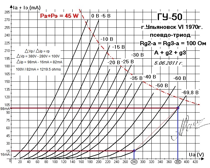

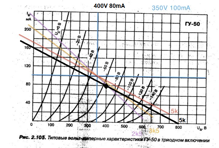

I'm still left wondering what OPTs I really need for a weird amp that draws 90mA of plate current per tube but is only expected to output 10W or so of (AC) audio signal power to the load.
Is the maximum plate current (Ip) the OPT can handle purely a matter of winding resistance/heat dissipation?
If a PP OPT has 100R per half primary, and there is 90mA quiescent plate (anode) current (Ip) from the tube it's loading, then that's 100R*0.09A = 9W of heat being dissipated by that primary half-winding. That seems excessive to me.
But a push-pull OPT with reasonably well balanced output tubes will have cancelling currents on its primary windings, because the two tubes will always be conducting in opposite phase. Does this mean the primary winding doesn't really 'see' the full Ip of the connected tube?
It's not as bad as that, P=I^2R so only 0.8W per half.
Ah, I had the math wrong. Big surprise, eh? Thanks for straightening me out there.

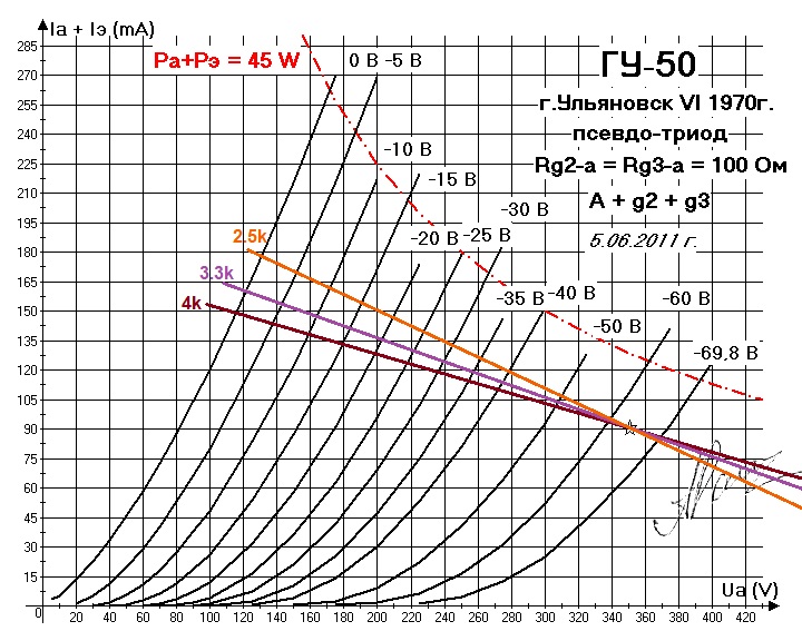

The frequency response of an output transformer depends on many things.
Here is a pair of factors:
1. The Plate resistance, rp, that drives the primary.
The low frequency inductive reactance, and the high frequency capacitance versus the rp are one factor.
2. The presence of negative feedback that samples the feedback signal from either the primary, or the secondary. That negative feedback lowers the effective rp of the output tube(s) (refer to # 1 above).
Those factors are true for both low frequencies, and for high frequencies.
I will not list the many other factors that affect the frequency response of an output transformer that is in-circuit.
