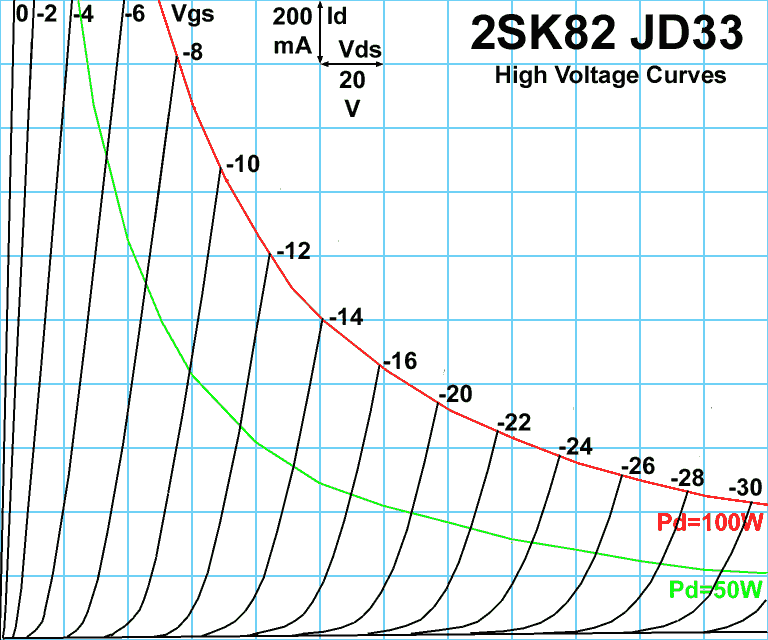

You really don't understand what a VFET/SIT is.
There is no other comparable semiconductor to it nor are there any second source suppliers (nor were there EVER) - except another comparable SIT.
The last ones in production were from the ex-USSR and phased out in the mid-1990s. Some larger and high voltage parts were last produced by Tokin, before it was bought by NEC when the production was permanently stopped.
Nether Sony, Yamaha, NEC/Tokin nor Hitachi are willing to license ANY of the VFET technology (and people have tried!).
Here are characteristic curves of a N-channel VFET. Compare with any MOSFET (no comparison, really).
