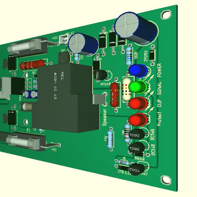

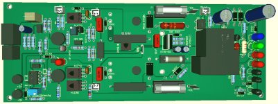

Why do you not replace old Internal Sony Mosfet PCB
with todays reliable High End Mosfet Technology all in one PCB ?
200 x 78 mm DC Protect, ....
Only rewire and add to heatsinks. work from 30 to 90V
Also the heat is much lower comoare old Sony V-Fet Design
