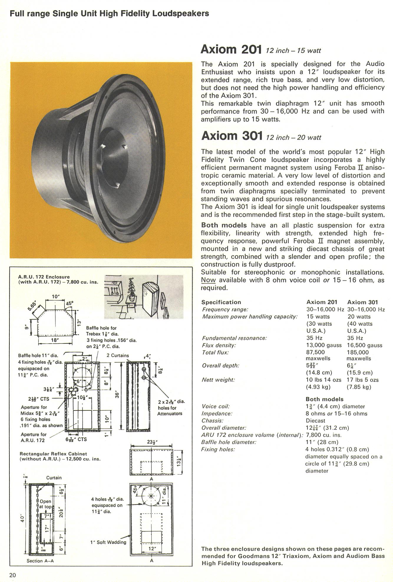

The DIY enclosure designs from Goodmans suited all of their 12" drivers produced at the time. There's a large reflex enclosure design shown in the attachment.guys, what do you think, which is the best without ARU enclosure type/plan for 1220c ?
Goodmans produced a commercial loudspeaker called the A.L. 120 REPRODUCER which contained the Triaxiom and was extremely compact compared to the DIY designs. It did have an ARU on the back, but if a small enclosure is required it may be worth experimenting with a resistive vent. http://ukhhsoc.torrens.org/makers/Goodmans/1960_High_Fidelity_Loudspeaker_Manual/Page16.jpeg

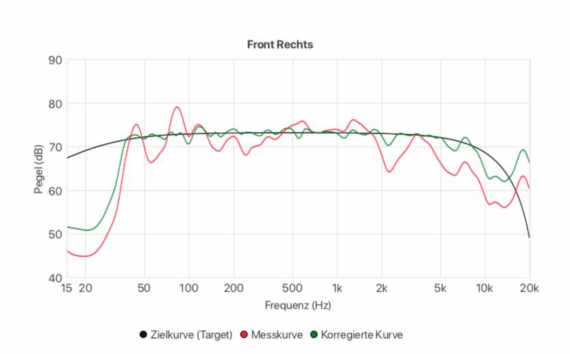

Leaving the L-Pad in function and bypass the pot should bring an optimal result. The green curve came out with a measuring microphone and a useful dsp within a paradigm network player. The sound gets more to HiFi but keeps some of the good Goodmans characters. Especially the room mods are optimized/corrected. For my relative small listening room, the triaxiom are not the best choice IME.Galu,
100ohms
Yeah I'm liking that green frequency response graph. I think I will try your mod. 🙂
