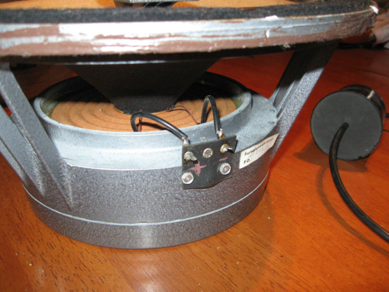

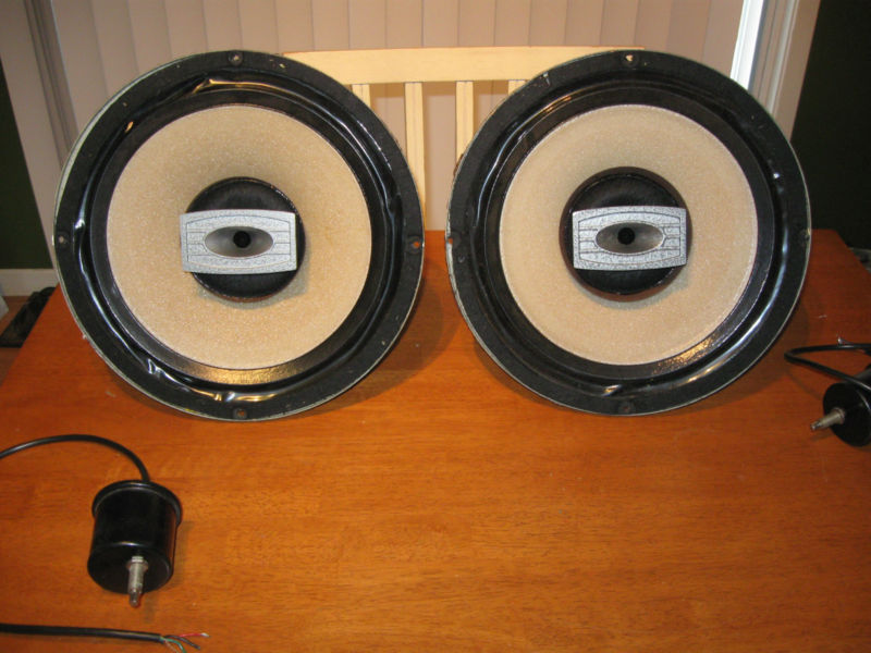

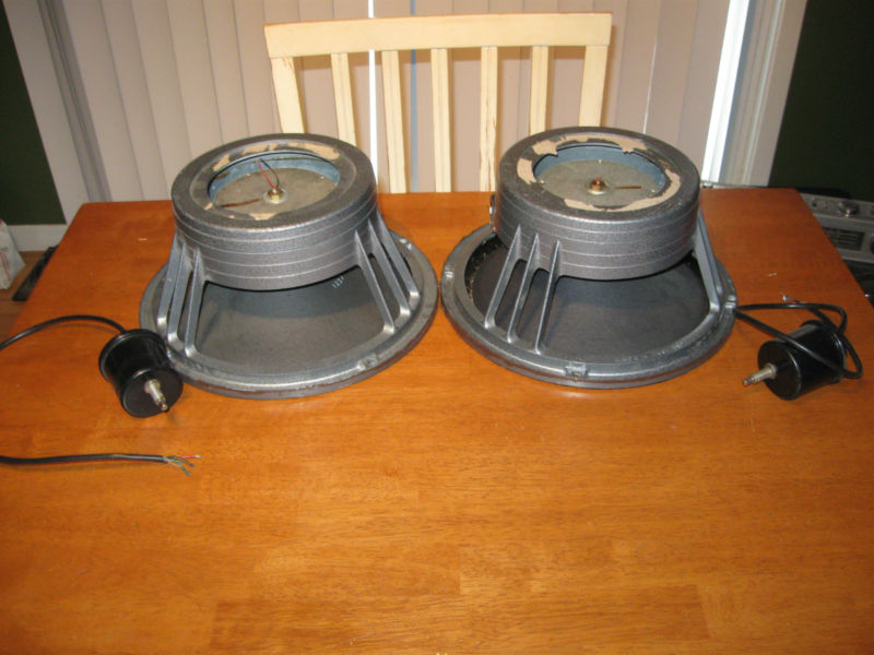

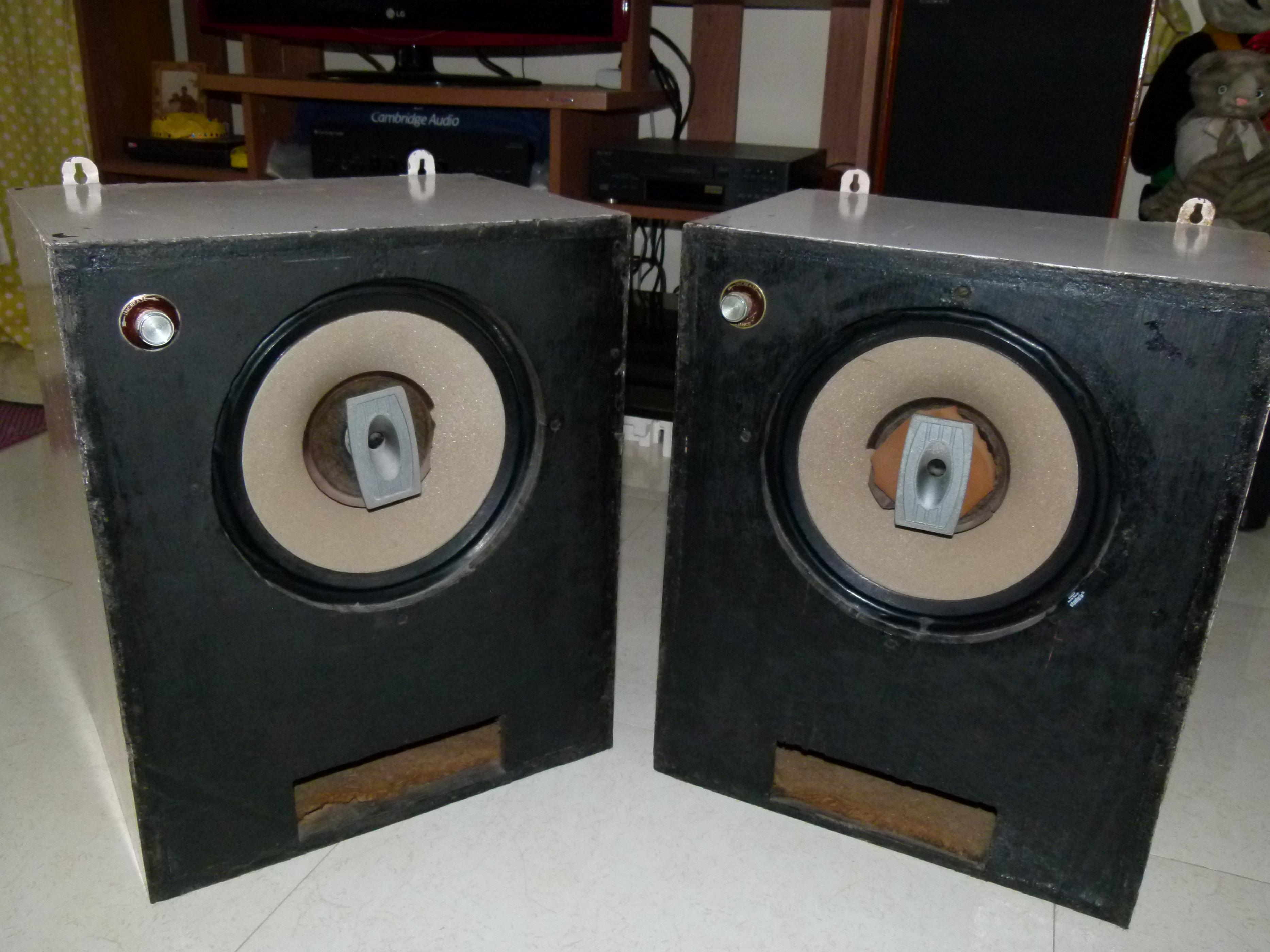

Recently purchased 2x 1220c's and didnt realise the attenuators/crossovers had been removed and the pictured ones are not Goodmans........can anyone suggest a way of getting around this??
Surrounds are sure original, have no idea about the x-overs though. Probably might be best to buy another pair and just duplicate the X-overs with todays components. They show up from time to time on eBay or other places. Even better would be to find single one that will be sure much cheaper than the nice pair.
xover is made with 1,5 mF cap and 0,18 mH air coil parallel connected.

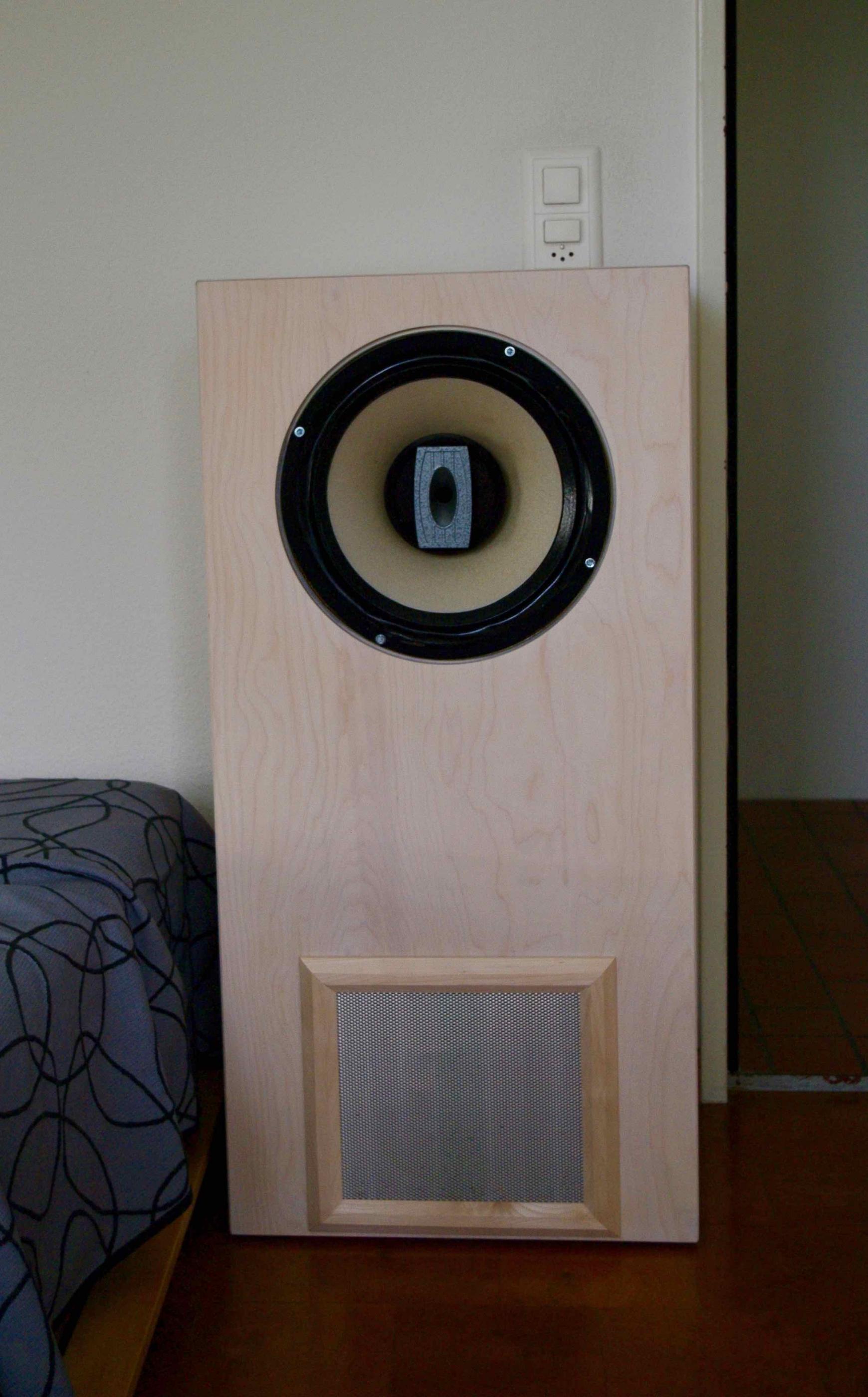

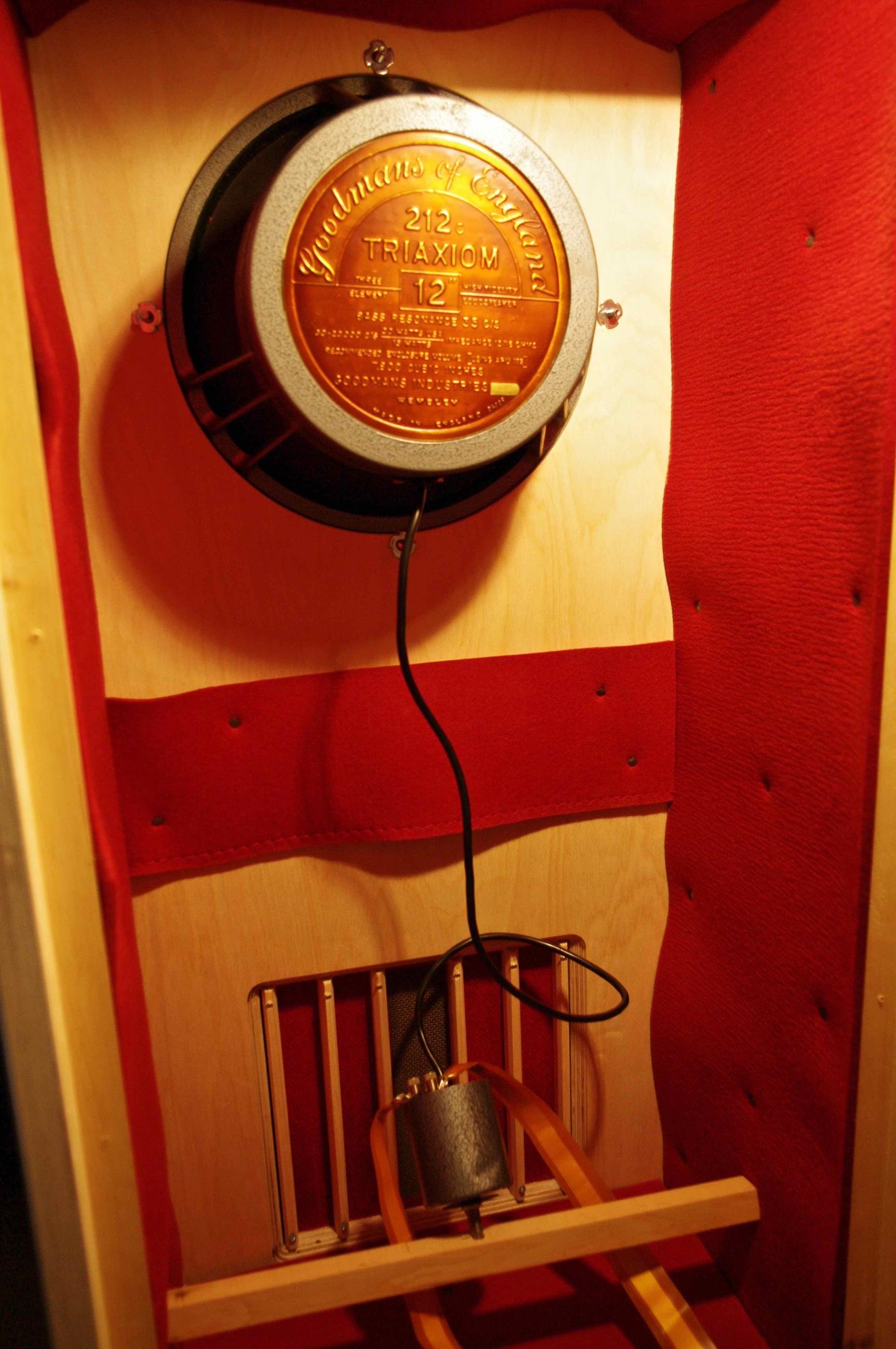

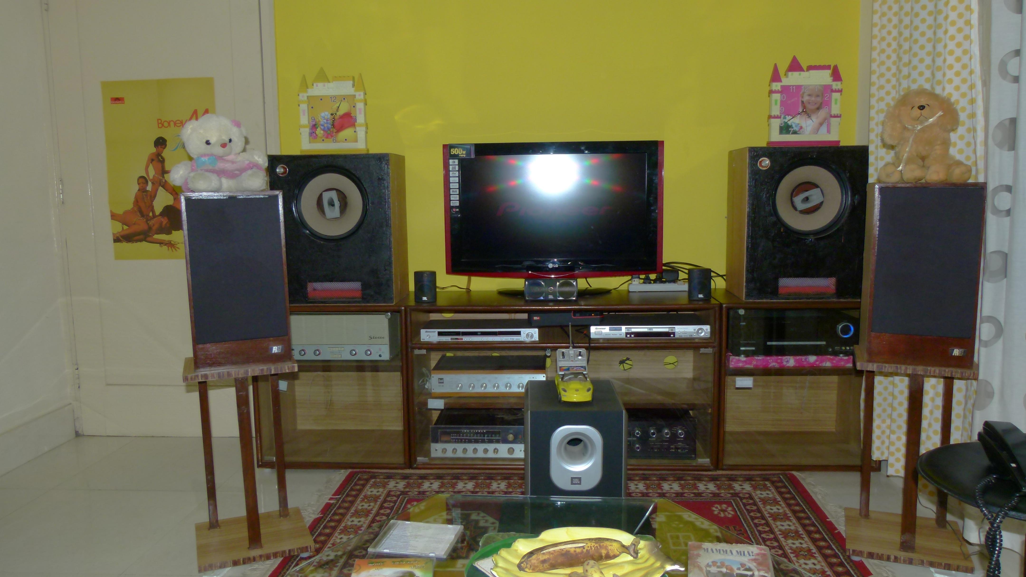

The mids and highs with my triaxioms are beautiful without any issues and there's plenty of bass depending on the room. They're my main speakers after building the enclosures in 2012. I've got the issue with one speaker, where the voice coil scratched at medium volume. This was probably caused by shipping. After two months the voice coil has centered itself and this issue had gone. I found, that the high mids weren't as good as the rest. The original cross-over is calculated around 5 - 7 kHz. I've replaced the original capacitor with a lower value (1 mF) and bypassed the coil and the variable resistor. The 'Trebax', which is connected with inverted polarity, is now an auxiliary tweeter and the woofer works as fullrange. The volume of the enclosure is 10 % smaller than recommended (with ARU 172) and the baffle is also less wide.my general problem is, that my 1220C-s sounf very flat, the highs are weak - I think the trabak is running, but the overall sound is not good.
The walls inside are covered with felt and I've installed 2 curtains with thin felt as proposed in original drawings. Recently I've checked out a modification with a kind of transmission line in one cabinet and measured with the audio analizer of my smartphone a little difference, in my view an improvement in bass response. My amp is a 2A3 PP triode amp (ai faa) and the speakers are connected to the 16 Ohms tab. This combination works great. With my ACA amp, the bass response is weak and overall it looks to be stressed to much, probably because of the speaker load at the low end.
2 photos from 2012The mids and highs with my triaxioms are beautiful without any issues and there's plenty of bass depending on the room. They're my main speakers after building the enclosures in 2012. I've got the issue with one speaker, where the voice coil scratched at medium volume. This was probably caused by shipping. After two months the voice coil has centered itself and this issue had gone. I found, that the high mids weren't as good as the rest. The original cross-over is calculated around 5 - 7 kHz. I've replaced the original capacitor with a lower value (1 mF) and bypassed the coil and the variable resistor. The 'Trebax', which is connected with inverted polarity, is now an auxiliary tweeter and the woofer works as fullrange. The volume of the enclosure is 10 % smaller than recommended (with ARU 172) and the baffle is also less wide.
