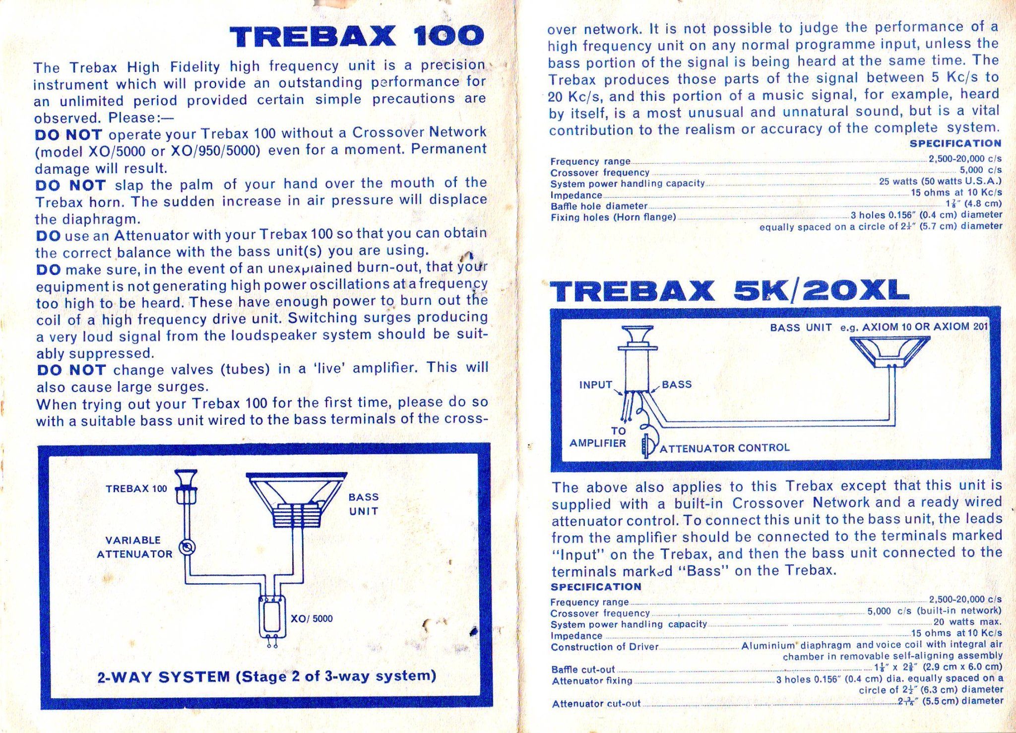

From my link in post #22, the Trebax 100 optimistically extends to 20,000 Hz (see attachment).
As for relative phase, this can also be determined by the relative positions (depths) of the sound emitting centres of the drivers and not just by the crossover components. Best to phase by ear as you have suggested.
P.S. I would leave the crossover as standard. I can't help but feel you are overthinking things in regard to the addition of the dome tweeter.
I would simply roll the dome in gradually above, say, 12,000 Hz, but would not go as far as to roll off the Trebax, which seems to be rolling off mechanically on its own accord.

Yes, the link in post #3 tells all about the Trebax. In post #41, I attached the info on the Trebax 100 which appears to be a different unit.
In those days, FM radio was a popular music source. Since FM only extended to 15 kHz, there was little point in the tweeter extending further.

Oh ok think I do have the Trebax 100, however it looks just like the one in the link in post 3. Checking the dimensions of the horn in both links they appear to be the same driver or at least the horn is the same.
Either way the dome tweeter reproduces what the trebax is lacking so I'm satisfied.
