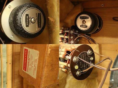

I've got a Goodmans XO 950/5000-2 crossover, a midax, a trebax and two 12" 8 ohm RCA woofers from a 1960's console that I'm going to try building a speaker with.
I never could afford an appropriate Goodmans driver back when I bought the midax (got three) Trebax (got two) and crossover (got two) so they sat for several years until I got the RCA woofers a few years back and casually experimented with them.
I put the woofers in series for a 16 ohm load as the other drivers I believe are 16 ohms.
I do not have the attenuators that could be used with these.
The midax and trebax are louder than the woofers and the trebax is a little louder than the midax.
Three questions.
1. Do the capacitors in the crossovers need to be replaced?
2. Are there 16 ohm variable l-pads or is there a schematic of the original attenuators so I can duplicate them?
3. Would it be better to pass these on to someone who can use them with a proper Goodmans woofer?

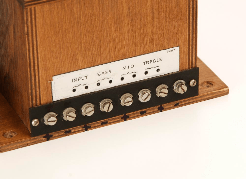

They are certainly available in the UK: https://willys-hifi.com/collections/l-pad-attenuators/products/16-ohm-l-pad-attenuator-100-watts
Details of the Midax and Trebax units: http://ukhhsoc.torrens.org/makers/Goodmans/1960_High_Fidelity_Loudspeaker_Manual/Page12.jpeg
Details of attenuator and 950/5000-2 crossover: http://ukhhsoc.torrens.org/makers/Goodmans/1960_High_Fidelity_Loudspeaker_Manual/Page13.jpeg
A 16 ohm vatiable L-pad control can be substituted for the variable 8-step attenuator.

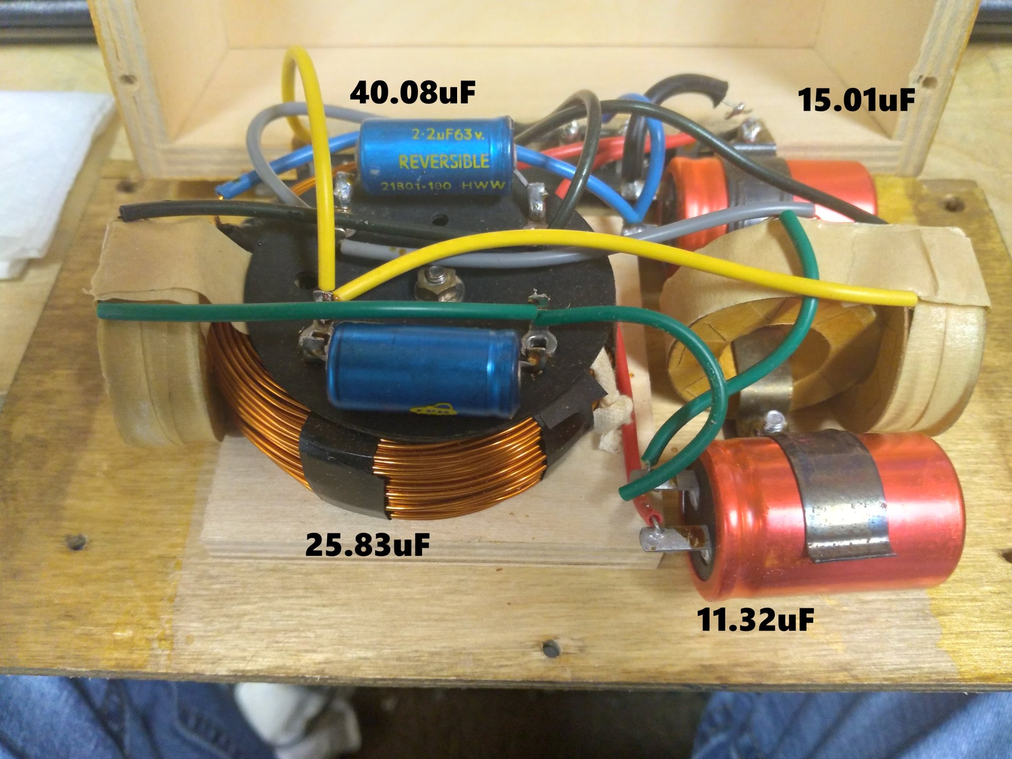

The label on the crossover does state
LOUDSPEAKER IMPEDANCE RANGE 8-15 OHMS.
That said I'd want all drivers the same impedance.
The caps are as follows.
Two 10uF 20V
Two 2.2uF 63V
Will be easily and relatively inexpensive to get those caps from Parts Express and the new caps should fit where the old ones were.
I disconnected one lead of each cap and used my DATS V3 to measure the capacitance.
It's no wonder the trebax sounded so harsh.
I do have some 2.2uF electrolytic caps I can temporarily tack in place at work tomorrow just to see how much of a difference it makes. Think I have a couple 10uF as well.
That's the other crossover. The one I have at work is probably just as bad if not worse.

I tried the 2.2uF and 10uF electrolytic caps I had on hand just to see what improvement there would be and the trebax is now balanced with the midax nearly perfectly and not harsh sounding at all.
