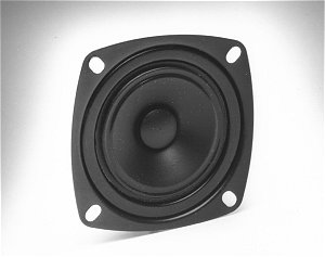

I heard the audax TM025F1 once for about 10 minutes and thought it was real good. I would really like to try it for 2 reasons.
First, it is really small with a small faceplate so it can be really near the mid driver. (there is also a truncated version which is even smaller).
Second, high sensitivity
I would like to build a MTM arrangement with it.
Worked with the Seas 27TFFC which is good and the Vifa D27TG05 also. These are solid value, can't go wrong tweeter. The 27TFFC is a DIY favorite but IMO, don't cross it below 2500 Hz second order electric. Some people will disagree and say that it can be crossed at 2000. But in my system, it sounded rough at loud volumes.
I guess it is in this price range (25-30$) that you get the better value.

I used the Audax TM025F1 in the Adire 281 and LCC. It has very good dispersion characteristics. Very good for it's price.
Go to the North creek music systems sight...There you will find the d25-06s these are $36.00 the pair...George Short has these made in China and says they are comparable to the scan speak d2905 which are $172 the pair...I bought a pair, and I agree...they're pretty good...North Creek Music Systems is a very good vendor for drivers-caps- and what not.
May I third the Audax TM025F1, well worth every penny, and the small surround makes it easy to work into a box design.
The peerless tweeter can be easily modified, with a non resonant chamber, with great results and ridiculous investment. Better low range performance, mainly. I can't think how you can better than this at this price.
Okay, so the list now is:
- Seas 27TDFC: $28.85/ea
- Morel MDT20: $26.15/ea
- Audax TM025F1: $19.10/ea
- North D25-06: $36/pair
- Peerless 811815: $17.80/ea
- Dayton (PE #275-070): $15.50/ea
At this point in my learning curve, I think I'd rather build a complete system first, without getting into driver modifications, and just listen to it for a bit. Then later, I can try driver mods.Raka said:The peerless tweeter can be easily modified, with a non resonant chamber....
Very nice comparative note, thanks a lot. I just wish you'd also gotten around to trying one or two of the others, specially the North drivers. Would have made my job so much easier... 😀random_id said:I think the Morel is the most musical. It also can handle a heck of a lot of power. It does lack a little super-high sparkle, but it is very nice.

2 or 4(!) midbass drivers crosswed over using LR4 at 2.5Khz.
I'll note THE LR4 should ideally be used with 1 mid unit, 1 tweeter,
so I'd suggest a 2.5 way with the other bass unit for BSC.
If you want use use 4 drivers then a 2.5 way MTMMM is possible.
Of the tweeters discussed the new Seas is a excellent choice.
With LR4 2Khz c/o is possible, but note you are asumming
your bass / mid drivers measure flat - which is unwise.
