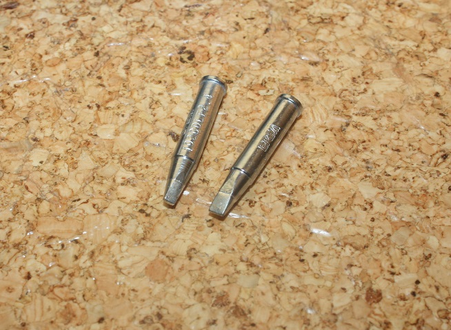

1.6mm can work satisfactorily in surprisingly more locations than thought when powered by a good station. But 3.5mm-5mm come to their own on thick wires. Don't be afraid of 390C setting when the going gets tough especially when the solder wire is lead-free.
Salas, your (and mine) Metcal PS-900 soldering station with standard SFV tips has about 390C, I measured it. But unlike ceramic heater, variable temperature soldering station (all others) PS-900 has constant temperature but variable power output by design of inductive RF heater. When you touch the lead of small resistor output power is 12w but with say heatsink pin on groundplane it is near the maximum of 60w. Conventional irons always have the same declared power so 390c is too high. It is always better to use short, blunt and wide soldering iron tips than to increase temperature.
In my experience, with good tip selection for each type of work, there are almost no difference between lead and no lead soldering.

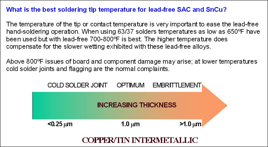

In a video, I have seen an American guy retailing all brands in a main soldering equipment company saying that the 900 can peak at 90W briefly even.
He was claiming that is why Metcal does not highlight the power spec because its dynamic. About temperature setting, the industry don't seem to refer in relation to power though. They talk solder wire and flux specific needs. It would just have to do with being quicker on the job when the power is excessive and/or using a finer tip I guess.
Lead-free Hand Soldering
