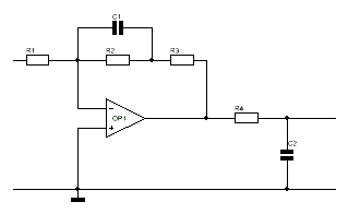

Hmmm... That looks like it would be a problem. Would that cause a droop in response >10kHz?
The other problem is that high value R2 is in series with the input, so whatever noise that resistor makes will be injected right at the front of the circuit. That's probably not a good idea either.

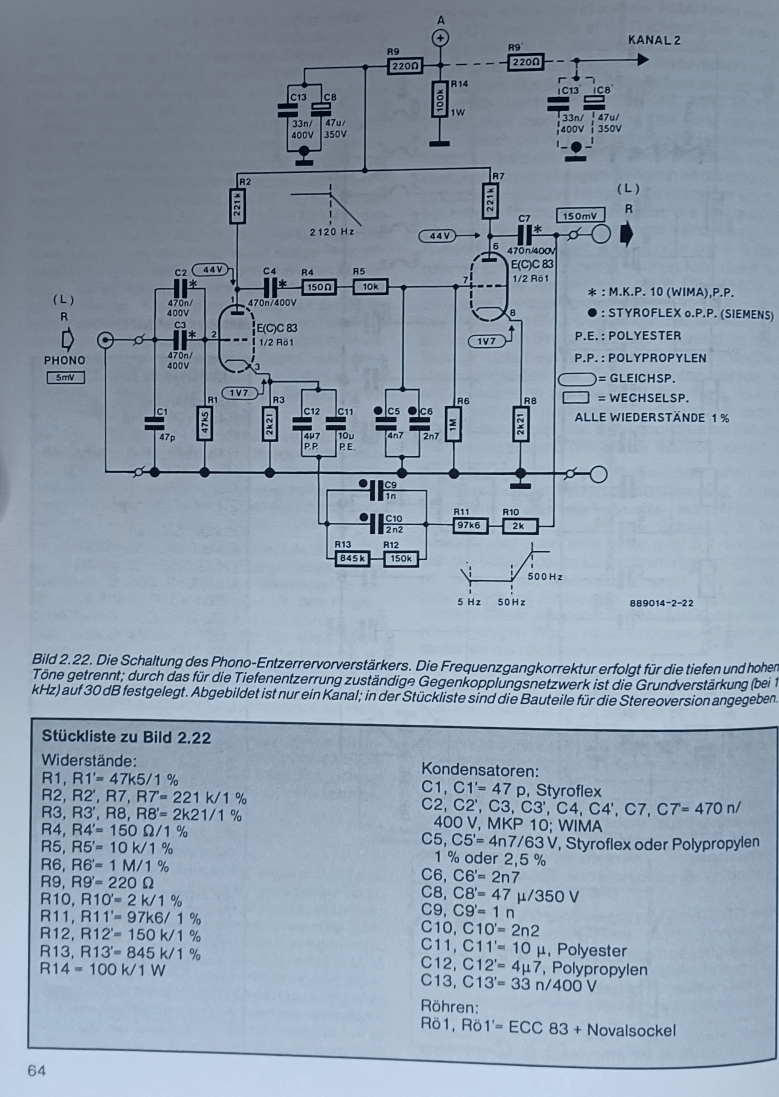

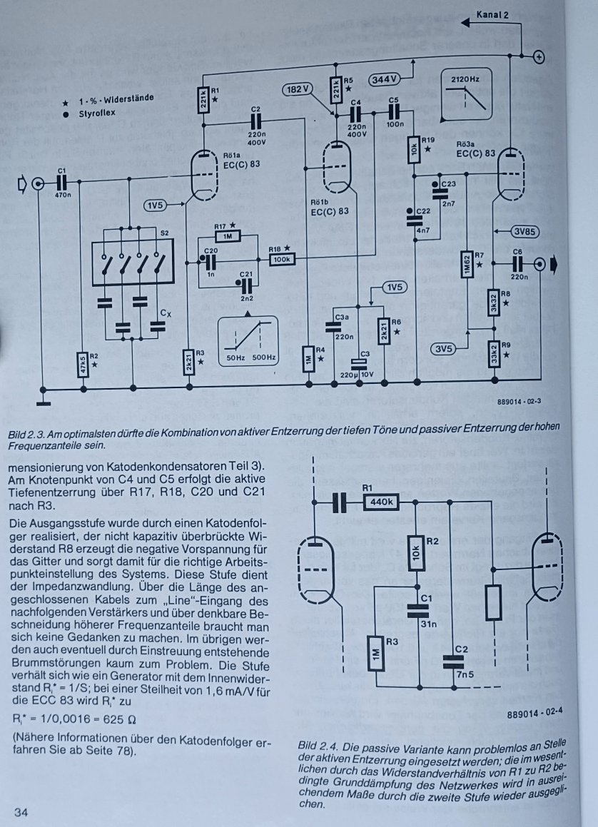

Here are a few examples from the old German book, maybe it will help you @rongon

These circuits are very different from what you described in post #1.
Sorry, I did simplify down to basic triode common cathode stages.

150k in series with the input is 50nV/√Hz, 47k is 28nV/√Hz, compared to the Johnson noise of a typical cartridge of 4nV/√Hz.
Basically "series resistance" and "preamplifier" don't sit well together!
You seem to assume a constant effective series resistance of about 1 kohm, but the ESR of a Shure V15-III increases from 1.85 kohm at 2 kHz to 30.1 kohm at 20 kHz, according to measurements of an acquaintance of mine. Anyway, a 47 kohm series resistor is indeed far from optimal for noise.
Reactions: Bonsai and hbtaudio
OK, thank you for bearing with me. Yes, I think this is not a good idea. The series resistance is a no-no for a low noise preamp. Also, the source resistance will mess with the gain inside the feedback loop. which is certainly not optimal. This type of thing is best done with op-amps, not tubes.
