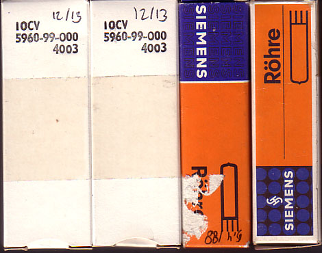

Hello all,
Got some Tungsram made SIEMENS label E80CC along some CV4003. Interchanged them in my phase splitter along with the Philips made CEI E80CC.
1. They have absolutely no problem playing there.
2. The E80CC is better there than any 12AU7 or equivalent (I have checked Rolls Royce grade as long as mundain ones)
3. The Philips is fuller, the Tungsram is clearer but drier.
4. They fit so nicely that the character of each E80CC is as clearly showing as any 12AU7.
5. They absolutely play a synergy game with surrounding valveware, their friends or foes manifest their feelings strongly.
Regards
Salas
