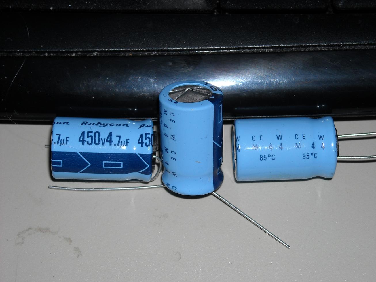

Speaking of Capacitors, does anyone know what this is?
I can't find a series number on them that is in any Rubycon data sheets.
Probably just their form of a generic 4.7uF 400V Al electrolytic.
