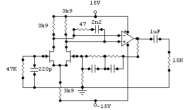

Topology shown below for Nch pair. ( for your 2SK146's mlloyd!)Flip cct for Pch FETs. RIAA as per standard (see Andy C's WWW).
jcx, It's arguable which is a better chip while surface noise is some 20dB+ higher as soon as the needle drops.

The 2SK146 (dual N fet I suggested because mlloyd has some) can be substituted with 2SK389 or a pair of 2SK170. The design I gave does not need selected GR,BL, or V grading just a pair the same - the duals are generally within 10%. For the 2SK170's, if they're not a perfect match then 22ohm or smaller emitter resistors should balance them up. If you want offset adjustment the op amp has this facility.
Hi Nuvistor,
I note your comments re the 5534 and your link and suggestion to cascode - but I like to use all that I've paid for rather than disable one stage. The discrete diff'lly loaded stage feeding , say, a 5534 front end should be fine despite it's unknown CMRR - it will cope to the error tolerance of the 3K9 source resistors.

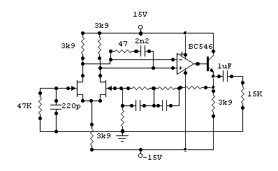

If you're wanting Class A output at 3mA see pic. Probably not so good as will limit negative swing unless made much higher Iq. especially when it comes to driving the hf low Z RIAA network - the 5534 would do better with just the pull down R to -Vs.
If you wanted all discrete the op amp could be replaced by a second diff'l stage with current mirror load then the Class A output.
5534 uses NPNs for output source/sink with feedback around the lower NPN, I've driven discrete output stages from 5534 comp pin 5, 5mA into this pin from V+ biases 5534's lower NPN on and also can bias a Vbe multiplier or diode string for class AB, with 2N4401/4403 you have a pretty good headphone driver, or just use pin 5 as output if no short circuit protection is OK. 5534 pin 5 is at lower NPN collector, sinks to negative rail, output pin 6 adds a diode and resistor. Sure it's a small step to a completely discrete op amp, but with IC op amps there's less to build and 5534 smoke is cheap. If 500uA 1st stage tail current is enough, 1st stage load resistors can be the 5534's internal 13k to V+. For inverting gain common-mode is not an issue and a simple resistive tail is OK, for non-inverting I would use an active current sink.
