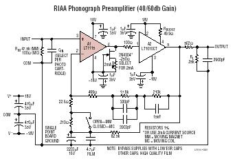

Thanks for the responses, the Zen Perl design looks elegant, and would save me having to create a PCB layout, as this is downloadable.
However, a quick search of the linear.com website for "RIAA" reveals a complete phono stage using the LT1115 opamp, and this looks pretty neat also.
I have attached the Linear schematic, incase anyone would like to comment. 'm leaning toward the LT1115 solution, (and if I do this, I'll publish the PCB to this group.)

a fundamental question is your phono cart type; mc (hi/lo output) or mm (again some range of source Z and output within the generic type)
mm really don't like bipolar input bias current in the coil, and Zsource is so high that "low noise" bipolars give higher noise due to input noise current - AD743/5 still the best low freq noise monolithic fet op amps I know of and will beat the LT1115/1028 on noise with high Z in
I think the single feedback loop RIAA implementation has the fewest compromizes, but many single op amps can have marginal loop gain if you need a high preamp gain (mc) - if you are adventurous I would put 2 op amps with V gain inside the RIAA feedback loop (I would probably use a high speed current feedback dsl driver as the output op amp - and remember; composite amp frequency compensation is fun)

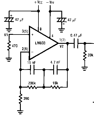

There is one near back of the following datasheet:
http://cache.national.com/ds/LM/LM833.pdf
It has the virtue of simplicity, i.e., you use a single opamp per channel or even use a dual for both. This is almost a generic design, both Slone and JLH show versions of it (just different RC combinations) in their books. I've seen it in other places as well. It's probably too prosaic to have audiophile status, but when I listened to one it seemed to do the job as well as the upscale designs. However, I'm one who never regreted the demise of the LP - so I'm probably not qualified to opine.
Nonetheless, since it can be constructed on a breadboard in a few minutes it can be used as a minimum performance baseline. Namely, any alternative design that does not sound at least a little better probably isn't worth pursuing. The judgement as to what sounds better I'll leave up to those more into to vinyl than I am.

Simple's always a good place to start. The LM833 cct below as lifted from the link provided is close. only with the newer single op amps like LT1028, etc...
A couple of improvements though , if you're doing a board. A series R should be added between the RIAA network and the output feedback point. This can serve two finctions - low Z loading limiter (as the RIAA > 0 at hf) ans cutting lathe 50KHz zero provision.
When selecting the actual component values (recomment Andy C's website) or scaling the values shown, consider increasing the LF time constant considerably by increasing the 200K -> 300K for a fuller low bass consistent with a lack of 20Hz break in ther recording eq.
jcx,
The LT1028 has input stage bias cancellation so DC bias currents through the cartridge are likely acadaemic? Also the high Z source impedance source impedance you speak of , that would more suit a FET op amp, is dubious as the typical MM cartridge is usually characterised as , IK in series with 600mH and most audible nois according to Fletcher Munson is in the 500-3KHz range where source impedance is typ 2K-7Kohm. Also the RIAA eq at hf tends to further supress hf contribution. I vaguely recall NS doing an octave by octave analysis.
But I have to agree with your -
"..... if you are adventurous I would put 2 op amps with V gain inside the RIAA feedback loop (I would probably use a high speed current feedback dsl driver as the output op amp - and remember; composite amp frequency compensation is fun)"
I would suggest a discrete FET diff'l pair followed by a high speed high drive op amp in one loop (all as the op amp pictured) with tailoring of the diff'l pair back to unity at hf for stability. Simple and effective AND fun!

check out the lt1028 i_noise spec, 1 pA/sqrt(hz) * 2-7 KOhms is 2-7 nV/sqrt(hz) right in your peak sensitivity region, the ad743 2.5-3 nV/sqrt(hz) V_noise is a bargan, clearly beating the lt1028 with mm cart
low freq 1/f noise could be a problem with other fet input op amps with the riaa Lf boost largely canceling the A weighting noise Lf roll off - the ad743 keeps the 1/f Vnoise corner lower than any other fet input op amp I know of

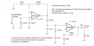

Just came across a schematic using two opamps sandwiching a passive filter (attached below). Walter Jung describes the technique in his paper "Topology Considerations for RIAA Phono Preamplifiers" which you can download from his website.
At the moment, this passive filter design is favorite, any comments from the experts? [ before I waste more time...
I don't have any favored theory whether active or passsive will sound better. andy_c's paper is impressive and there is a certain elegance into wrapping the whole thing neatly around a asingle opamp. However, being that I'm grey-mattert-limited, I find the passive approach easier to comprehend as it lets me think about just one thing at a time.
