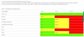

I am convinced that the real reason behind lead free solder isn’t reduction of lead in the environment, but rather cynical planned obsolescence. Note that non-consumer electronics have no issues whatsoever with leaded solder.
I guess that the general idea is lifecycle management: reduce environamental impact of electronic waste by discuraging mass manufacturing of subassemblies that contains harmful or hard to recycle materials and exceeds the planned life of the complete product. Planned obsolescence is done more effectively by software means on today connected devices, there is not a compelling need to introduce weak points on the hardware for this purpose. After accepting the concept that consumer devices life has been planned, there is no need to build devices like they will last forever. Early professional personal computers and minicomputers were built to last decades, but have been trashed only after a few years of use because they were unable to run the upgraded software. A colossal waste of good resources. Today devices will not last any longer, but at least they have been built with cheaper and less harmful matherials.
Never had a dry joint with leaded solder?
I have been using Pb/Sn solder, since I was about 6-7 years old, now at 67 I wonder if the lead affected my early development & will never know. Apparently there are a lot of symptoms of lead poisoning: Lead poisoning - Symptoms and causes - Mayo Clinic
Apparently diets that that include enough; Vitamin C, Calcium, Iron, Zinc & Phosphorus help with reducing Pb absorption.
We had a major effort at work over the last 20 years to provide reliable Pb free packages & there were lots of issues with Sn whiskers. We also had a lot of issues with Cu dendrites (Au flashing can fix this but is expensive) growing during burn in life tests. It seems the EU has requirement for Pb free products; Packaging Waste Directive - Heavy Metals Concentration Level - heavy-metals-packaging-waste - ECHA
The power products that use Pb solder die attach were also a problem for customers wanting to eliminate lead. Regular Pb solder die attach is much more reliable with less voids (for high power dissipation applications) than alternatives. Some applications have moved to sintered Ag-Glass die attach, which cheaper than Au eutectic die attach.
