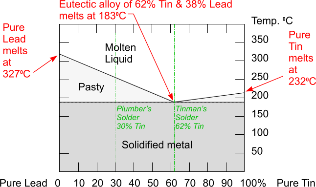

The reason why there is lead in the solder in the first place:... it was later found that the addition of lead to tin solder provided mitigation....
Wiki has it backward.
Solder had Lead long before any telephone was made. Like 5,000 years ago.
Pure Tin is very expensive and hard to melt. Pure Lead is not too expensive but still hard to melt. Alloys (generally!) have lower melting point than either metal alone. Since Tin is often found mixed with Lead, a Tin/Lead mix was used for jewelry, cookware, sword fittings, glassware, etc.
Temperature behaviors are like this. You don't want pasty behavior, so use eutectic solder.
