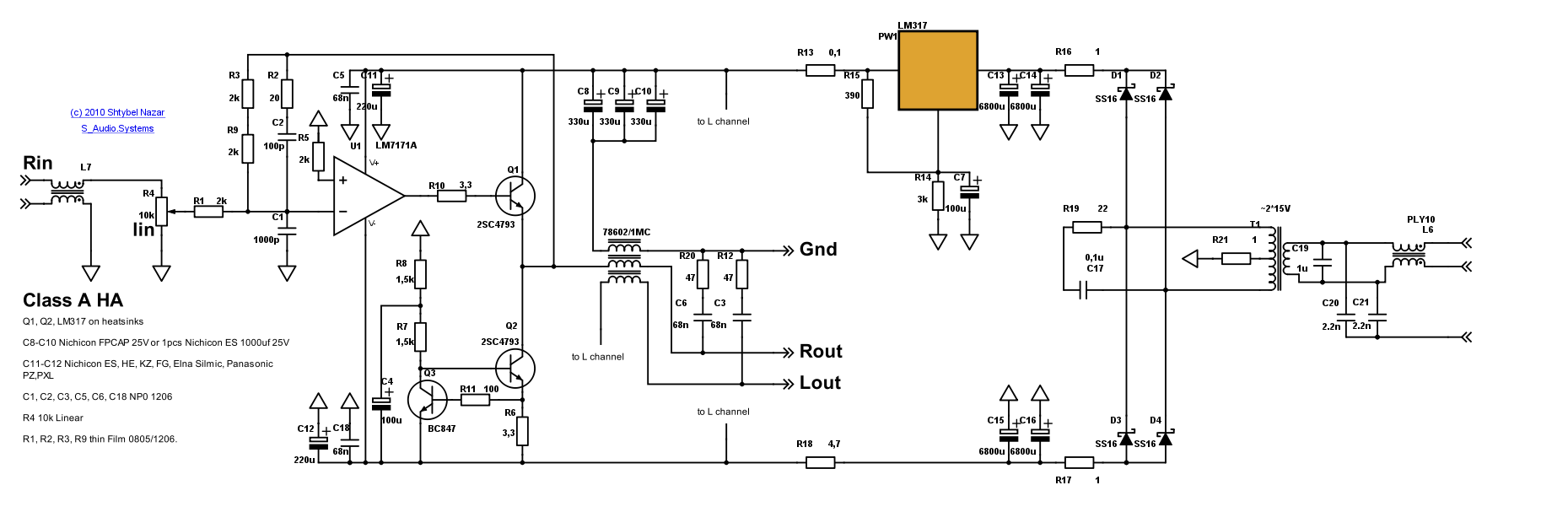

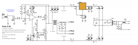

Perhaps this project will be of interest to you. Real class A headamp.
Simple and with excellent repeatability headphone amplifier by Project "Pyetsik" from Shtybel Nazar

Alex, the Kevin Gilmore design you linked does not have a MOSFET output stage.
Output stage is a symmetric quartet of parallelly connected emitter followers Q7-Q10 and Q13-Q16. It has gain 0.9 and idle current about 15mA per transistor with power supply +/- 16V. It makes transistors relatively hot but not too much for need of heatsink.
It uses small signal bipolar transistors in quadruple parallel to support a 60 mA total idle current. It may not be in Class A except with high impedance headphone. It does have a JFET input stage.
The use of small signal bi-polar is unique. The author did not explain its advantage other than they don't need a heatsink.
